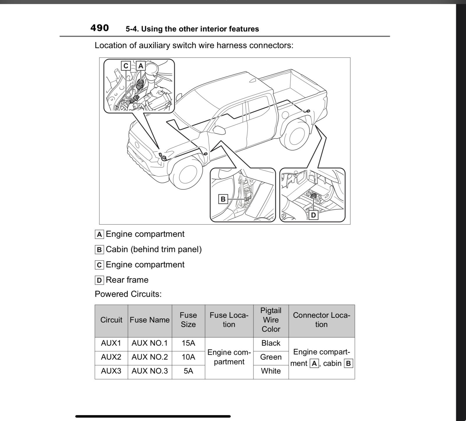

    Hello, how would roof lights be wired to aux switches that come with Tacoma. Can they be wired to the in rear frame and how would you route the wiring?

    I dunno what you mean. The rear frame? Are you talking the chassis?
    Anywho, you'd best run the lights through a relay switch first and then back to an Aux switch.

    I’m not entirely clear if it is the frame or chassis as just going by this which also would suggest there is no relay. New to this.

    You need to add a relay switch. Youtube it. They aren't expensive.
    I did it for my lightbar on my 2016. The aux switch turns the relay on which is wired to the power source. That little aux switch probably doesn't have the wiring capable of what you are trying to do.
