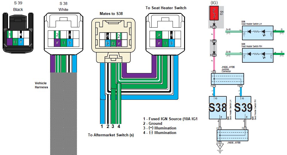

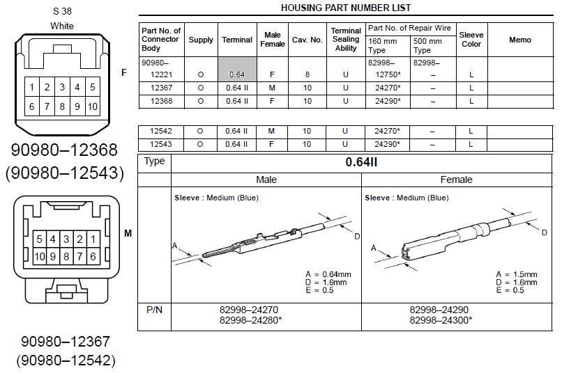

    OP, in another switch cap there should the other seat heater connector, a white 10 slot one... for that one we have this:
    You could get parts and build a harness so you don't cut anything and still have one wire leaving the cab to actuate the relay. It's probably way too much...even build a 3 way harness and still add factory seat heaters to the connectors you have.

    Like so...

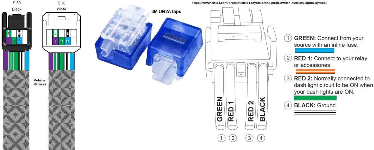

    But here is a simpler manner:
    Orange is your wire to the engine bay to actuate the relay for the lights.
