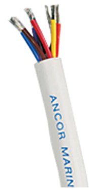

    Make your own switch panel. You're already using boat hardware.
    Look into these switches:
    20awg wires 8 of them in one bundle.
