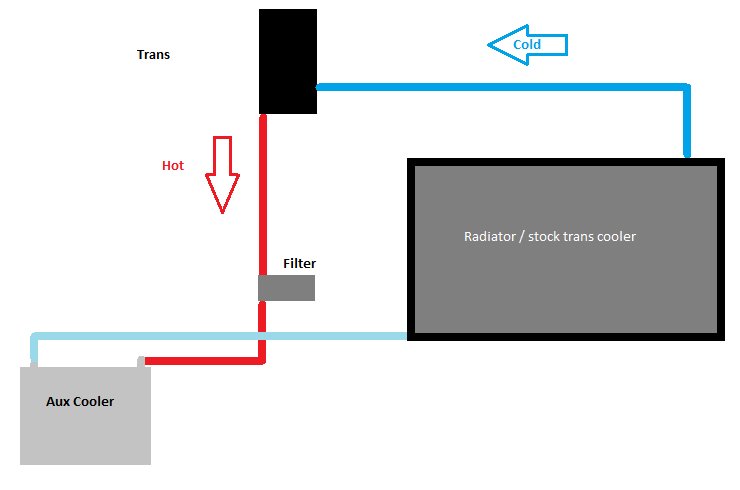

    Plan:

    I think you want the aux cooler after the stock cooler.

    nothing wrong with it, im my experence its the best way besides getting rid of the rad cooler alltogether. but then you want it there to get the trans up to temp quicker in the winter.
    If the extrenal cooler is cooling below engine temp the flow through the rad cooler will heat the oil back up. not really what you want.

    In hotter climates, maybe. I like to keep the stock cooler after the aux for winter so it doesn't overcool and comes up to operating temp quicker.
    Since it won't be exposed to the stock cooling fans and mostly rely on the included fan, I could probably get away with both configurations but I feel more comfortable with it in this configuration.
