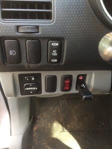

  17. Mar 22, 2017 at 1:16 PM
    #17
    mikaymusic
    mikaymusic [OP] Well-Known Member
    Mar 10, 2017
    #212883
    114
    07 Tacoma 4x4 SR5 TRD
    And as a final note, the jack that I ordered came today, so everything has been connected, the connections taped together and wires tucked under dash and wire-tied securely. Here's what it looks like:IMG_0724[1].jpg
