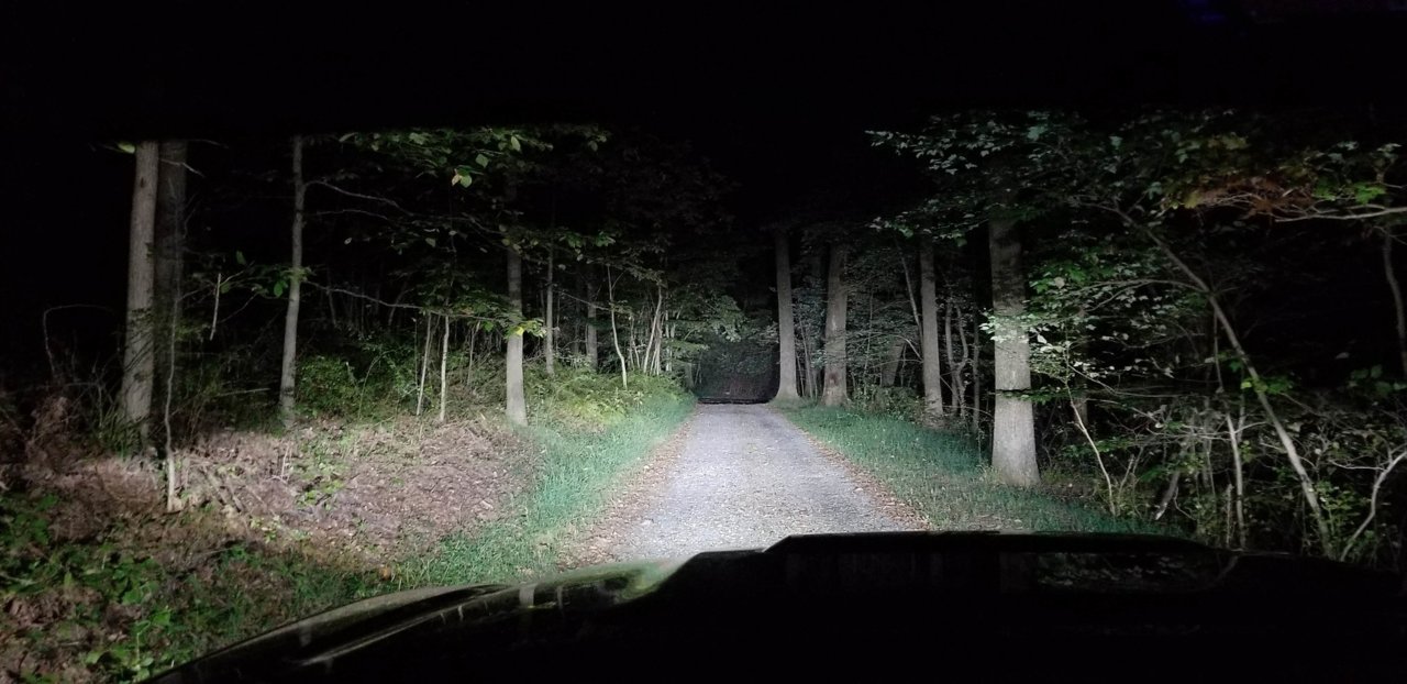

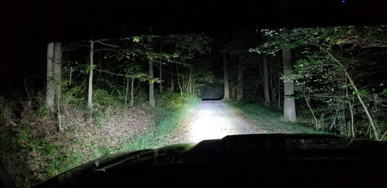

    First, I tested behind my house on the wooded lane that runs back to the farm. This shot is of the fog lights and low beams only for reference. Not bad.
    This next shot is the low beams and high beams. The fogs turn off by default. Things are definitely more visible.

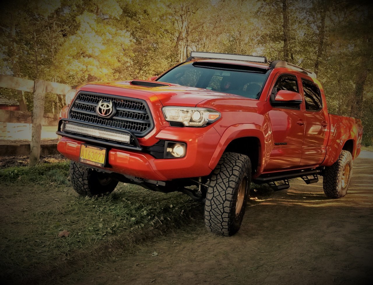

    Next is the Lows, Highs and 32" Bumper Mounted Auxbeam. Notice how the light bar illuminates the sides of the woods there on the left really well.
    (note, if you only had a 32" on the bumper I think you could adjust it higher for more throw but as you will see in the photo, I don't have to)

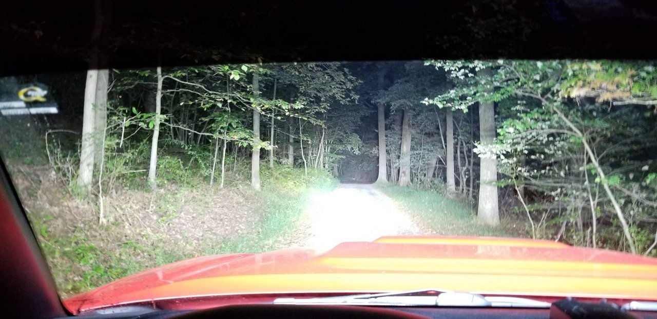

    Next is the Lows, Highs, 32" Auxbeam Bumper Mounted Light Bar and the 42" Auxbeam Roof Mounted Light Bar (these photos are only resized, not retouched)
    The freaking lights are incredible in confined spaces. I got out of the truck and checked the surroundings. It was like daylight.
    I have no doubt that if you had either of these light bars mounted on your truck and went wheeling at night you would not have any trouble seeing where you were going. If you had them both mounted on the truck, and were with other people, you had better be the lead truck! Together they are insanely bright and illuminate every part of the trail.

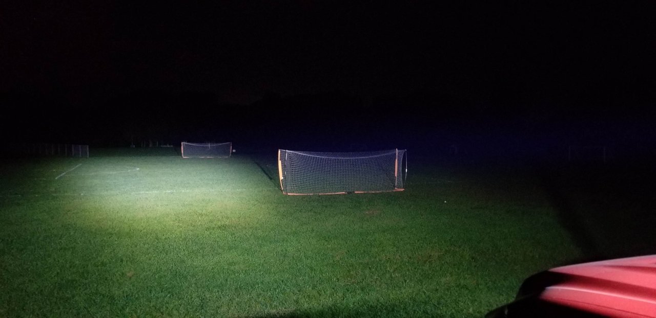

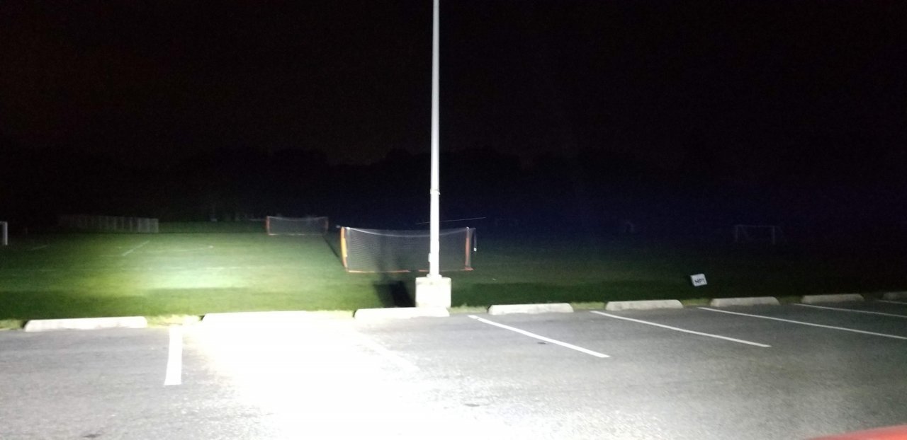

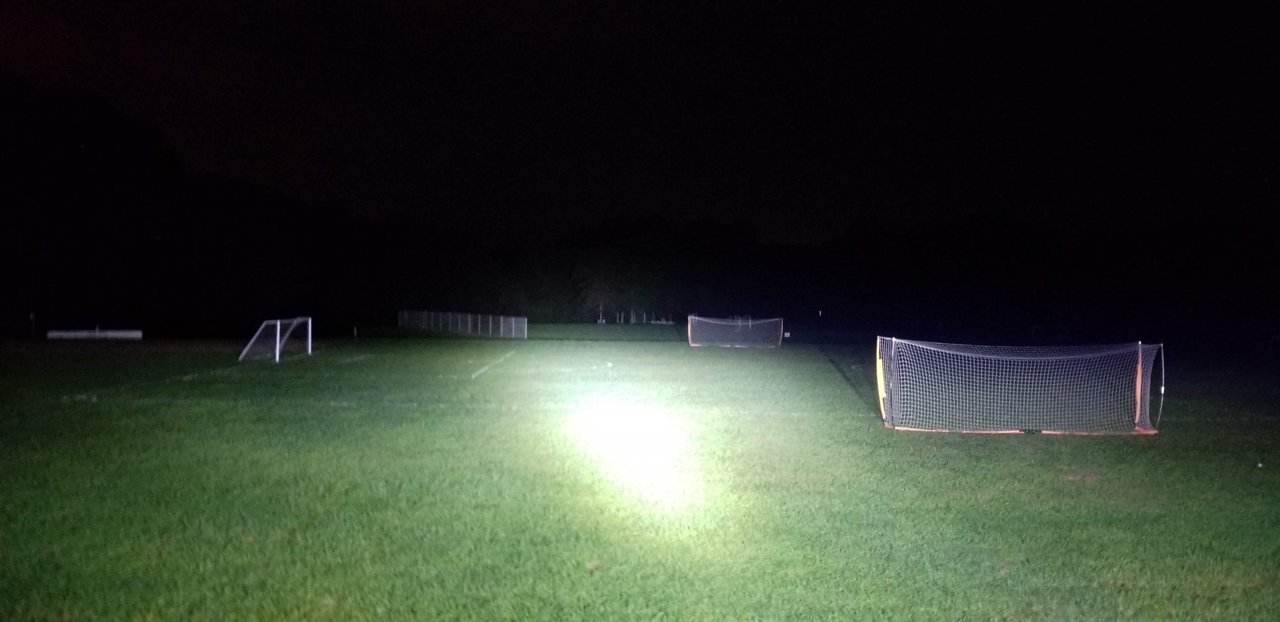

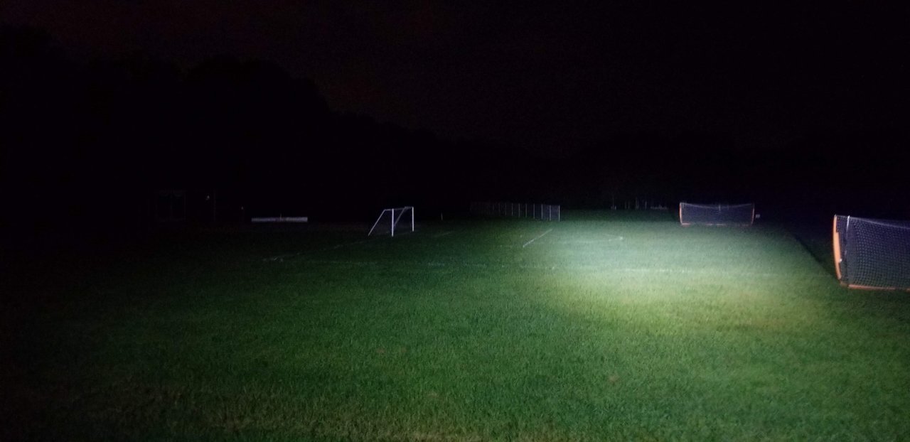

    I wanted to see how they would do out in the open. The only non-private place near me is a youth multi-use athletic field. For reference here is a birds eye view with the dimensions of the area. I stayed in the parking lot.
    As you can see in the following pics the lights had no problem illuminating the area. In the first series of shots I'm sitting right at the edge of the field and there is a rather wide and deep drainage ditch that is directly in front of me about 15' away. Also, the parking lot is elevated about 10' - 15' higher than the field. I think this is good because it sort of represents what it would be like cresting a hill/drop on a trail.

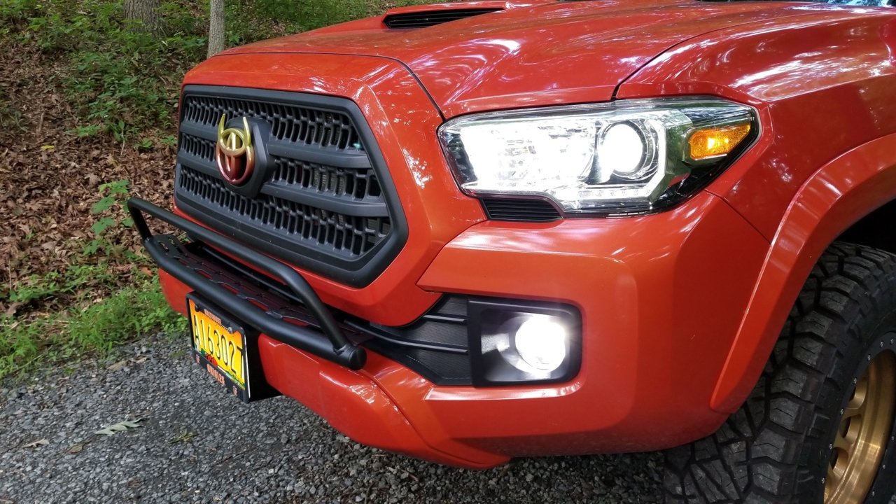

    First for reference again, this time, just the low beams. I wanted to remove the Fog Lights from the equation. Not everyone has them. Pay special attention to the foreground to the left and the lack of illumination, especially farther way.
    Now let's look at the Low Beams with just the 32" Auxbeam Bumper Mounted Light Bar. Again, pay special attention to the left foreground. The spread is impressive for a a straight bar. In retrospect, I wish I had gone with the 32" Curved bar.
    Now the Low Beams and High Beams, again, no Fog Lights. Not bad, you can just barely make out those trees 1,000' away. You can see the 1st base line fence of the field farthest away there to the right of the white lacrosse goal. It's better.
    Next is the Lows, Highs, 32" Auxbeam Bumper Mounted Light Bar and the 42" Auxbeam Roof Mounted Light Bar (again, these photos are only resized, not retouched). If you look close at the trees at the far edge of the field, again, 1,000' away you can now actually make out where the limbs and branches begin and not just the trunks. There is also a structure (not sure what it is but it could be another fence) on the far left. I shot this one from outside the truck.

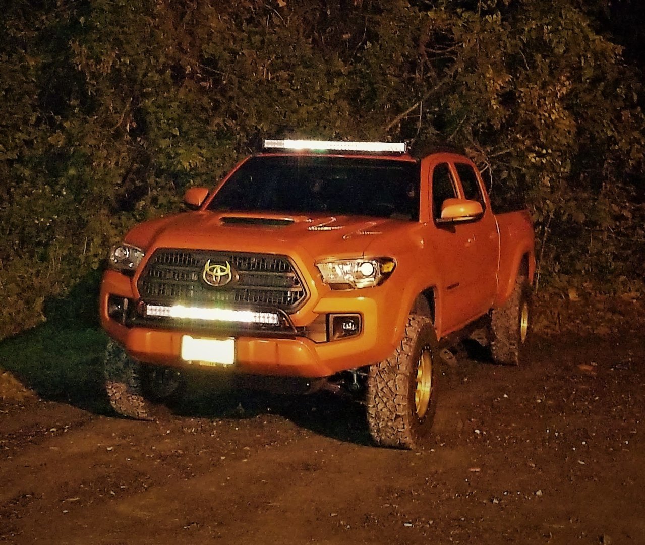

    So those are the output pics and you can see for yourself these light bars offer an incredible amount of light. The cost in my book makes them an excellent choice for the money. Do I recommend them? Yes, absolutely! They are heavy, well built and the construction is top notch. They arrived well packed and protected and all the parts were there. I have nothing to compare them to personally but these light bars are the real deal. I checked out all the LEDs and they are all uniform and the lens was crystal clear.
    There is one Con but I can live with it. The roof mounted light bar is a little noisy. It reverberates at medium speeds and is louder at higher speeds obviously. I learned this is common to light bars mounted on the roof. I think it would help if I had a better mounting system and it wasn't just sticking out like that. Eventually I am going to get a Prinsu with the deflector and mount it to that. I think that would help immensely. Some will say the shots that the hood is illuminated is also a Con. I have heard this said before. I don't have a problem at all. Yes, the hood is illuminated but it doesn't invade the cab. It has no effect on my eyes. Others may not like it. They make a light bar shield that attaches to light bars and eliminates it. Mounting it farther back on a Prinsu or another roof rack with a deflector would also eliminate it. Again, I think if you are off road and moving slow and concentrating on the path in front of you that is not going to be an issue. My guess is, white, tan, silver or even red will illuminate, and darker colors will not as much. Again, it doesn't bother me at all. You could be very different in this regard though. Again, if you are in the market for light bars, and you want to keep some green in your pocket, look at Auxbeam products. Definitely look at either of these two light bars, or both. :thumbsup:
    I do use them all the time up here in the country to help me see if deer are moving close to the road. It really lights up their eyes. This is just the two light bars. I turned my truck lights off. Look at the sign and guardrail reflectors over 300 yards away. Yikes.

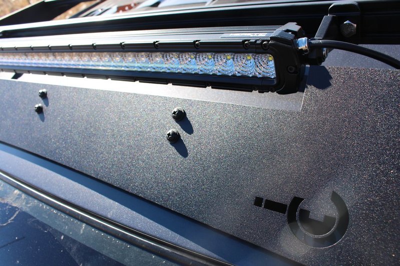

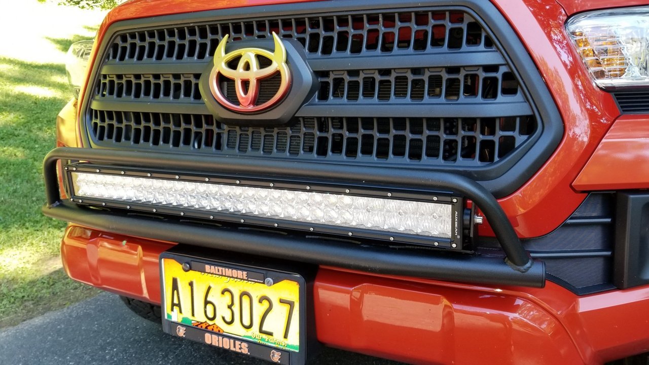

    These light bars are not plug-n-play and you will have to wire the switches to the lights, you will have to penetrate the firewall grommet to get into the cab and you will have to run the wires from the light bars to the included harness, which come complete with fuses and relays. I used weatherproof quick disconnect automotive style connectors at each light in the event I wanted to remove them for whatever reason. I soldered, and shrink wrapped everything. I got real anal and wire loomed everything as well. I installed the roof light and did the wiring for both light bars all in one day. This was my first time doing something like this and the install looks like a pro did it so I am proud I pulled this off.
    For the 32" Auxbeam Light Bar I used the N-Fab O.R. Pre-Runner Light Bar
    https://n-fab.com/or-pre-runner-light-bar/2017/toyota/tacoma

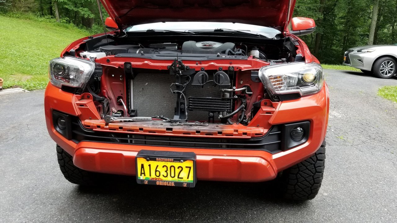

    I bought it from 4Wheel Parts. Installation was straight forward but I had to contact N-Fab to have them send the light bar L shaped brackets that attach the light bar to the mounting system. They shipped them free and apparently they are use to these requests.
    Here are a couple shots of that process. Naturally you have to remove the grill. I also had to cut the lower grill to allow the mounting brackets to attach to the bumper support points. Once installed though the Light Bar Mounting System is rock solid. I am not a fan of the fitment of some of the drilled holes and plan on making tweaks to them. I think the light bar is crooked and it causes the light pattern to be off a little to the left. It's clearly not mounted straight. But it's so close I decided to deal with it for now.
    This took me the better part of the day to install. It was all new to me so I struggled a little with the brackets. I like the results though. I am very happy with it and how the Light Bar performs here.
    I'd like to shout out to @smugly for the inspiration for the N-Fab Light Bar Mounting System I decided to use for the 32” Light Bar.

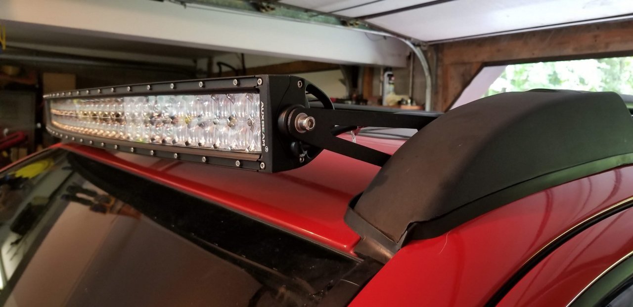

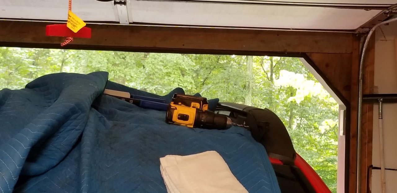

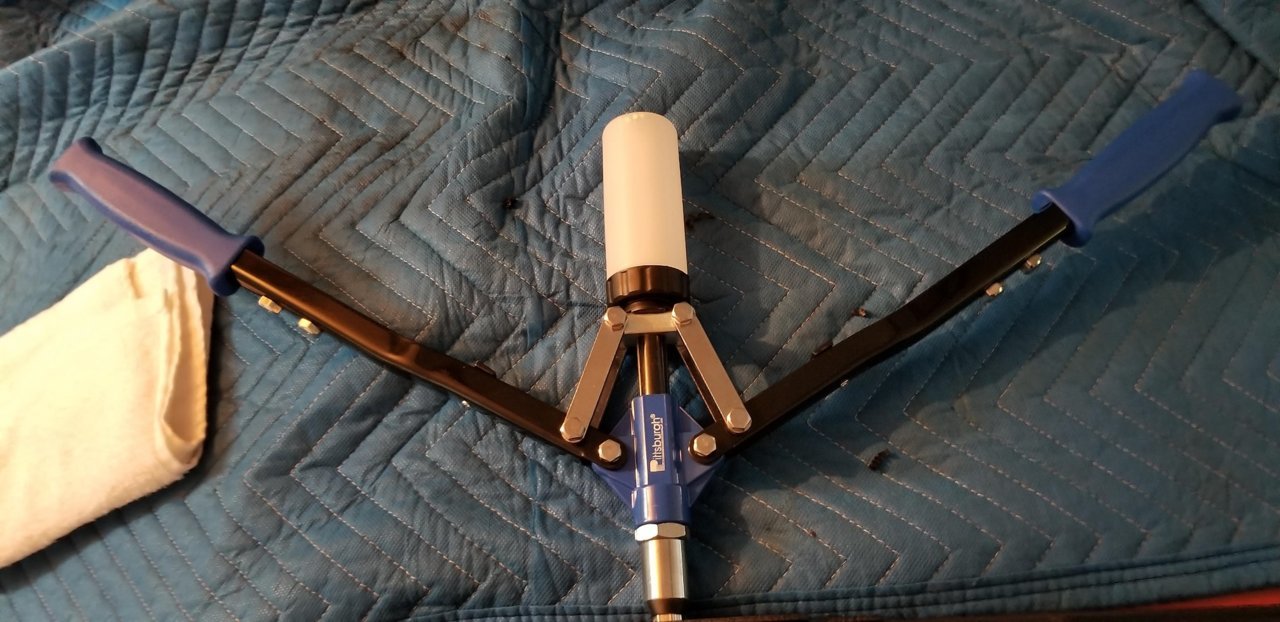

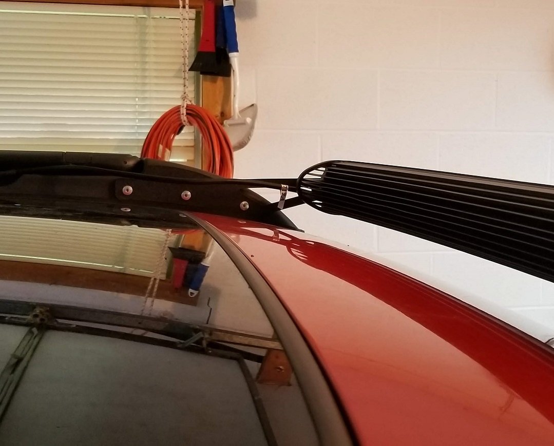

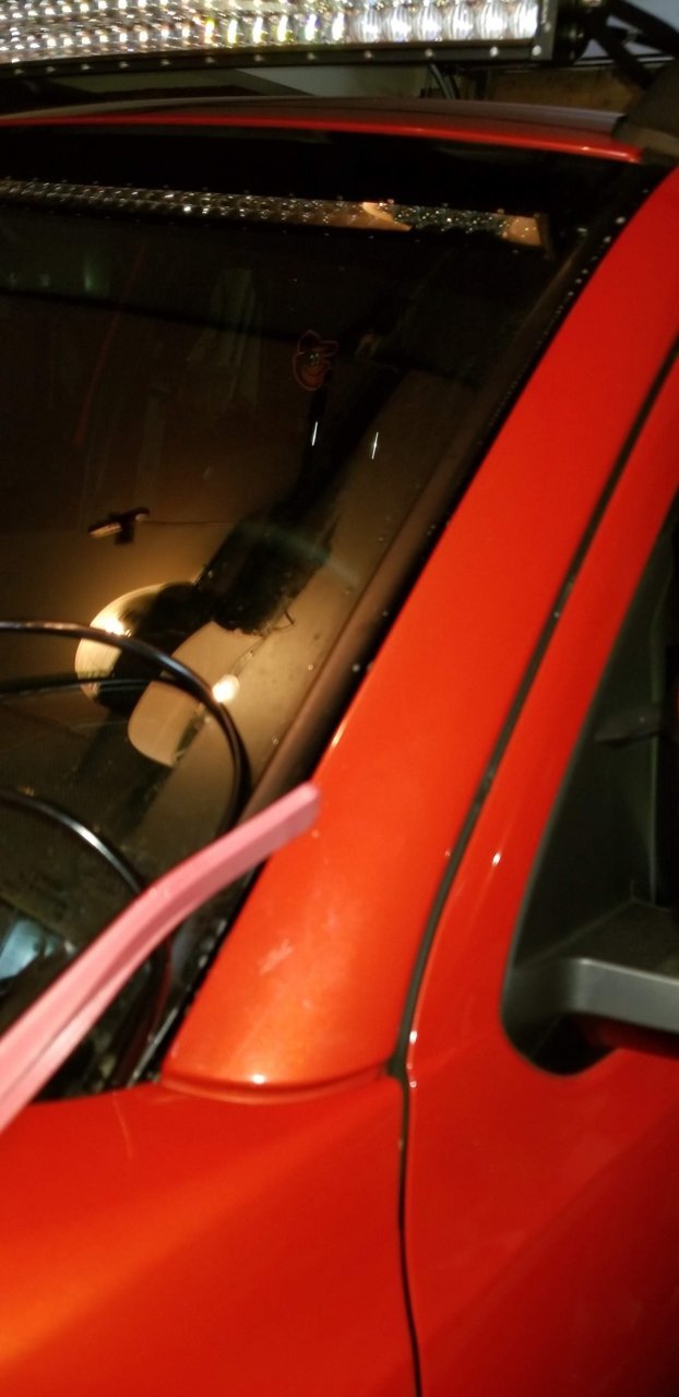

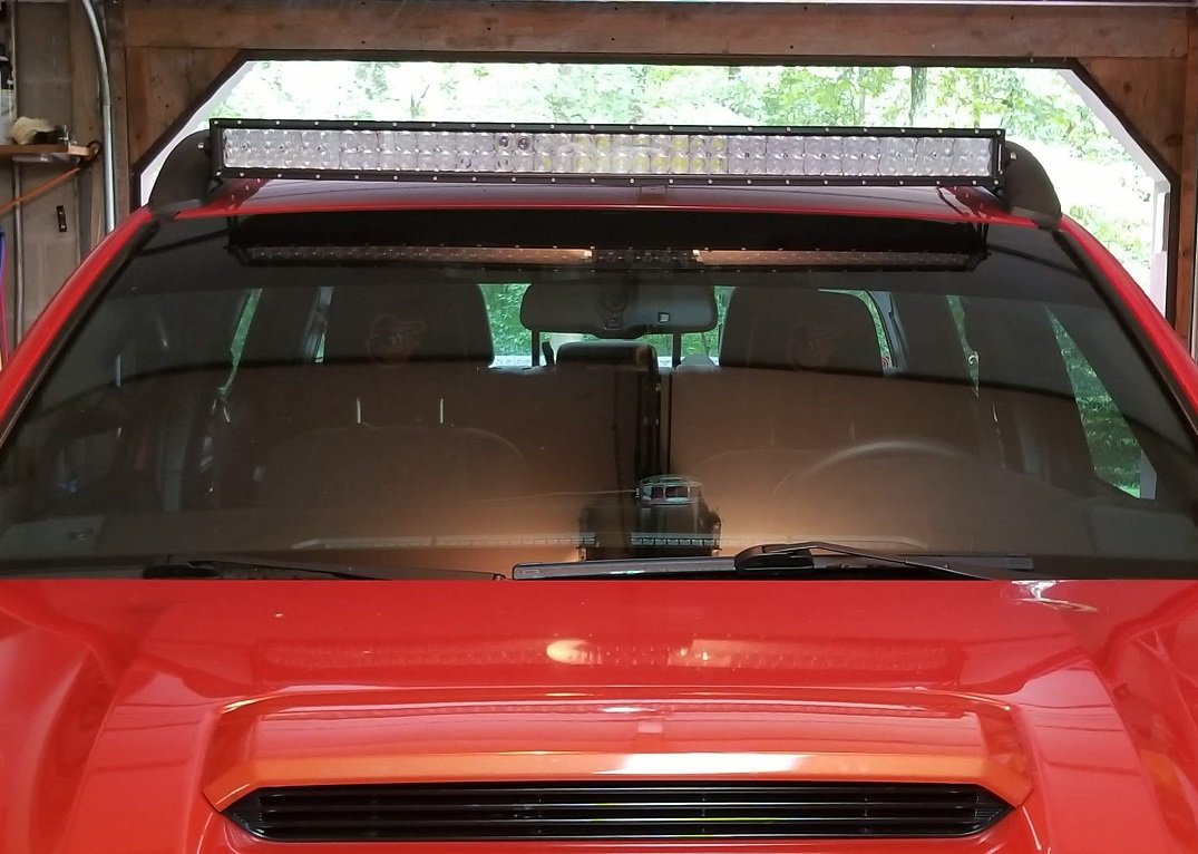

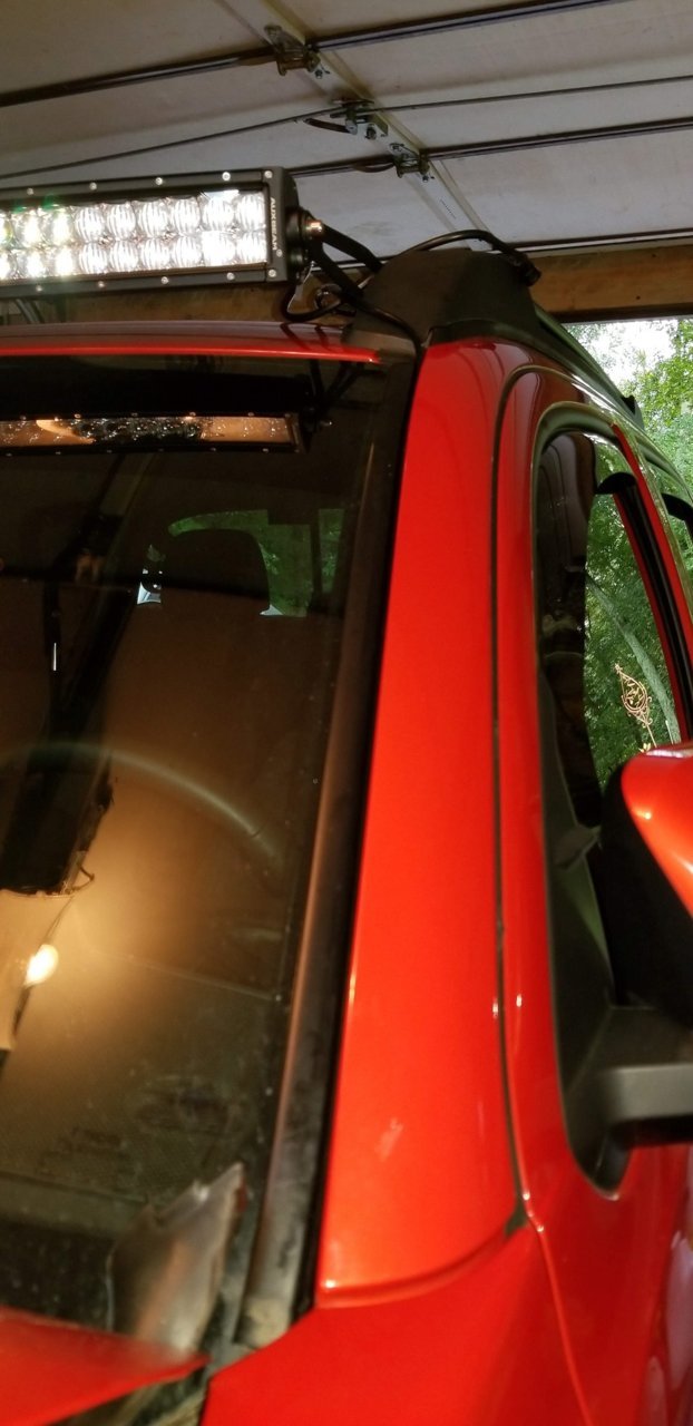

    The roof Light Bar was about the same skill level and amount of time. There are various bracket you can buy but believe me when I say you do not have to spend a lot of money. Here is what I have:
    https://www.amazon.com/gp/product/B01LPR5VQO/ref=oh_aui_detailpage_o08_s00?ie=UTF8&psc=1
    These are heavy brackets that came with the rivets needed to attach them to the OEM roof rack. I am glad I had the Harbor Freight Heavy Duty rivet gun though.
    All the mounting hardware that comes with the light bars is SS and it even comes with an allen wrench to install it. I suggest you use Loc Tite on the bolts.

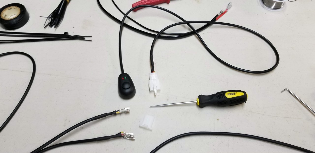

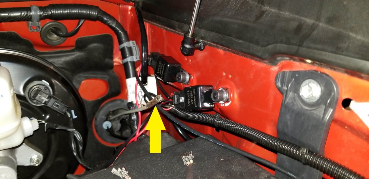

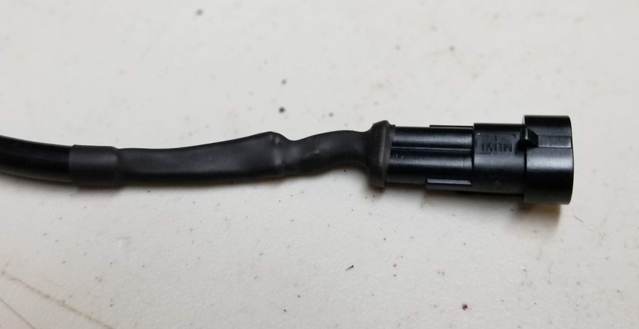

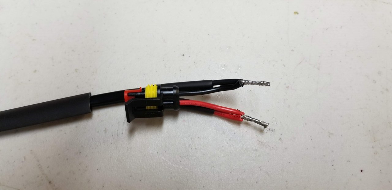

    Here are some of the wiring shots.
    My first ever solder!
    The connector completed.

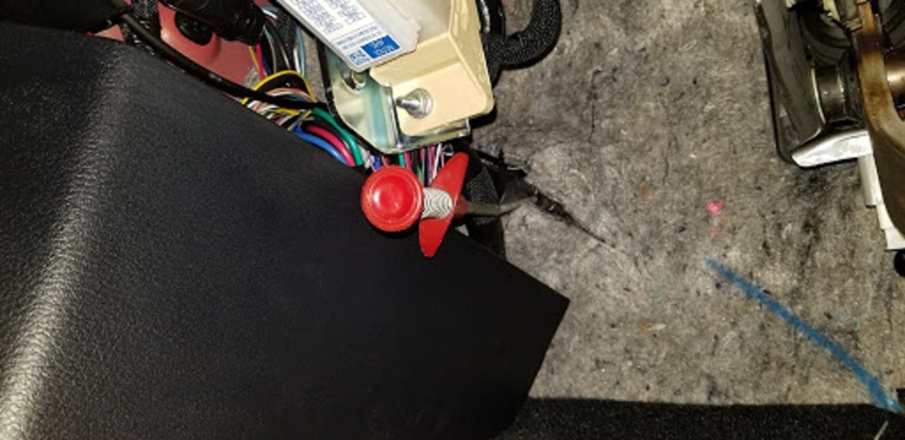

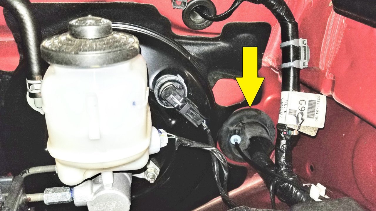

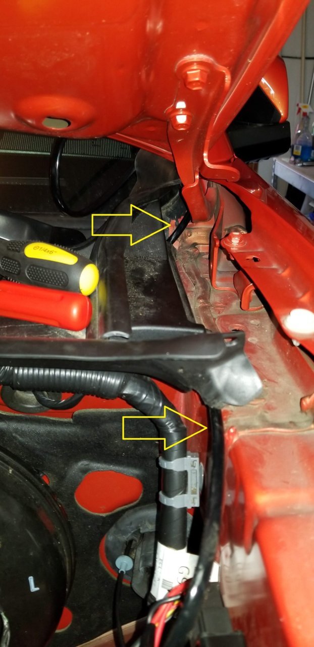

    I ran the wire for the roof mounted light bar under the trim at the cowl from the engine bay and right between the windshield trim and the A pillar. I just used some car wash to lube it up (because I knew that would not harm the paint) and I used a automotive trim removal tool to push it in the groove. It's completely hidden except at the top.
    Here is the grommet I went through. I searched for a better spot but this was it. I used an exacto knife to punch a slit in it and then I used a flexible automotive retrieval tool. My wiring fish tape was just too stout and too big. This worked perfectly. If I had had some coat hanger that would have worked too.
    Here's the flexible grabber from the inside of the cab:
    Then to get the wiring into the cab, I had to take the quick disconnect apart on the harness. I used a straight wiring pick to gently release the wire connectors from the plastic housing. I had seen this done before. I just had to make a note of how they went back together.

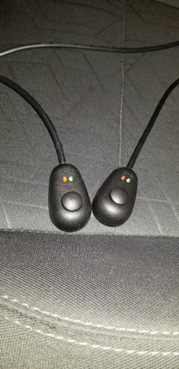

    Then I tested my connections and wiring to be sure I didn't have any shorts and the switches were wired correctly.
    Once I had the switch connectors dissected, I could tape them to the flexible tool and pull them into the cab. Then I reassembled the connectors and tested everything. You can see how the included switches have Red Power indicator light and a Green On light. Nice touch.
    I used wire management clips to mount the switches (which have double sided tape on the backs of them) to where I though they would be easily accessible.
    Ultimately I am buying a OEM switch to go into this panel and will throw both light bars onto that one switch. I feel like I will never want to use one light bar without the other. At least that has been my experience so far.

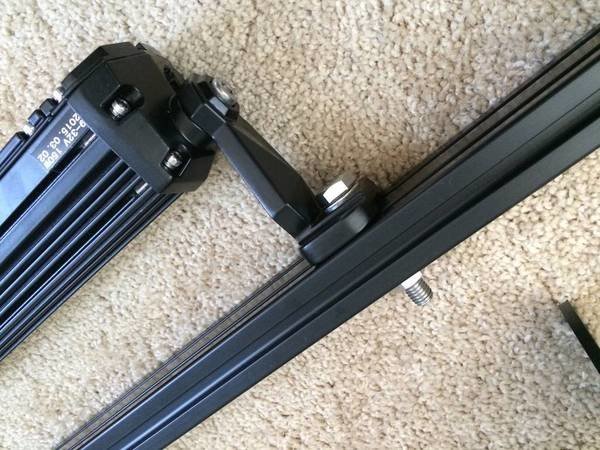

    Will curved light bars fit on prinsu racks? All I have ever seen used is straight. Would be awesome if they worked with the deflector.

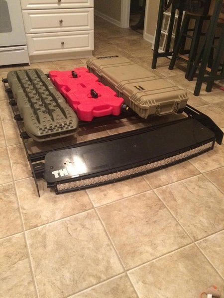

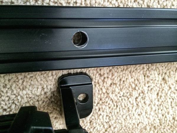

    I sent Prinsu a email asking them precisely if a 42" curved light bar would work with a deflector. I said I understood it would not be a perfect fit but just wanted to confirm it was possible. I'll post their response when I receive and add it to this post.
    In the meantime I did a quick search and found these photos.
    In the photo above you can see with the Prinsu supplied light bar brackets, they push the straight light bar away from the deflector and there is actually a large gap. I think my curved light bar would likely still be behind the deflector using these brackets. Or at the very least, even with it in the middle.
    I found these pics too.
    These three photos above show how the standard light bar included brackets (these come with the Auxbeam light bars) can be attached to one of the Prinsu cross bars. Then the cross bar can be mounted to the side rails at virtually any point along the side rails fore/aft to provide a custom fit. This is likely how I would do it. Or I could also remove the brackets attached to my OEM roof rack and use those.
    Finally, here is an option that is possible.
    This might not be as aerodynamic/quiet as the light bar behind the deflector. However (besides it saying Thule) this is a very clean look that frees up more room on the rack. With the extra length of a double cab it's not as critical though, but we all know, more is more.
    Thanks again! I like being made to think :thumbsup:
