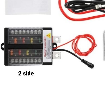

    Not to bring up an old/resolved thread, but I’m curious what the difference is between the one sided and two sided models of this switch panel. Anyone know? I’m just not sure what that’s referring to and I can’t see anywhere that the company mentions what that means.

    In the picture is the only difference I believe.

    So basically the leads just come out one side versus both?

    Yes from what I can see. That's the only difference between the 2.

    When I ordered mine, I looked at both. I decided that the two sided fuse panel was probably a better solution because it seemed like the wiring would be less cramped. I'd rather have 4 wire pairs coming from each side rather than trying to neatly organize 8 wire pairs all on one side.
    Either way, you'll be happy with either. The quality is great, and it's way better than I expected for a discount panel and fuse block.

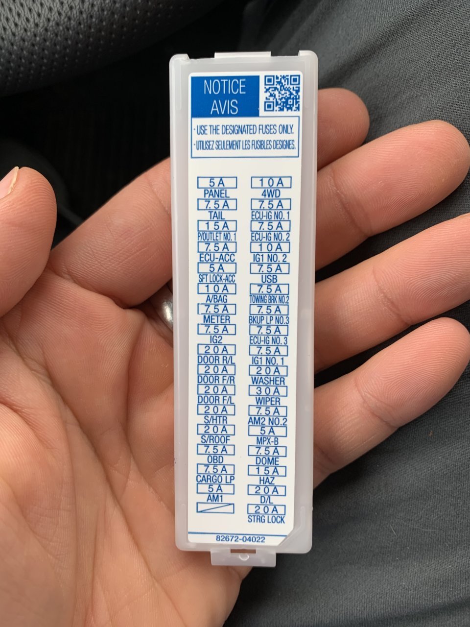

    Use the P/OUTLET fuse. It runs the power outlet and isn't tied into anything that will cause problems. It's hot in ACC and ON.
