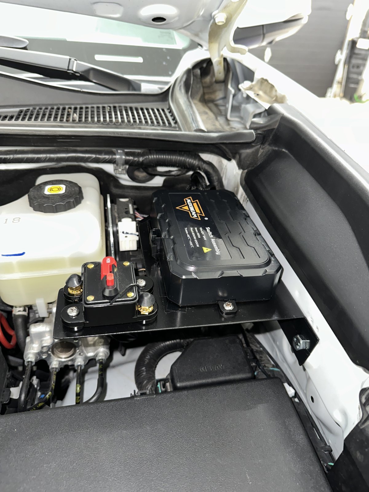

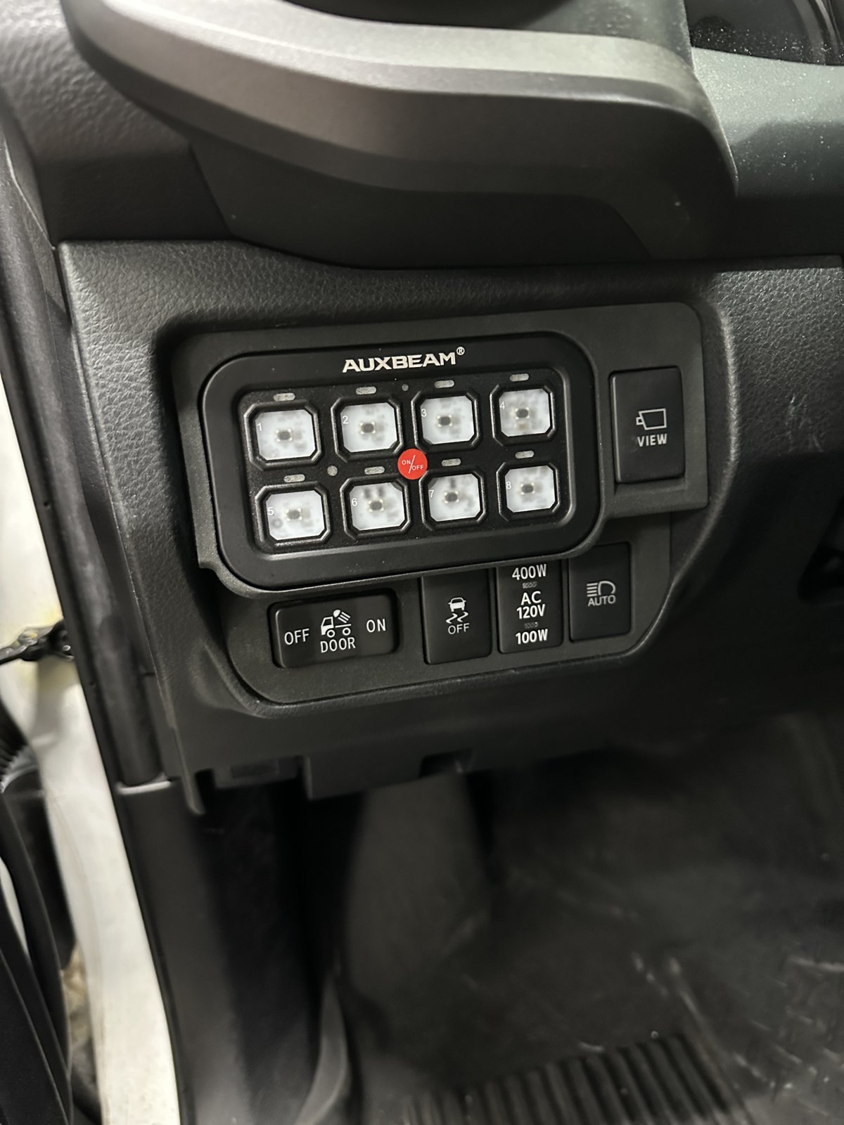

    Picked up the Guild Outfitters base switch panel for Auxbeam. Also custom made a bracket to hold the Auxbeam and breaker in the engine bay.

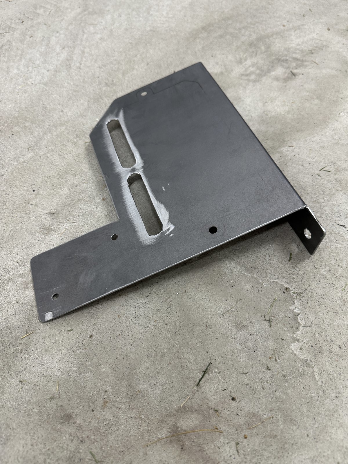

    The radius' at the end of the slots will be easier with one of these:

    It’s solid, especially when mounted to the factory holes. it’s 16ga steel I believe

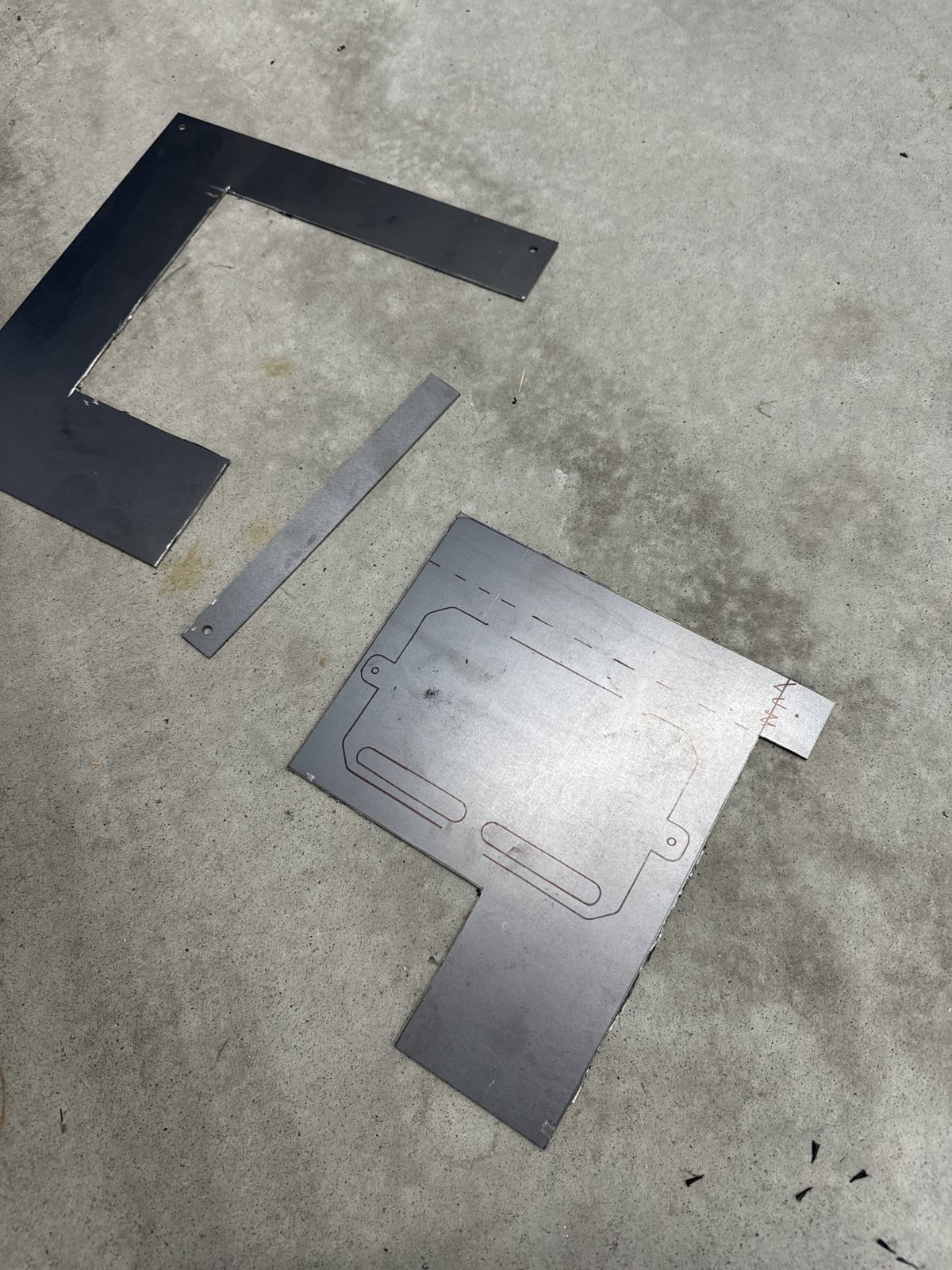

    I started with that on the ends and then used a grinder to cut the straight parts, just got a little carried away with the grinder and messed up the ends lol
