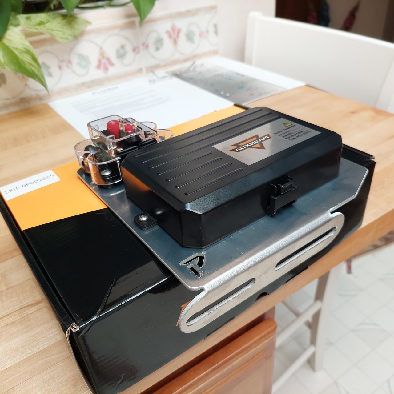

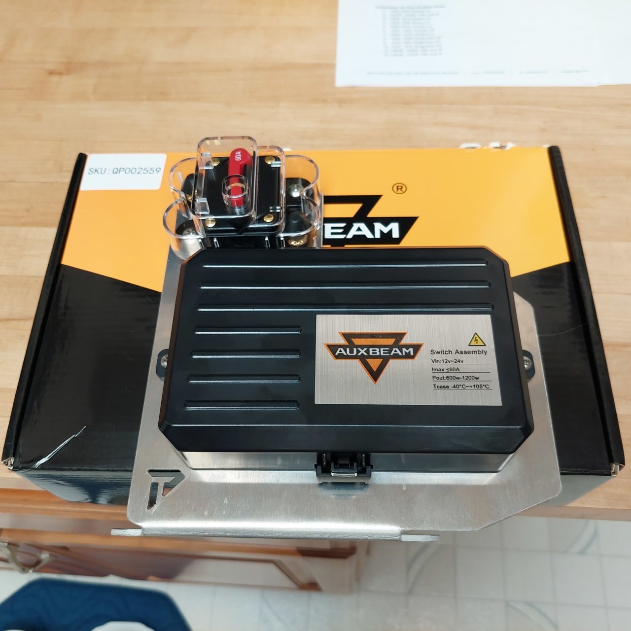

    I have my Auxbeam and Power Tray together. :)

    Kinda concerned about the aluminum cracking in the bend. Hope it doesn't break over time.

    with that thickness and what's on it, I wouldn't worry about those cracks. the tight radius bend is what causes that. Bolt it up and wire it up :D

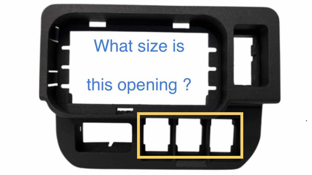

    I’m in a similar situation and the parts/layout paralysis.
    I have a voswitch and thought I’d be able to avoid the tray but I also have a few other electrical items to power up. The voswitch needs the ground bar for the loads and I’m going to use a 6-fuse bluesea block and an mrcb for protection....I probably need a second one for the voswitch.
    Also it’s a pita to mount the mrcb close to the battery, I’m going to fab a small plate and attach it to the battery hold down bar.
    More parts!!
    Can you tell me the size of auxbeam opening on that guild bezel?
    I went back and forth with them and they didn’t tell me the dimensions....I was going to see if the voswitch will for there.

    Pocket is about 4.562 x 2.625 and back opening is 3.875 x 2.062
