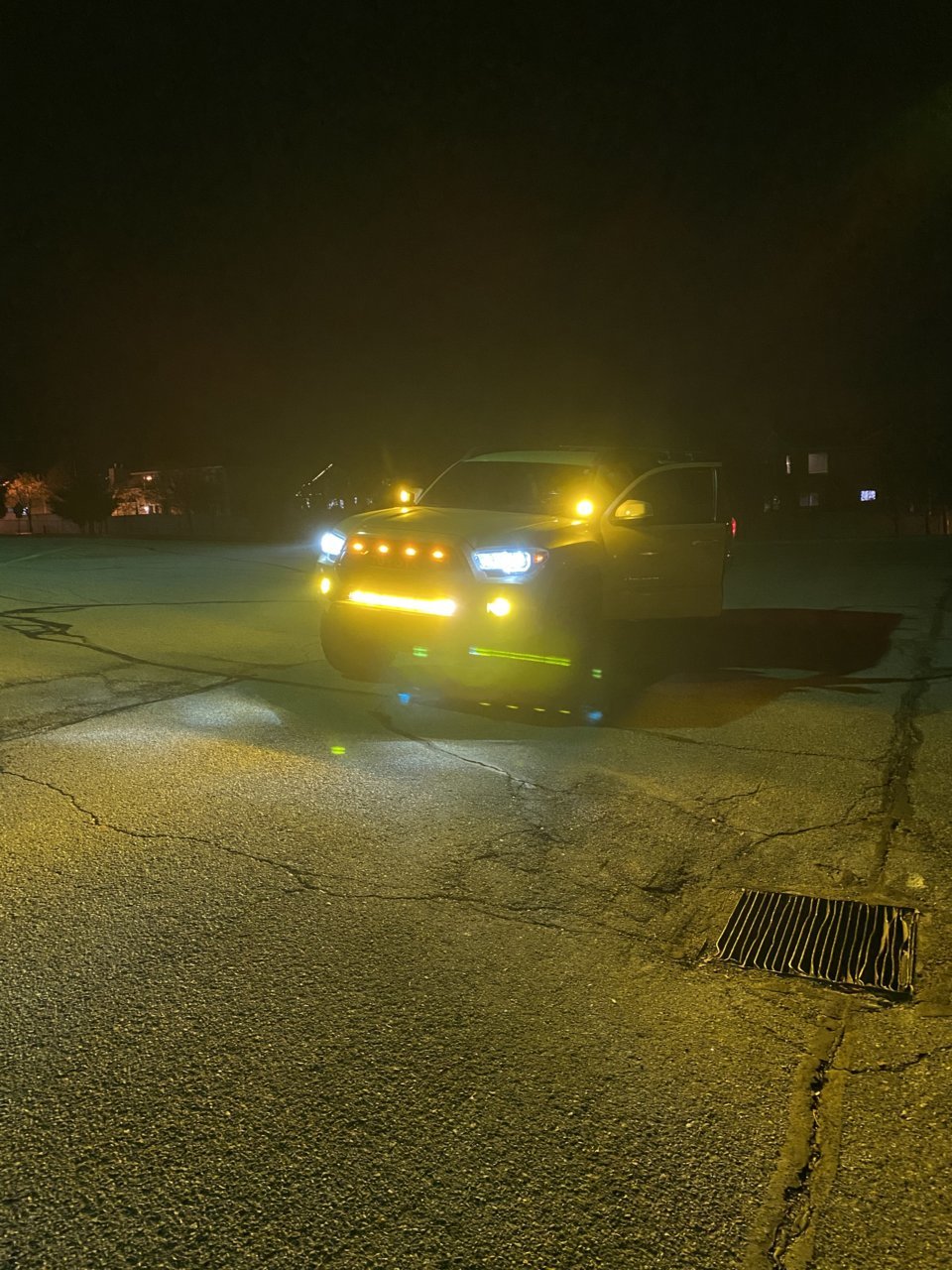

    2016 dbcb trd off road quicksand lb
    ARB Shell, BP51, 255/85/16 ST MAXX, SCS Ray 10 Matte Bronze, Caliraised led 32 inch/side shooter/amber pods, floor mats, start x remote start, auxbeam 8 gang switch panel, diode dynamics hid lows, Australian Shepherd
    I love my caliraised bumper bar. As for real lighting just pony up the cash for diode dynamics
    I have ss3 pro fogs
    CLiraised 30 inch bumper w amber covers
    Hid low beams
    Side shooting ditch lights
