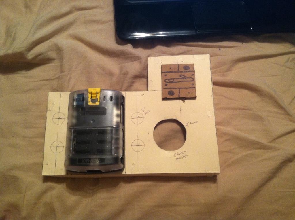

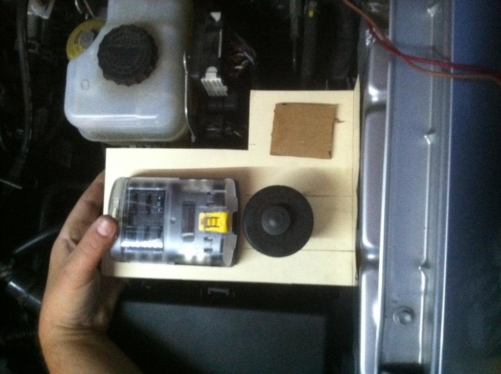

    Welp, after having some time to search through a few more threads, I narrowed down to 2 options -
    1 -
    2C07A6EA-4EC4-447D-A871-7A4E1D4B1E8A_zps_c3524a27479c5cf5169af1ad210c641267a4337a.jpg
    and 2 -
    D3EA67DA-772F-41DA-85DA-7D65EB87CA0B_zps_a35a66f327a1e9be961071808dfa8e045cc3d3c2.jpg
    The cardboard square represents the circuit breaker which is in the mail still.
    Option 2 seems to be cleaner. I took that design and ran with it.

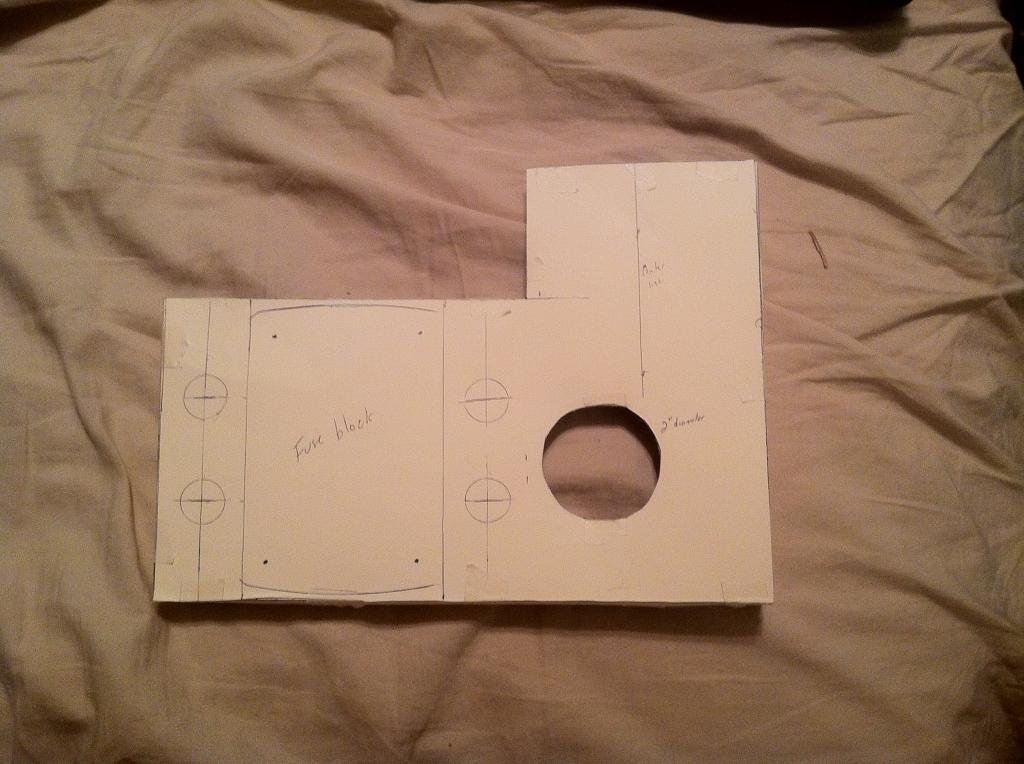

    Heres the final design -
    2C4261D9-31C3-4079-BB1D-A9BC1588A9A4_zps_47e0b23d1dc8366dc65b09a976a1b85589b3bac7.jpg
    C049A195-87C0-4F33-9B1E-91FD103F3D43_zps_a8e9763aac3bb5f2fc703653f041e3d477cdfe22.jpg
    The circles on each side of the fuseblock are going to be for small grommets for the wiring to run through. I may add a 5th grommet for the main ground wire to run through.
    The sides along the engine, battery, and fender all have a 1" lip to make it look more "finished". I have a bunch of relay holders on their way in the mail right now. I plan on mounting the relays and holders to the lip along the battery side.
    The large 2" circle is where the clutch master reservoir will sit.
    Hopefully tomorrow I can get some sheet metal and start building.
