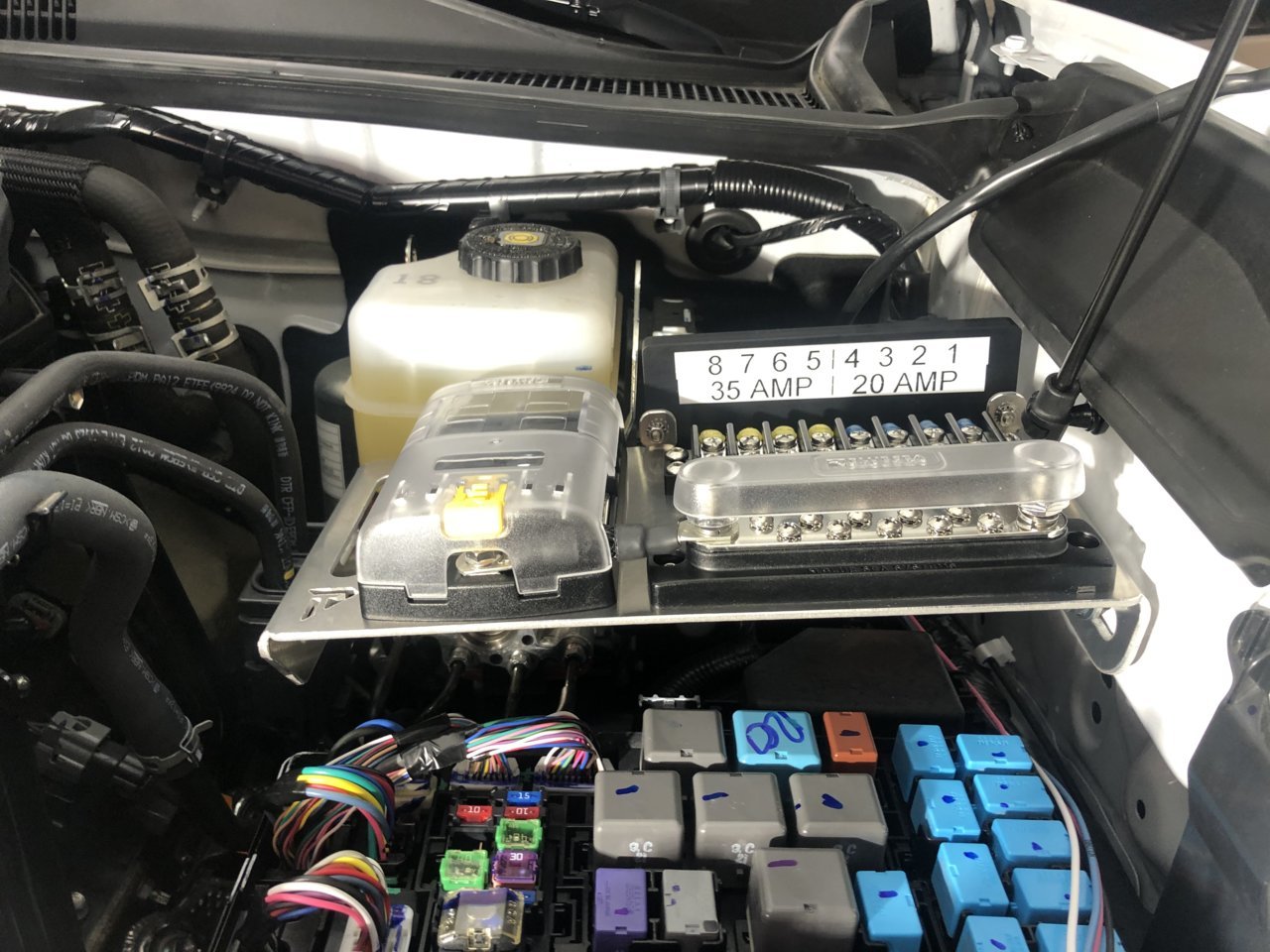

    9E312C5A-1E82-4931-A9EB-F09A24886006.jpg Power Tray

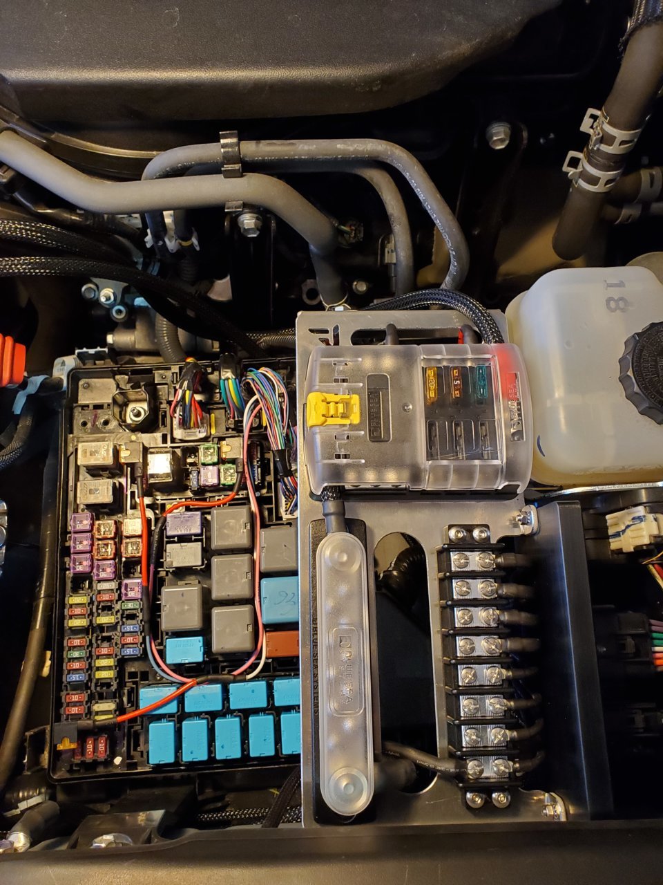

    Powertrays. 100% Worth the money.

    Is the cover for your fuse box off for illustrative purposes or because you couldn’t get it back on with the power tray installed?
    I had a very hard time getting my fuse box cover back on with the tray installed. In the end I had to loosen the Power Tray bolts and move it as far back as possible to get the lid back on. I’m kind of annoyed that if I ever need to get into the fuse box in a pinch it’s gonna be nearly impossible without some wrenches to loosen the tray again.
    Edit: I have the sPOD tray, which might be even larger than the one in your picture.
    Edit2: @PNWTacoAdventures same question to you :)

    The cover is just off to show where I ran the three wires for the s pod system.
    I don't have any issue getting the fuse box cover on and off. You have to finagle it at an angle a little bit and push the insulating cover over the positive battery terminal out of the way. But it's not really an issue. When installing the power tray I did install it as close to the firewall as possible. there is a fair amount of adjustability in those two bolts anchoring it to the fender of the truck.
