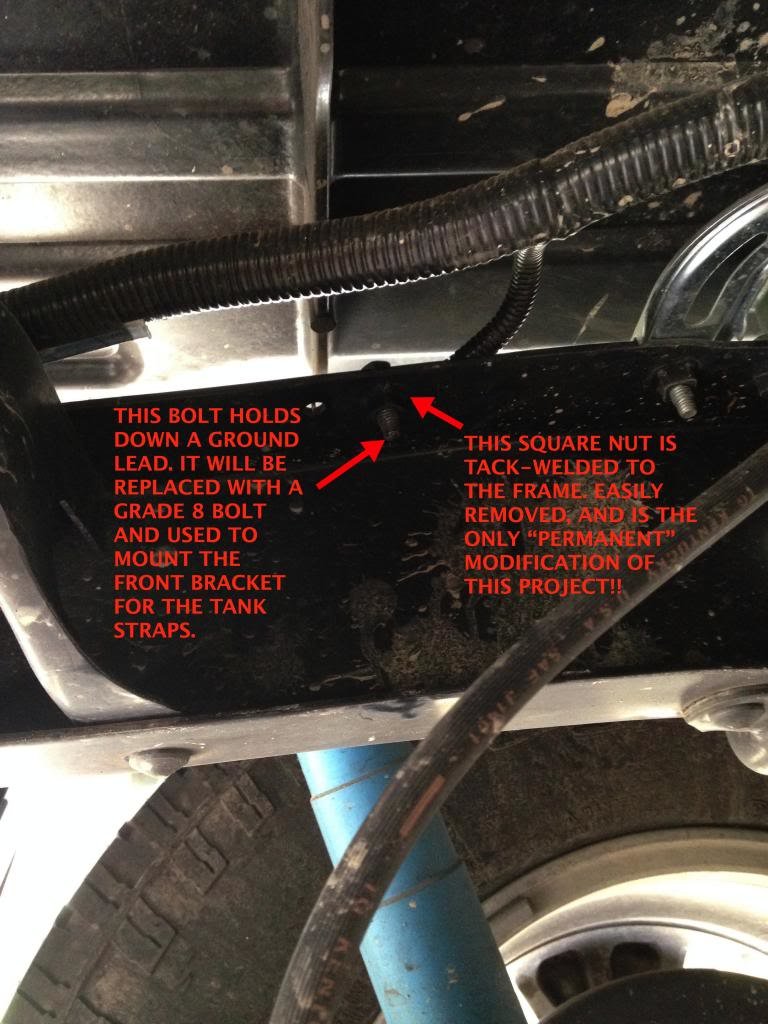

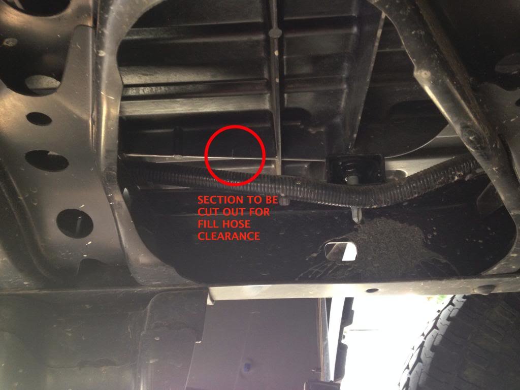

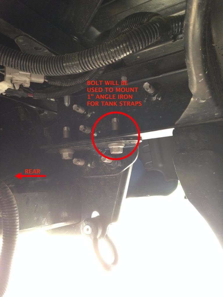

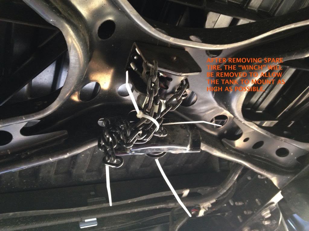

    Met with the guy who's welding up the tank today. Had a cardboard mock-up just to check the spacing and general shape.
    Original plan was a 22"L x 20"W tank, 10" deep in the front, and 8" deep in the back. This worked out to about 17 gallons (not quite hitting Goal #1). After the cardboard test-fit, we expanded it to 28"L, and kept the same upward slope on the bottom of the tank. Rough math now works out to nearly 22 gallons!
    I will add pictures tomorrow to show the general ideas about placement and layout of everything.
    I have all the fittings, pump, filter, etc on order. Should arrive in a week or so. Tank built hopefully by the end of the month, but my welder runs his business out of his garage and he's constantly busy.

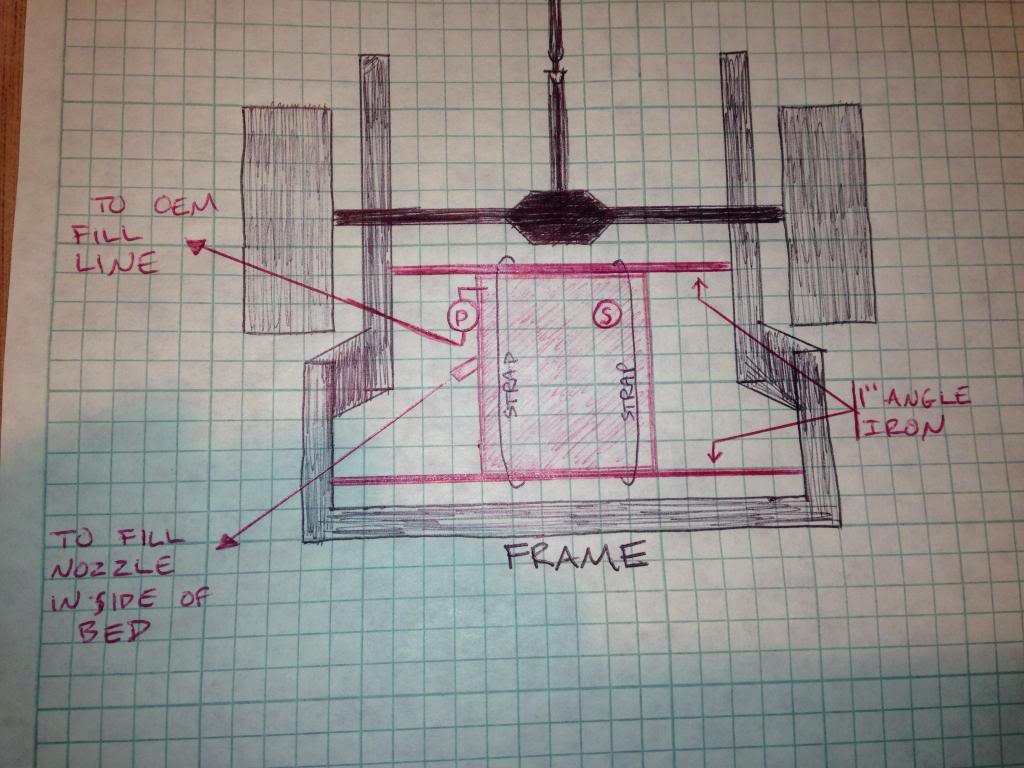

    Well I seem to have developed insomnia tonight, but I can't do any real work at the moment, so I sketched out the tank design and location for reference. I'm not a draftsman, so please forgive my mediocre penmanship!
