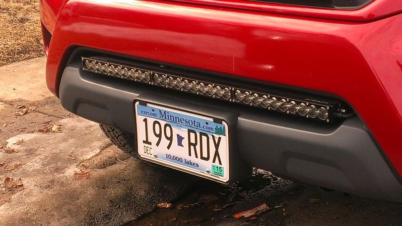

    I've installed horn, LED light bar and will be doing rear lights soon. I'm running fused Hella relays.
    The horn is easy enough, I tapped into the original horn plug behind the grill for the trigger.
    I'd like to tie the light bar into the high beam, with a switch in the dash to disable.

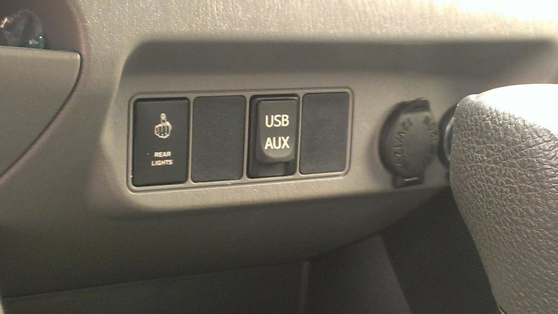

    The rear lights I'd like to tie into key in run position, so they can be used anytime I'm driving.
    The switches' back lights should come on with headlight switch in on position

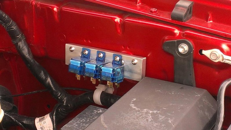

    What would the sPOD get me? I've got the relays in there (see pic above) and OEM style switches for the dash. Just trying figure the best way to trigger the relay tied to the high beams.

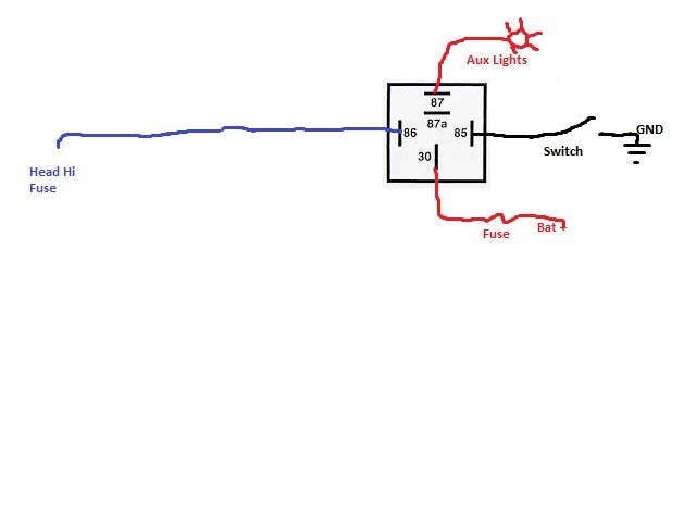

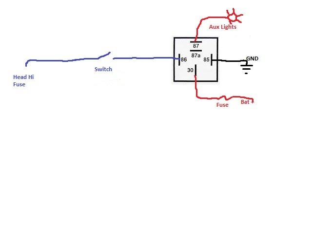

    Here's the wiring diagram for the headlights.
    If your using a relay to control the aux lights and want them on with the high beams this is how I would wire it.
    Or
