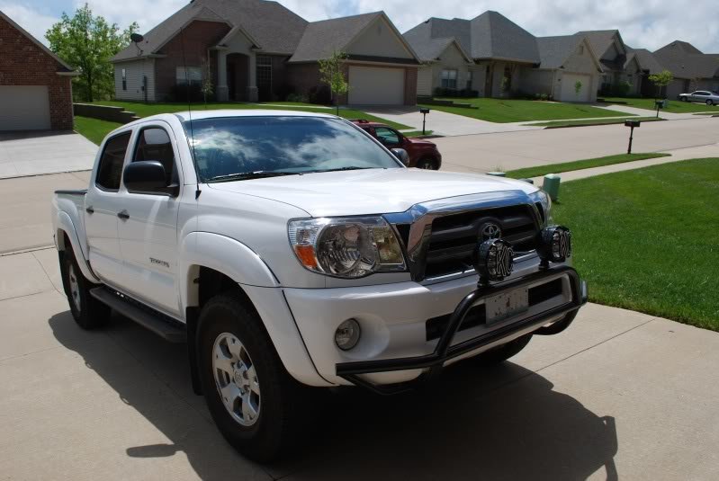

    Anyone been tickited for too many lights in MO? I work with someone connected to LE and she swears my lights are illegal. Statutes say "At least 2 headlights" and "no more than 3 Auxiliary lights". I have factory fogs and 2 KC lights plus my headlights. She's saying that my 2 fogs + my 2 KC lights = 4 aux lights. Curious if anyone has been pulled over or cited for too many aux lights? I don't use mine onroad, obviously. They're mostly for show.

    My father is a Kansas City cop and I asked him about this with a previous vehicle I had two headlights and 4 aux lights (6 total when all on). He said the Missouri statute said 4 lights total were allowed (2 headlights, 2 aux lights), and the Gestapo will write tickets on it (he doesnt give a rat's ....).

    Yeah, there is a specific statute subsection that says only 4 may be lighted at one time. I don't run the fogs + the headlights + the KCs though. I may actually pull the fogs - they're useless anyway. I'd rather have my KC lights.
    The funny thing is, that some cars like the Jeep Liberty come from the factory illegal. They have 4 Aux lights mounted way above the 12" to 42" height mentioned in the statute.

    She is correct.
    Fogs must shut off with the high beams, and the driving lights must shut off with the low beams.
    Wired properly there should be no issues since you will have no more than 4 lamps at any one time.
    Any lights higher than 36" must be covered when on the highway.

    It's actually federal... FMVSS 218 is the governing document.
    Some states may have more strict laws, but I haven't heard of any.
    The main thing is that not all states equally enforce federal laws.

    California allows one pair of auxillary lights designed to supplement low beams, one pair designed to supplement high beams, one pair of fogs. At no time are you allowed to have more than four lights on. Factory headlights with four bulbs on for high beam count as two lights.
    My general experience with the cops around here is that they don't give a rat's ass about equipment violations. Everyone I know that's been ticketed for anything (never for lighting) got their ticket after being stopped for something else.
    I do what I want as far as accessories. I don't speed, don't drive like an asshat, don't leave my brights on approaching other cars. I have never had a problem with the 5-0. At one time I drove a bright red 4x4 Toyota with 2 8inch off road lights on the bumper, auxillary reverse flood lights on the back, Hella E code headlights with 100 watt high beams, and four KC daylighter style lights on the roof. The roof lights were not covered, as they are required to be in CA. The cops and highway patrol never even looked my way.
    Your setup looks pretty innocent. Don't piss the cops off and you'll be fine. They'd rather mess with the bro running a lift, no mufflers, wide tires, no mudflaps, and drop in HIDs.
