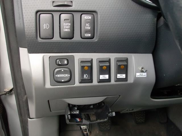

    ^^ ahh beat me to it
    not as fancy, but you can get some of these from oznium.com

    Yea just minor trimming inside the hole. With the switch inside, it covers everything so it still looks clean. I've actually moved away from that set up pictured above. Now I have switches all from OTRATTW

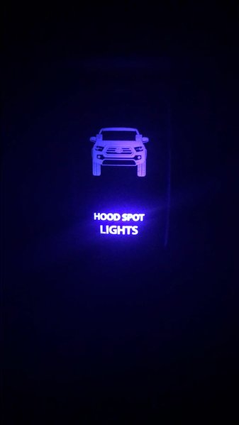

    So question... these lights have 4 wires? 2 are usually red? The generic eBay light bars have a harness with a generic switch with 3 wires.
    So if I were to connect 3 wires from generic switch to only 3 wires of the mictuning switch, then the mictuning switch will only light up when pressed in? Other than that it will never light up when headlights on etc...?

    Yes the extra wire I jumped from an "ignition on" fuse that way when the truck is on the words light up. When the button pressed the top lights up.
