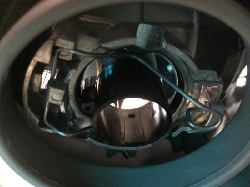

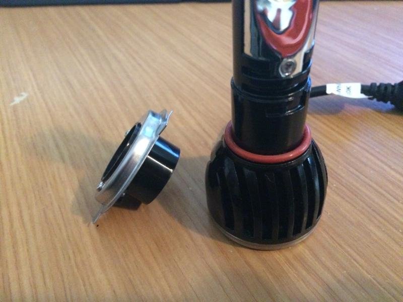

    The retaining ring on each headlight is removable and was VERY beneficial in this process but, I still struggled greatly with the headlights on the truck..so, they came out. This absolutely is the easiest way to get these installed. You see, the rubber headlight "boot" has to slide in between the retaining ring and the heat sink which was IMPOSSIBLE to do with the headlights in the truck. You need leverage.
    (Borrowed from C1pher's thread)
    Once the headlight was off the truck, simply put the retaining ring into the headlight as you normally would and re-seat the retaining clip:
    The rubber boot took a little trimming (I mean VERY minor) in order to seat the LEDs back into the retaining ring. Once that is done, simply slide the LED bulb with the rubber boot back into the retaining ring and head light assembly and turn it to lock into place.

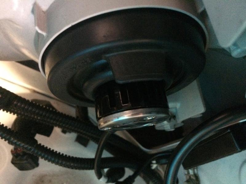

    This is after they are installed, but you can see how little room there is on both sides behind the headlights:
    Driver:
    Passenger:
