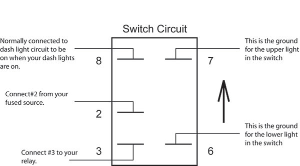

    Ok i got a question I'm sure someone in this thread can answer. .. I ordered 2x "benson" 3x3 cree lights $20 And they shipped me avec lights with full harness.:thumbsup:.i figured why not use it. The avec switch has white black and blue wires coming into it. But i have a 4 pin rocker switch
    Anyone re switched there avec harness and can help?

    I use 5 pin switches, but you can definitely look it up on google images for a diagram of 4 pin rocker switches. That'll get ya set up!
    With 4 pins it should be power in/out and power and ground for the light on the switch. Its a weird set up though, ive never seen all 4 pins on the bottom like that. But youll still have to look up whitch pin is what. Also that will be a "carling style" switch you have there.
    That configuration of your 4 pin switch is kinda uncommon. Did you purchase those switches? Is it a DPDT? Youre gunna want to buy a SPST switch with 3 pins, or a 5 pin, whitch will have two indicator lights on the switch. Your choice on that though.
    Okay here is an image of a 5 pin SPST switch. A 3 pin will be minus pins 8 and 6.

    Ok thanks. .
    so I need a 5 pin switch for the relay wire.
    I have not use a relay on these switches when i wired different led strips.

    You cannuse a 3 pin with a relay too! The 5 pin just simply adds another indicator light on the switch, 2 instead of one. One light that would come on with the dash lights for example and the other would illuminate when the switch is in the on position. The 3 pin just has a light for the on position. And again make sure to get a SPST switch.
    The use of a relay is just a safety feature. Pin #3 would be used to power the relay reguardless if you get a 5 pin or a 3 pin rocker switch. If a relay was not used then pin #3 would simoly be the wire that powers the accessory.
