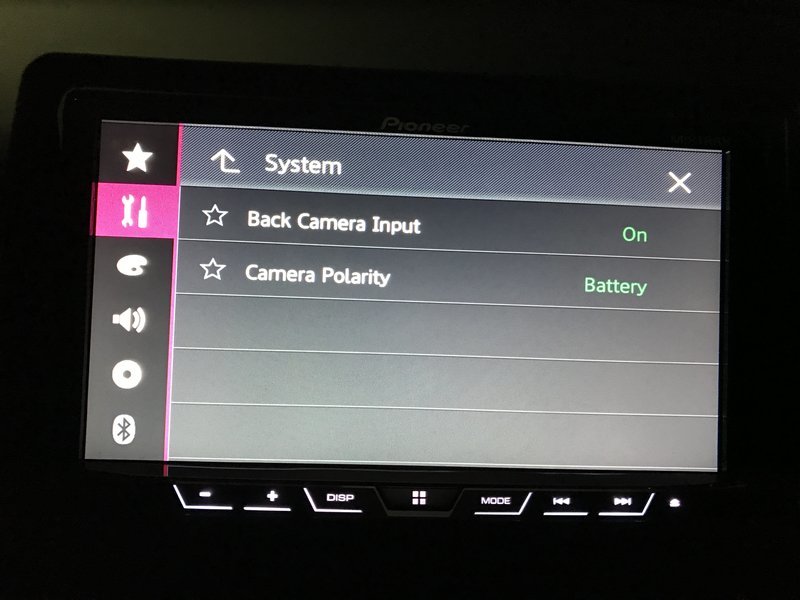

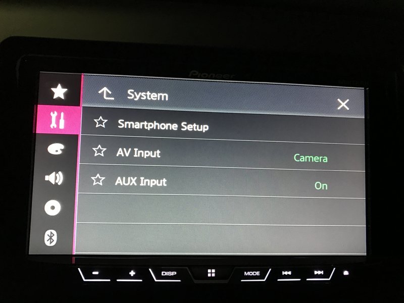

    Here are the settings that have have for the camera. I literally had to take my head unit out 4 or 5 times and played with the wiring then the settings before I got it to work. I'm not sure what the deal was with that but I kept running out of time so I put it back together and tried again later.

    I have the crux 61s, pioneer 5800. I used your settings on the head unit, but I still don't have the backup camera on the head unit... any thoughts?

    That's the problem I had when I installed mine. It took me a few tries with the wiring and then I messed with the settings and it started to work. I'm not 100% sure what I did to get it working.
    I just posted the settings that I'm using on the radio that works for me. I was hoping that was the issue I had but apparently not since you're having the same problems.
    When I installed mine I took it out numerous times and unhooked everything and put it back together then I played with the settings.
    Hopefully you get it to work soon.
