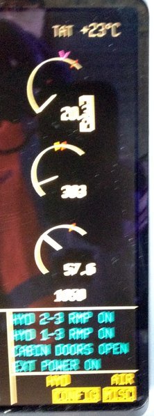

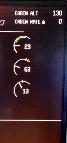

    Today is MD/DC10-10 & 777 day. One of the MD10s showed up with reported #3 N1 issue. Pics of me doing ops check.10-10 ind.jpg 10-10 ind1.jpg

    What did you figure out and what was the fix ?

    It was a spurious fault on the #1 VIA...forget the exact fault code. We did follow the FIM with VIA checks, checked for 28VDC at the N1 tach sensor cannon plug (at the fan) and it checked. Did a system RTS and ran the motor at ~40% N1 switching between VIAs and no more fault.
