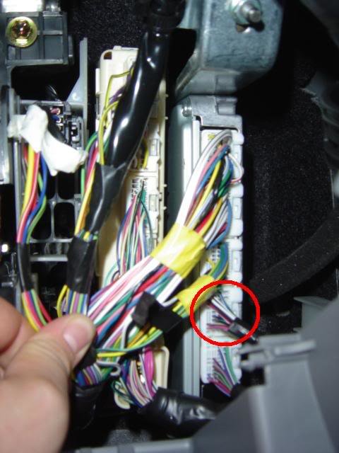

    Found these on another forum..
    VSS = Purple / white wire behind the glove box..

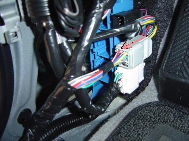

    And the reverse wire can be found in the drivers kick panel. Red / white wire, and it is a bigger guage than most of the wires down there:
