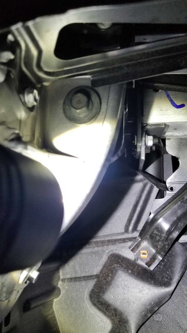

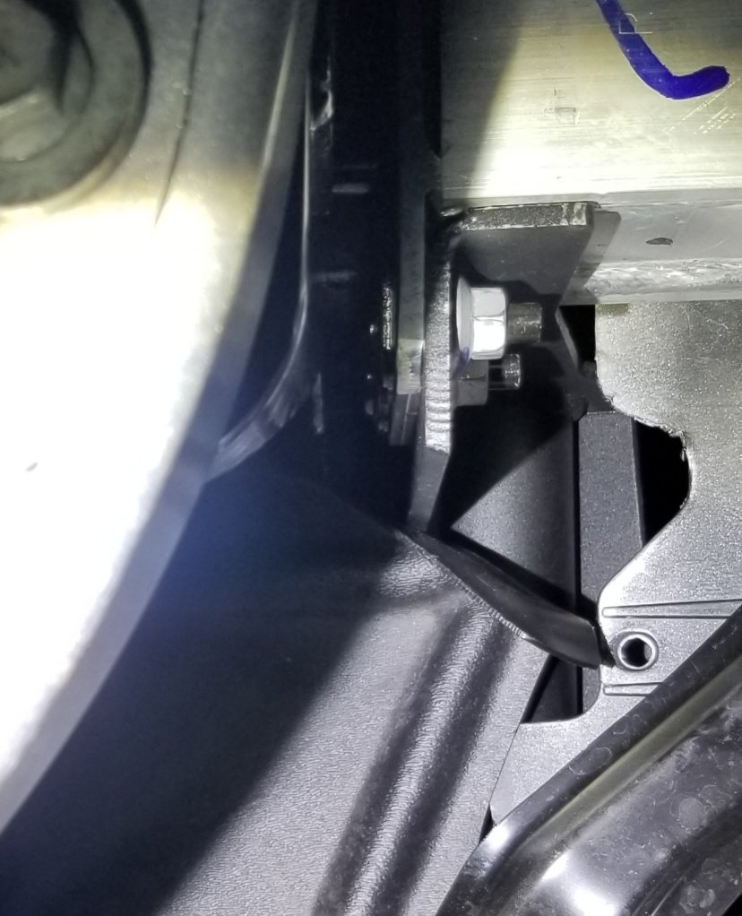

    This is looking from the top down. I should have taken better pictures when the grille and air dams were removed.

    Thanks for the pics!! Do you have to remove the grill? AVID said it’s just plug and play and going in through the wheel areas.
    I’m just trying to figure out what’s entailed before ordering. I hate getting something w/o all the details and find out it’s more invasive that expected.

    You can install it through the wheel wells, but it is easier if you pull the grill.

    It's been a few years since install but I had to bend the inner fender liners back a little and it was pretty easy install without taking anything off.
