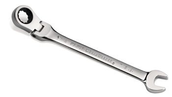

    I was just about to give up on the installation of mine as well. Then I tried using a pivoting ratchet wrench gearwrench-9702-main-sm.jpg (although I can't remember what size)
    and it made it MUCH easier. It was still slow going but having the correct tool made all the difference.
    Try it before you give up. Hope this helps.

    Yep. I paid a small shop to do it today for $50 cash, but helped the guy most of the way to speed it along. Realize I need to get a set of those. My fixed ones would not do the job.

    Please post socket size so I can go out and buy the one (or two) I need. Putting mine on was a B. I need to remove it and get it powdercoated, but the bolts are pretty seized up.

    14mm on gen 3
