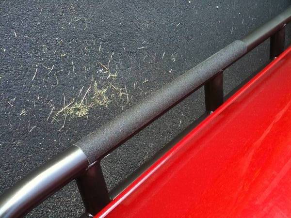

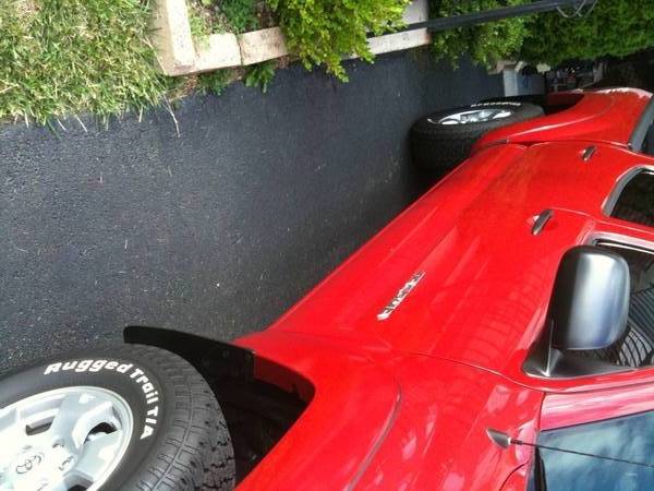

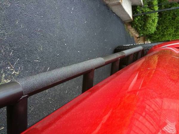

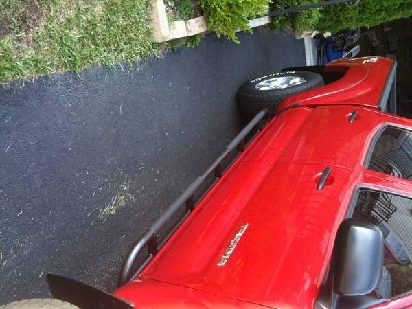

    Okay, first off - I know these will not hold up to the off-road riggers that weld on sliders will. However, I bought this to help the little ones get up into the truck and the idiots who do not know how to open their car doors without hitting my truck!
    So, I went with avid offroad for a couple of reasons:
    • Bolt-on without having to add additional hole. They use the factory holes.
    • Looked very nice in the online photo's I have seen.
    • The price. Just cannot beat it!
    Things I did to prep and install the bar's:
    • Steel wool rub down
    • Alcohol wipe down
    • 2 coats of Rustoleum Flat Auto Primer
    • 2 coats of Rustoleum Hammered Black
    • 3M No-Slip tape
    • Loctite - Blue
    Now to some photo's :) I have some after the paint process if anyone wants to see them.

    They look sweet!

    I may end up doing the powercoating or line-x, pending on the ware of the spray paint.
    The cost. I think was something like $350 shipped. Mention you are a tacomaworld member and he will work with ya a bit.

    Nice!! :thumbsup:I really like the 3M No-Slip tape, I'm going to do the same for my little ones!!

    took the no-slip tape off the driver and passanger side front. The Wife scaped her leg one too many times. I said she would learn, she said she did not want too.. :\
    SO, when she slips when they are wet, do I get to laugh?

    Only if you like sucking your own D**** LOL!!
    But you might want to try the crinkle type finish paint.:thumbsup:
    Might be a good compromise!
