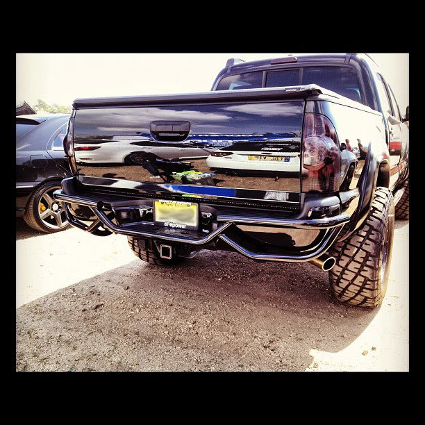

    Here's mine coated and installed. I love the quality and style. Great job Brandon.
    Anybody want a pic of how its mounted underneath? let me know, I can take one today an post it up.

    Hey Gennaro...that looks fricken sweet! Could you post up a pic of how it mounts when you have a minute? I really like the look of that and am sick of coming out of a store to find more scrapes and scratches on my bumpers!

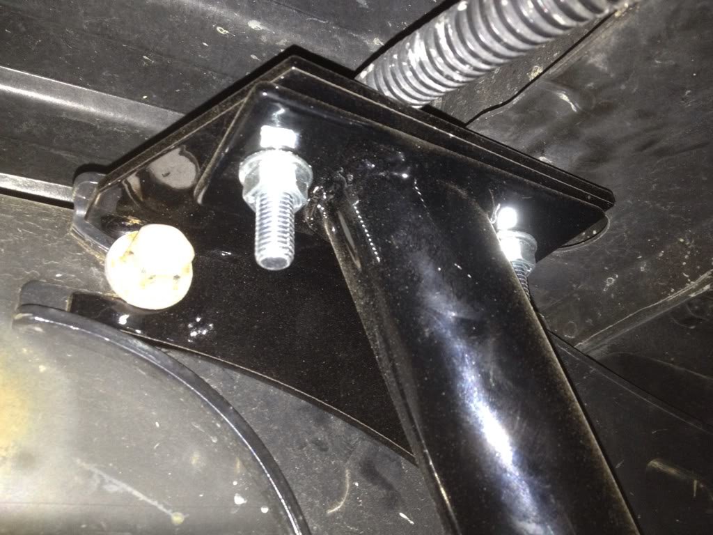

    loose two bolts on the hitch and a third one comes completely out. Mounting bracket goes on first then the avid bar bolts to it. It's much easier with two people haha
    You will need wrenches, 11/16" for bolt head and 5/8" for flare nut, and a ratchet, 17mm, I think it was for the hitch bolts.
