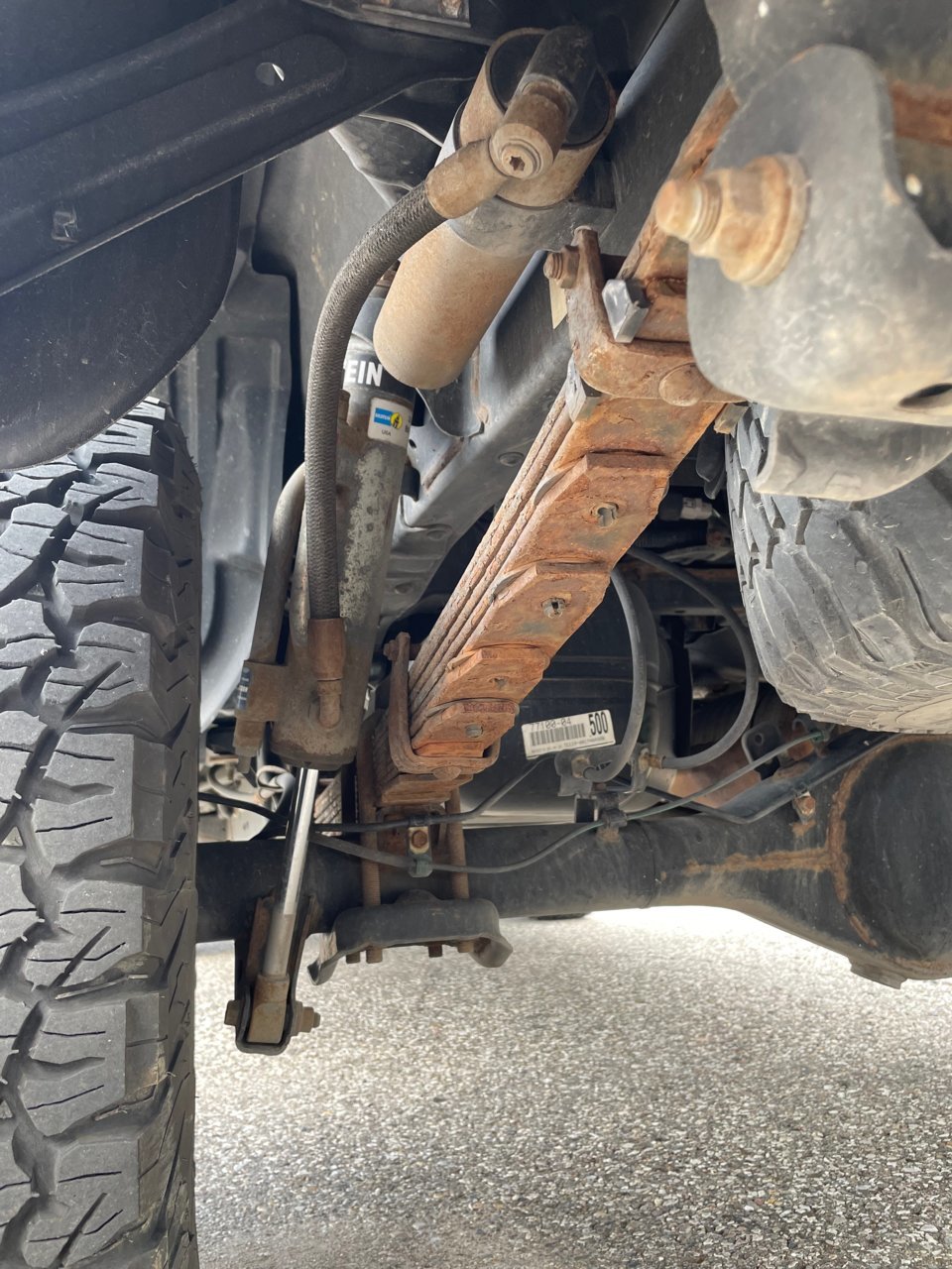

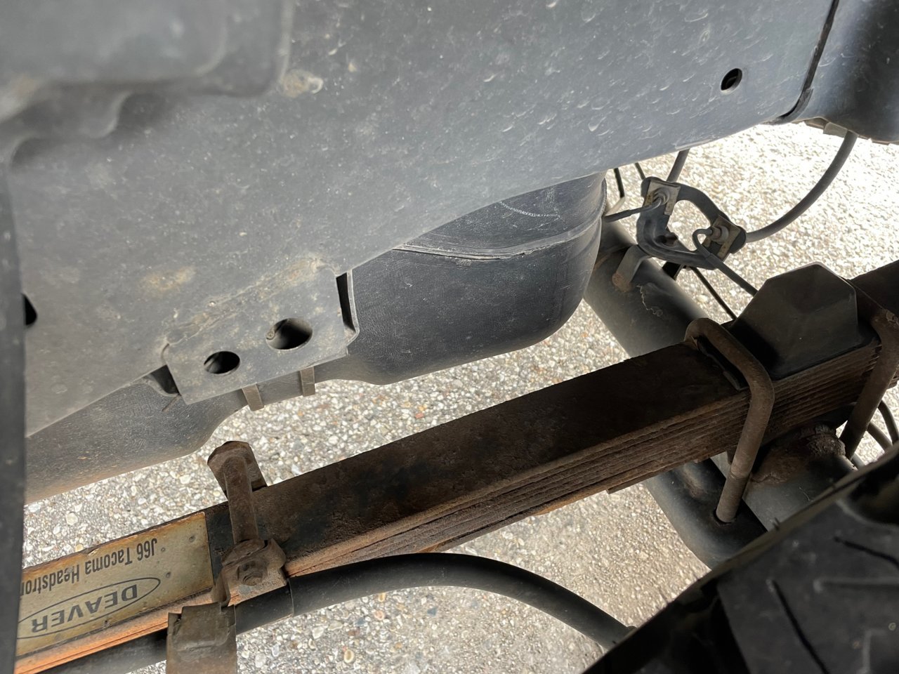

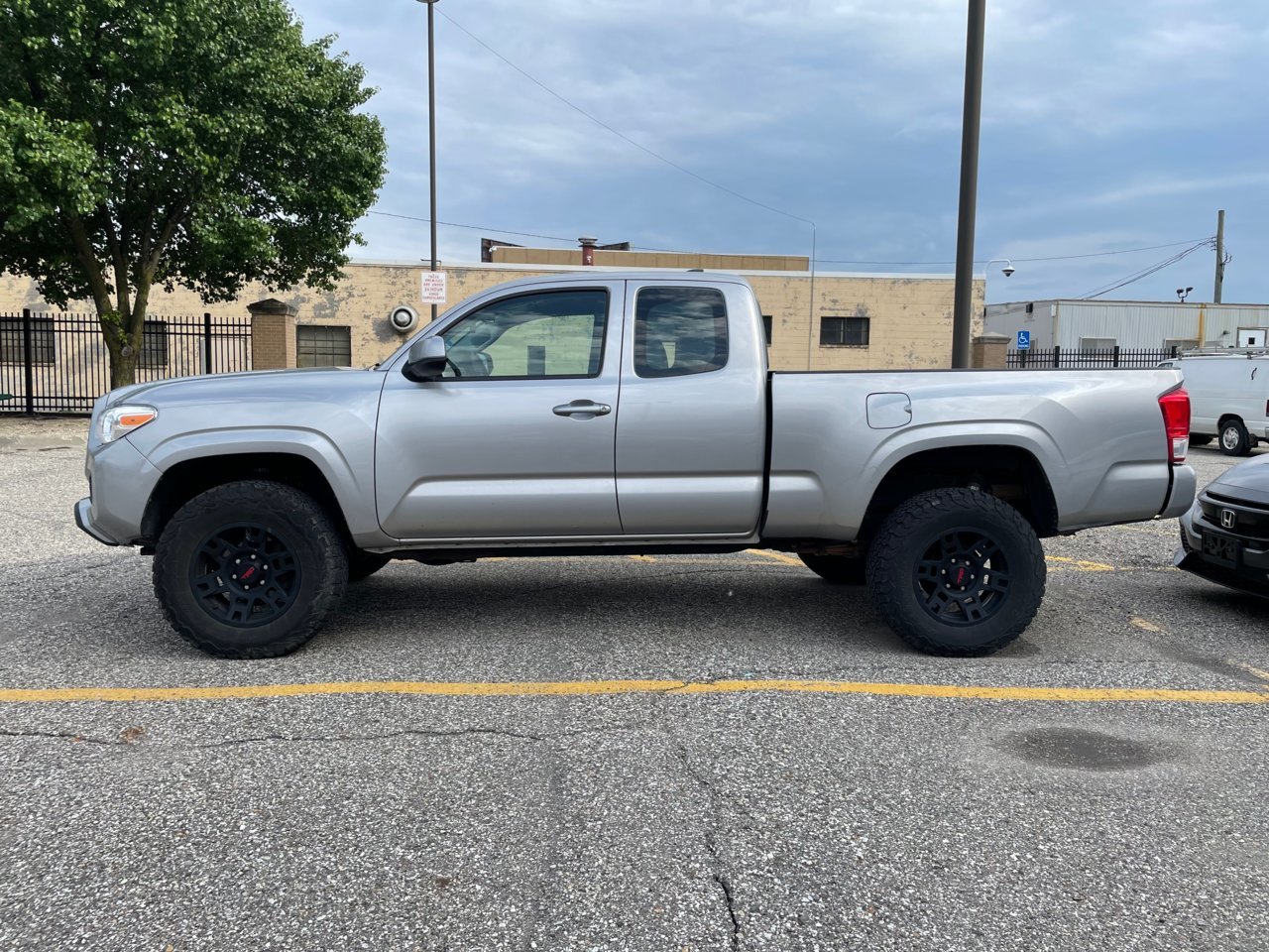

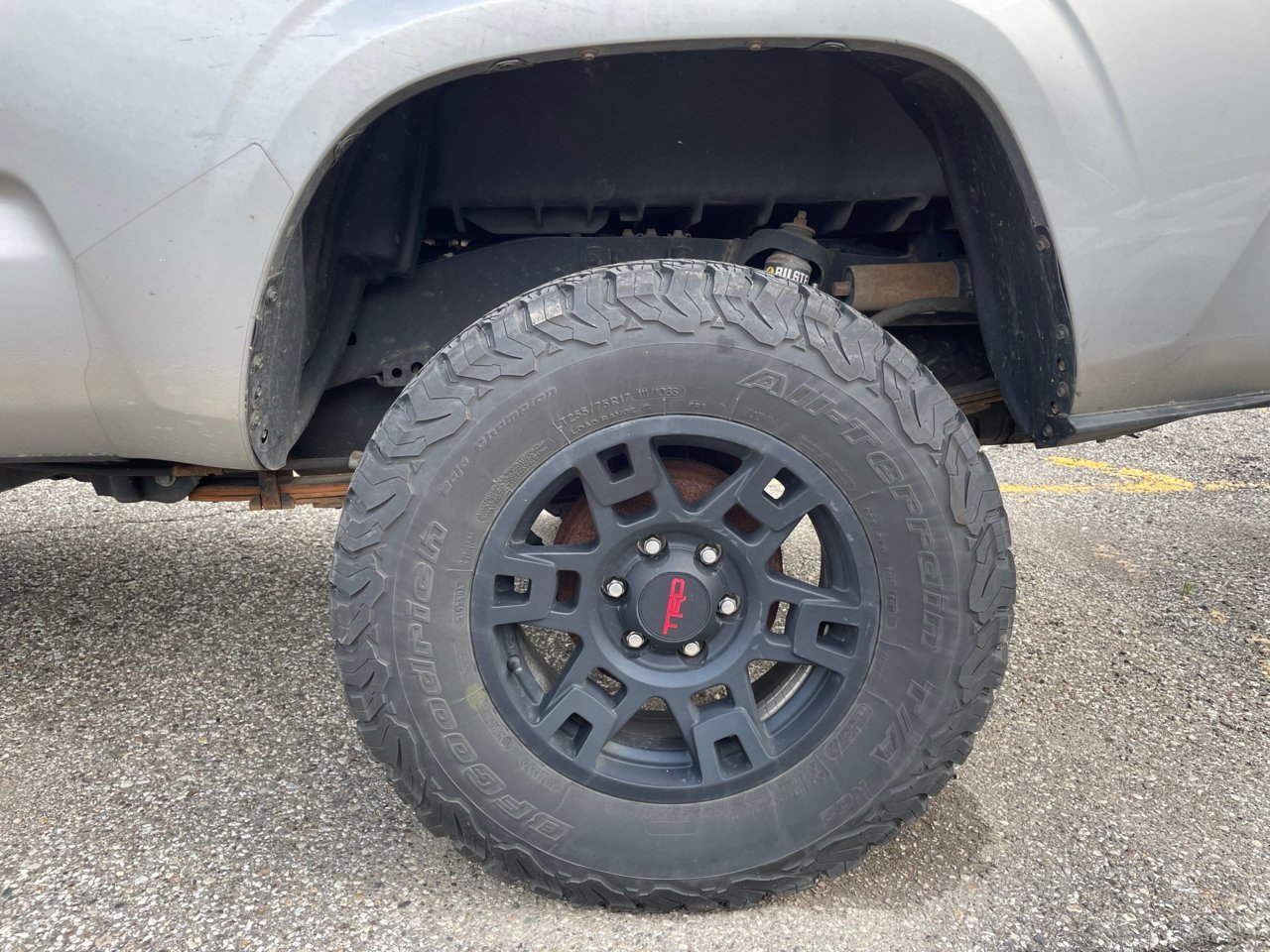

    Zombie re-vive.
    After 3 1/2 years of running the J66 and 8112s, it's not that soft, and the 2" of rear lift it gave never went away. But, put 800lbs in the bed, and it levels out and is comfortable.
    Thought after all these years the springs would sag, nope. Even scrapped a 1250lbs payload of metal in the bed and there was still room between the bump stop and frame.
    Finally, reached 60k miles+ on the boys, so gonna rebuild and removing the bottom two leaves of this 10-pack.
    I still scratch my head on why the j66 was not as soft as everyone says, even the deaver website says it reduces payload to 300lbs. The only assumption I can come up with is the 4-cyl access cab 2wd is so much lighter than the most common, double cab 4wd v6, that even the softest leaf springs are oversprung for the base model tacoma.
