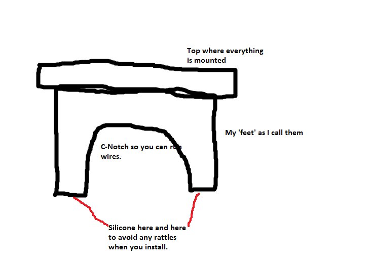

    Awesome build! Whats the chances you have any pics on how you made the mounts for the distribution block and components for under the seat? That is sick! Thanks for your help!

    I don't really have any good pic's of it off hand. (I'll look when I get home) But I drew you this crappy diagram :)
    So what I did was cut a top piece of wood to fit the curves of the compartment which you can see from the pic's.
    Then I cut two legs and cut out a big c-notch to hid the cables. Nailed those together and the legs go to the very bottom. Used some silicone on the bottom of the feet so it wouldn't rattle, and then just dropped it in. Ran the wires through the c-notch and then laid a bead of silicone around it to hold it in place. I'm going to be taking the amp rack out box and rebuilding them then wrap them in carbon fiber. I'll be taking that mount out as well so if I can't find pic's I'll snap you a few of how it looks and PM it to you.

    You the man! Thanks alot!
