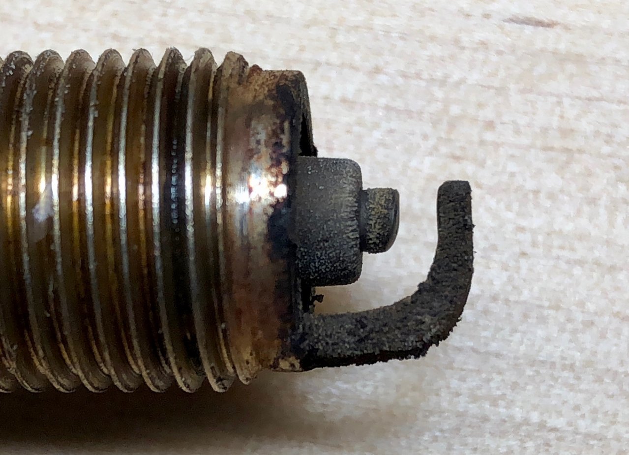

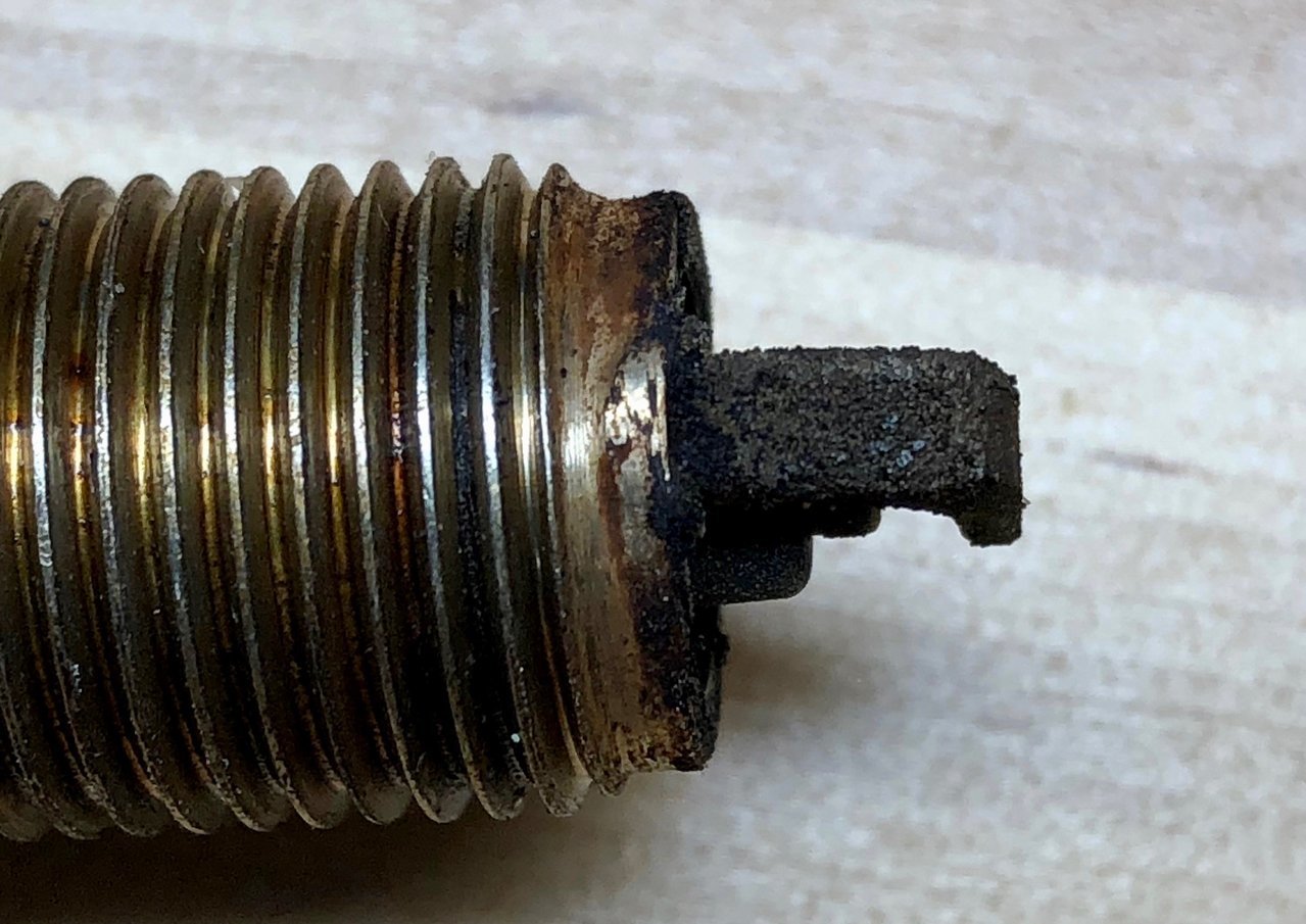

    Just bought a 2012 Tacoma PreRunner V6 RWD with 120k miles on it. Changed the spark plugs this weekend. Does this win any awards for worst spark plug? By the way, the performance now is night and day. I really can't believe the difference.

    I’ve seen plugs with the electrodes almost completely gone before. Hard to believe that the engine would still run!

    It can hard to judge a plug from a photo, but I'd say the engine they came out of may have worm valve stem seals or valve guides.

    I'm afraid I'd be inclined to do a compression and leakdown test on that motor.
    And likely a top end cleaning.
    No doubt about it running better!

    Can you explain what might make you think that? I'm not a mechanic so I don't understand the potential correlation. What would be the other symptoms?
    All 6 were Denso branded spark plugs by the way.

    I'm not having any typical symptoms of low compression such as running rough or stalling. In fact, the engine is running much better now with ample power upon acceleration after the new plugs went in. I'll need to check into a top end cleaning. Are there any DIY videos for this on the Tacoma V6?

    Lots of black soot all over the spark plug...either oil or engine running very rich. Looks more like oil to me. You could also have worn oil rings on pistons(see Clearwater Bills comments). Whatever the case may be, that is not what plugs look like that come from a properly running engine.

    Best explanation I've seen as to why Toyota used two different brands on the V6 is that Toyota is part owner of both companies. Our 07 Lexus V6 came with Iridiums on all plugs; although I don't remember if NGK or Denso. Don't know why only the Tacos were split this way.
    But yes, those plugs have too much oil residue. Check your oil level every 1K to make sure the engine doesn't run out. Opinions range ... generally speaking, if engine burns/uses/losses more than a quart every 1K, engine should be repaired. Going up a weight may help; if you use 5/30, go up to 10/30, etc...
