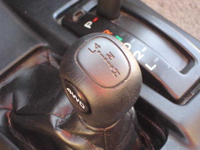

    While I'm not convinced it is useful for my application, I'm researching the ability to swap in a 4Runner transfer case that has a center differential lock (unlocked = AWD; locked = fixed 50%/50% like the standard Taco transfer).
    What benefits would you see to this swap?
    One benefit I can think of is if I had a crawl box (2nd transfer case). I could crawl around in AWD until necessary to engage the center diff lock to force 50% front/rear distribution).
    Best fit for 2002 Taco w/Automatic & 2-4 Select transfer
    For my application, it looks like a nice swap for my current "2-4 Select" Transfer case (non-J-Stick) would be the 01-02 T4R transfer case.

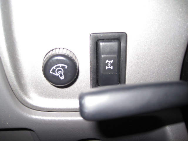

    I would add a center diff locking switch like it is on the 4runner to control AWD vs 4x4:

    01-02 t case should work fine. You would need to do the wiring. But you could have it in 2wd, 4wd or awd from my understanding.
    when you shift the shifter into 4x4 it’s awd. You have to press the diff lock button to engage the center diff to lock it 50/50 for true 4x4.

    99-00 Limited 3rd Gen T4Rs had the multimatic transfer case as did all 01-02. Basically you could have 2wd, 4wd hi/low with the center diff unlocked (aka awd), or 4wd hi/low with the center diff locked (true 4wd with power sent 50/50 to front and rear)
    Nice to have in snowy weather because you can leave in 4HI with the center diff unlocked instead of having to take it in and out of 4wd like in our trucks.
