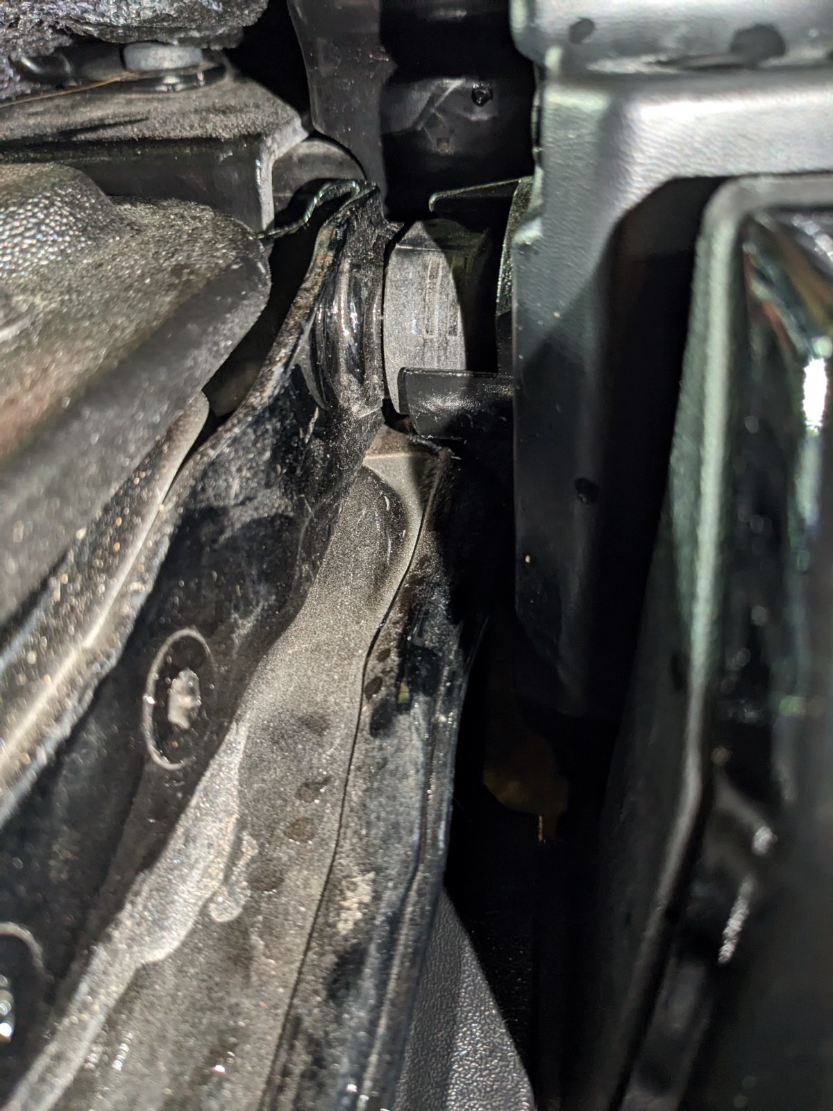

    Hello, I received my part, and it looks just like the pictures, but it seems like there is not enough space to install it on the lower side.
    Is my truck irregular,
    Or more likely I am doing something dumbly???
    Anyone, able to tell me why it doesn't fit, or the correct way to insert around the part that lets the tailgate swing down?
    It does look like the spacing might be too small though..
    Or does the whole tailgate need to be removed to allow installation?

    It should just roll right in. However, in a couple of isolated cases, (and as far as I can tell only one other guy and I have had this problem), right in the corner of the tailgate under the hinge where the tailgate skin is crimped together there is some seam sealer applied. In my case there was a big enough blob of it that it interfered with the device. I took a sharp chisel and shaved down that blob a very small amount and then it slid right in. Just something you might check.
    This is in no way a criticism of the part or the guy who makes it as it seems to be a very, very rare occurrence. I still highly recommend the part.

    You can also heat up a butter knife and flatten the sealer a little to make more room for it.
    If you can't get it to fit, I'll give you a full refund if you want to return it.

    Yes, this basically worked, i heated a flat screwdriver and smooshed that stuff down, so it fits now.
    Just need to figure out how to remove the original t40 bolt next.. i think the tips for that are all buried in this thread. It has not loosened at all even after heating. What is the best technique?
