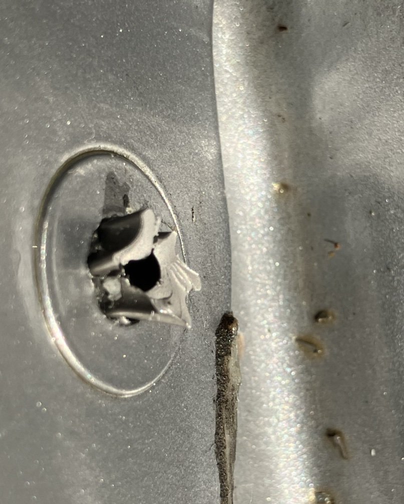

    Understood. It won't move and I'm really not inclined to drill it out. In the rare times I take my truck to "high-risk" areas: like parked at a trail-head in the mountains for a week somewhere, I remove it and leave it home.

    Got the device from Chris (thanks for the good service and quick shipping!) and tried to install. Didn't have a T40 so I bought one at Lowe's figuring I'd only need it once until I could get a proper set. It was their house brand, it was cheap and a mistake. Damn thing was hollow and I managed to twist the tip off. I'll buy a proper set tomorrow along with some Kroil.

    No, do not turn it opposite, it will really clamp down. Us a punch that fits into the T40 and give it a couple of really got strikes, and it will come out much easier.

    Ooph! :eek: Ya: I saw this in my future as well, along with a very hard landing on my backside in the driveway when it went nuclear on me. I think if I had a breaker-bar on it, I would have ended up launched into orbit. :facepalm:

    If this happened, it is not the end of the world. Drill out the head, and drill the screw out and re-tap. Use M6 or M8 tap forgot which one.
    Toyota must use red Loctite on screw, it was a bitch to remove the screw.

    Once you drill the head off, the remaining piece will unscrew easily, there's no lock right, there's reverse teeth on the underside of the head.

    Just finishing installing mine with a friend whom is a long time certified mechanic. After reading much of this thread we found most of what we had read to be helpful, and incorporated it in our process.
    We first began by disconnecting the tailgate limiting cables off of both sides, and turning the tailgate sideways, then laying it carefully in the bed under a sufficient padding. No need to remove any wiring, just carefully turn the tailgate with the drivers side of the tailgate inward into the bed of the truck. This left the passenger side and subject torx bolt easily accessible for us. Again, carefully is the word here as to not put any strain on the tailgate wires. Trust me it can be done.
    At this point is when I discovered the factory torx is a T40, non tamper proof head. (2023 Off-road)
    I placed a T40 torx socket on the factory bolt to be removed and carefully but significantly struck the torx socket head 2-3 times. Then switched over to a impact hand hammer driver. Make certain that the hand hammer driver and torx socket are not at an angle, a second set of eyes comes in handy in verifying alignment prior to striking. With a 2 pound hammer we struck the hand hammer driver/factory torx socket on the bolt head 3 times. While no movement was noted on the factory torx bolt, our first attempt loosening with a standard 1/2” ratchet on the factory torx bolt, it came loose. Once the factory torx bolt “moved” it was very easy, basically able to be unthreaded by hand.
    Note; we did not use any heat, although I suspect it would have aided the process. Las Vegas ambient temps around 45 degrees today.
    Reinstalling was relatively easy and the provided tamper proof T45 bolt (which should absolutely be ordered with the bracket) can be installed using a ratchet if one uses an extension and lifts the tailgate about 1/2 way up to provide access to the new torx bolt, the extension allows for ample clearance out past the taillights. Again, a second set of hands comes in handy.
