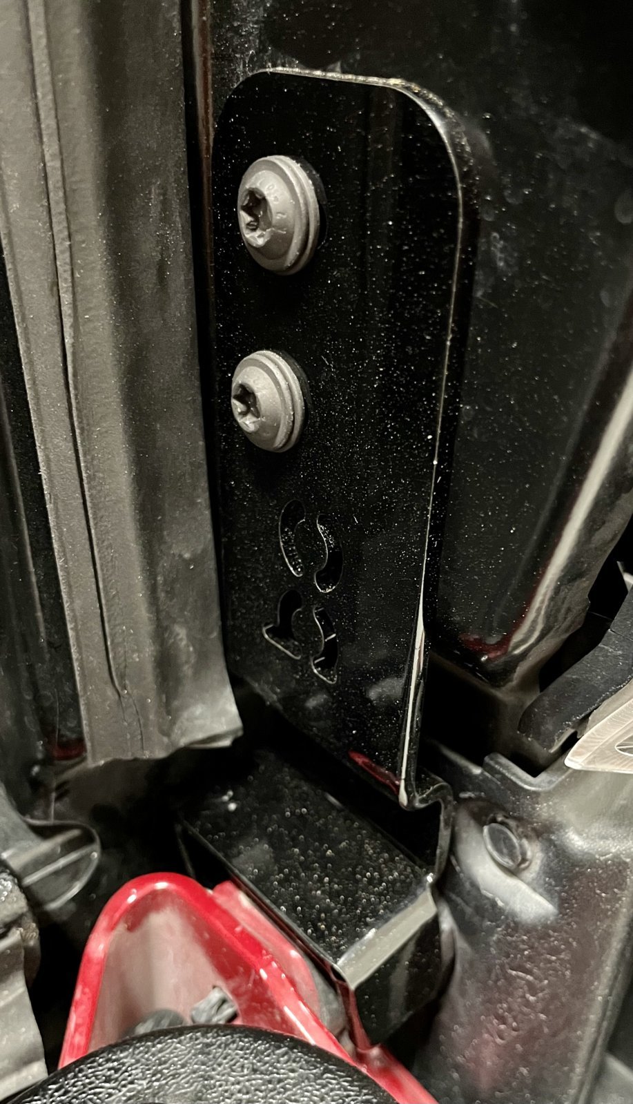

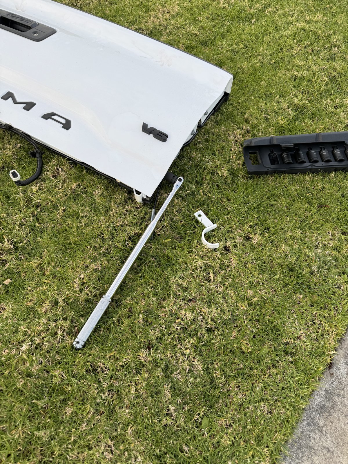

    Ordered and received within about 5 days. The install was easier than I expected...

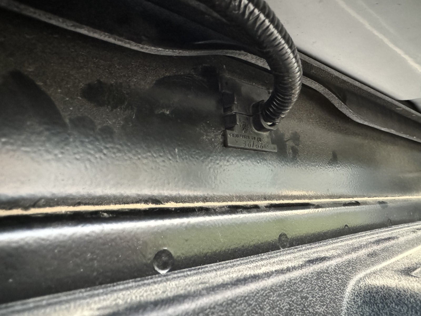

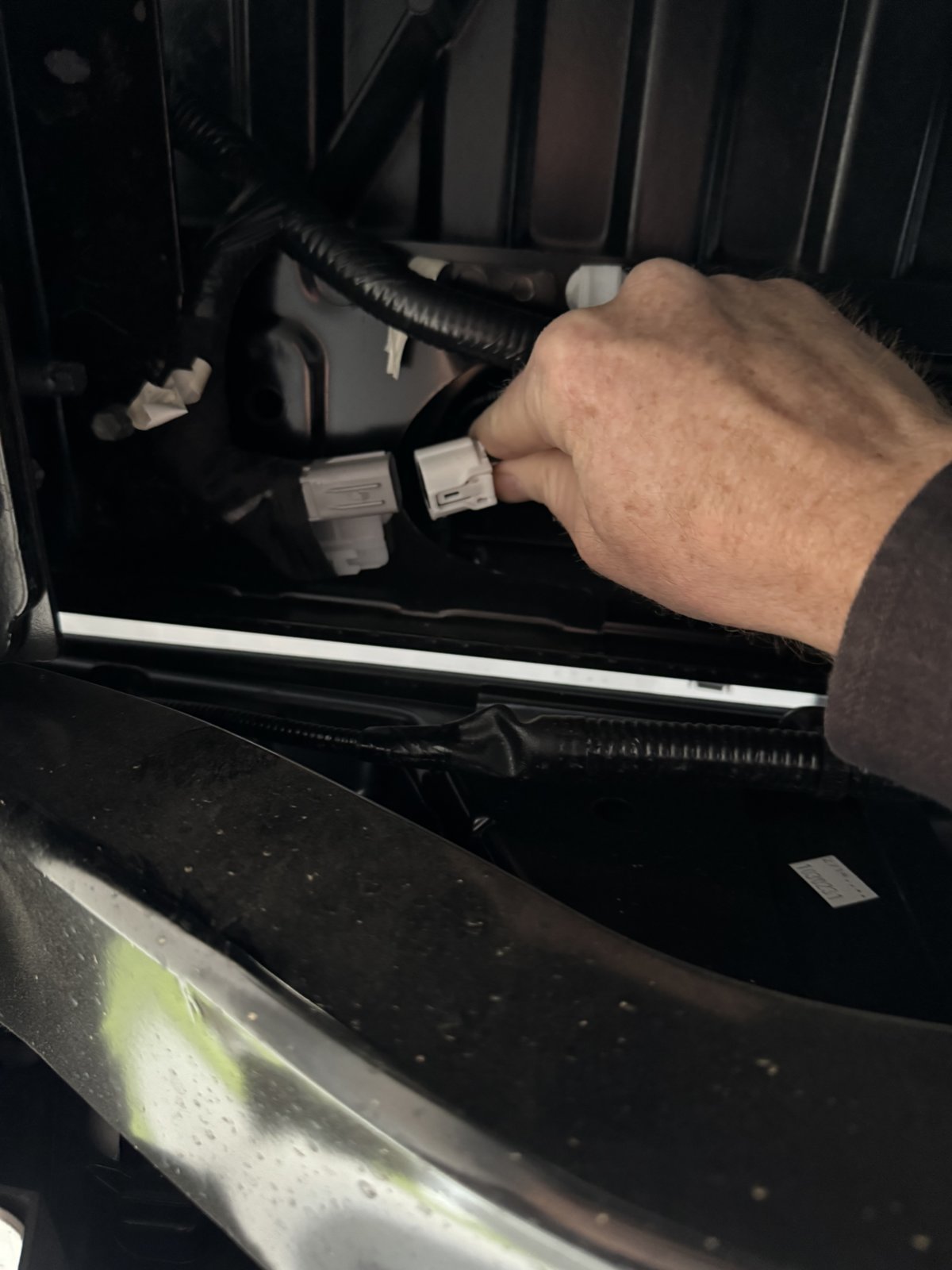

    I removed the tailgate completely from the truck. This wire cluster disconnects easily just on the other side of the wall, and this black retaining clip easily comes out with the wire.
    Looking up from underneath to disconnect the tailgate wires.
    Tailgate on the grass for ease and paint protection.

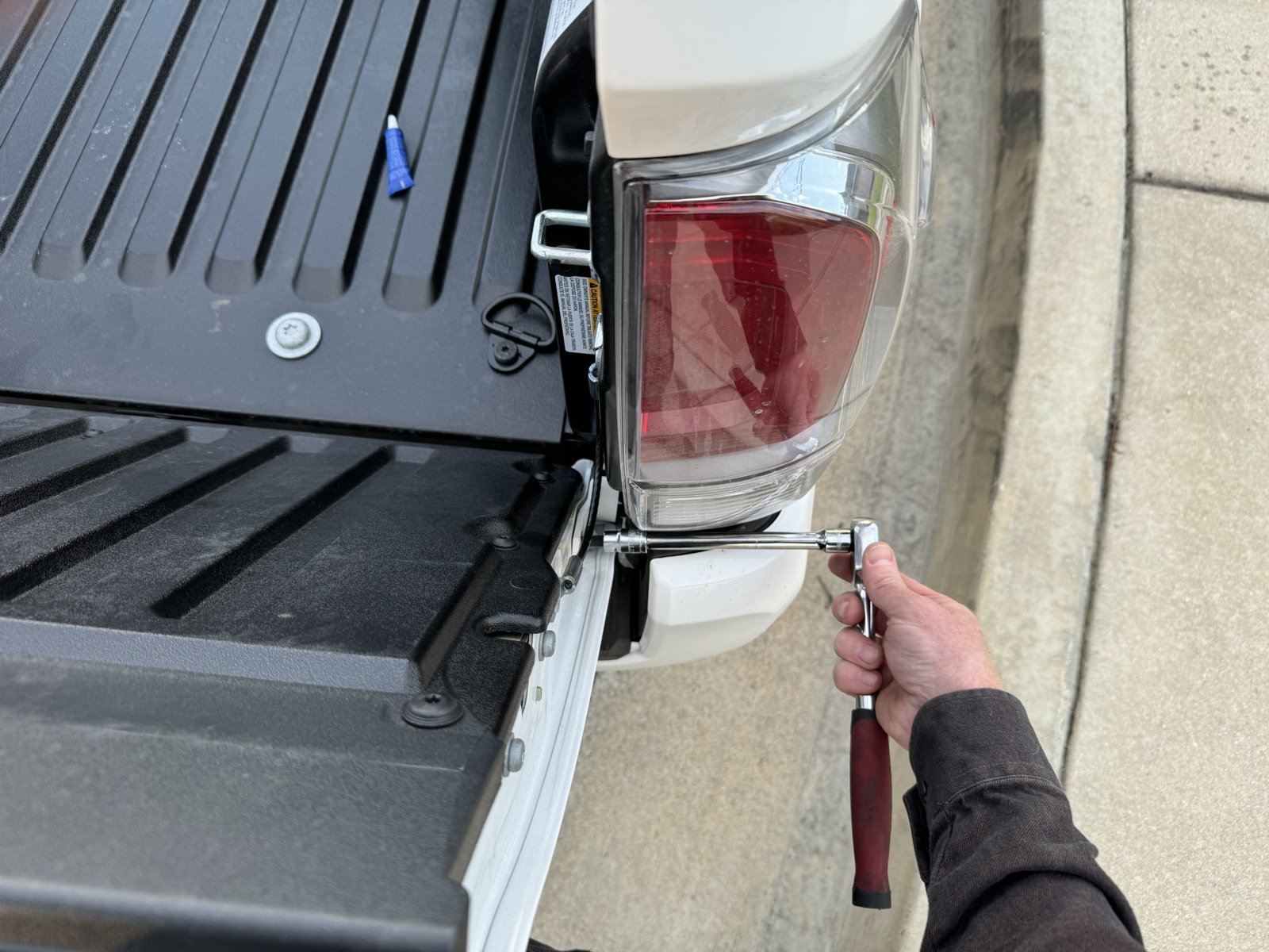

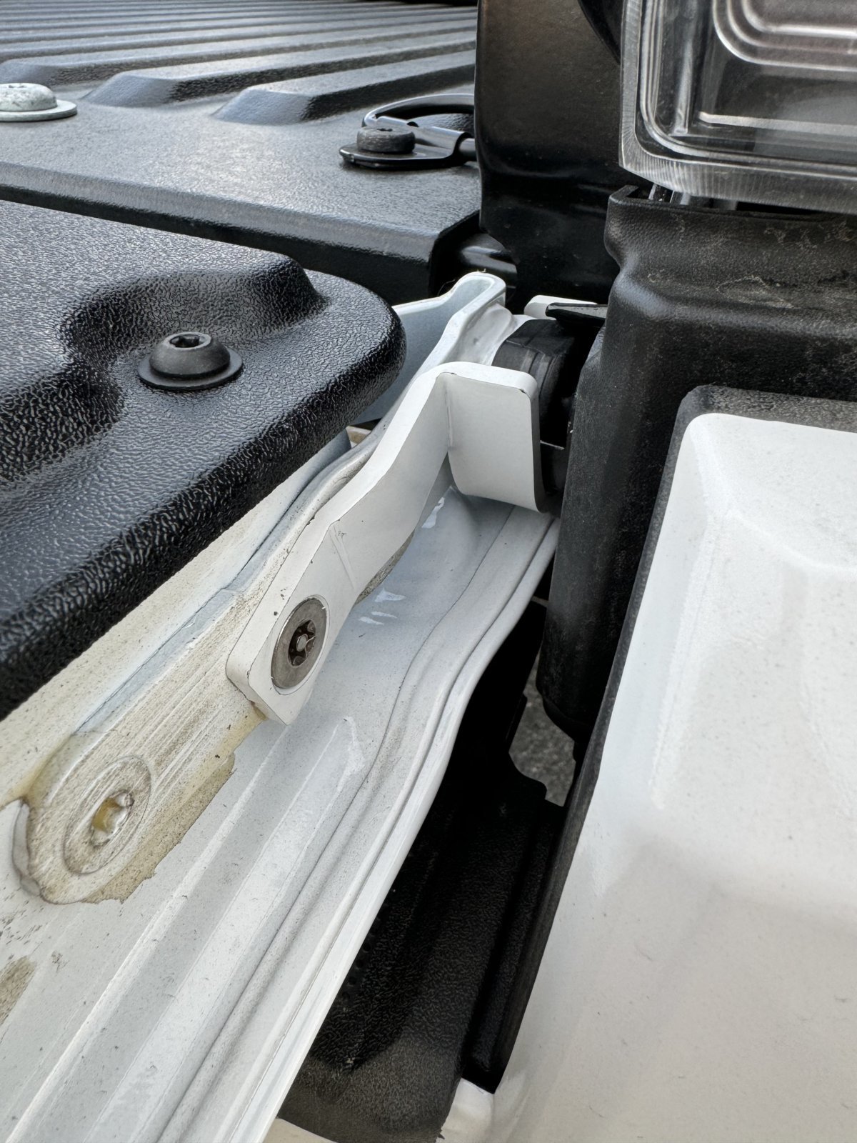

    I thought I read that this screw would be a T50, but mine was a T40. With the tailgate flat on the grass, one knee holding it in place, I was able to break that screw loose with the breaker bar pretty easily. No adjunct methods needed.
    Reinstall the tailgate, and slip the bracket under and around the pivot. Hold the tailgate at just the right angle to access the new T45 security screw with a rachet extension. I had some blue Loc-tite around, so I used it on the new screw.
    Installed, and secure. Remember to re-connect the tailgate wiring! This bracket looks like it came from the factory, and my mind is much more at ease with this installed. Thanks @christian06 !
