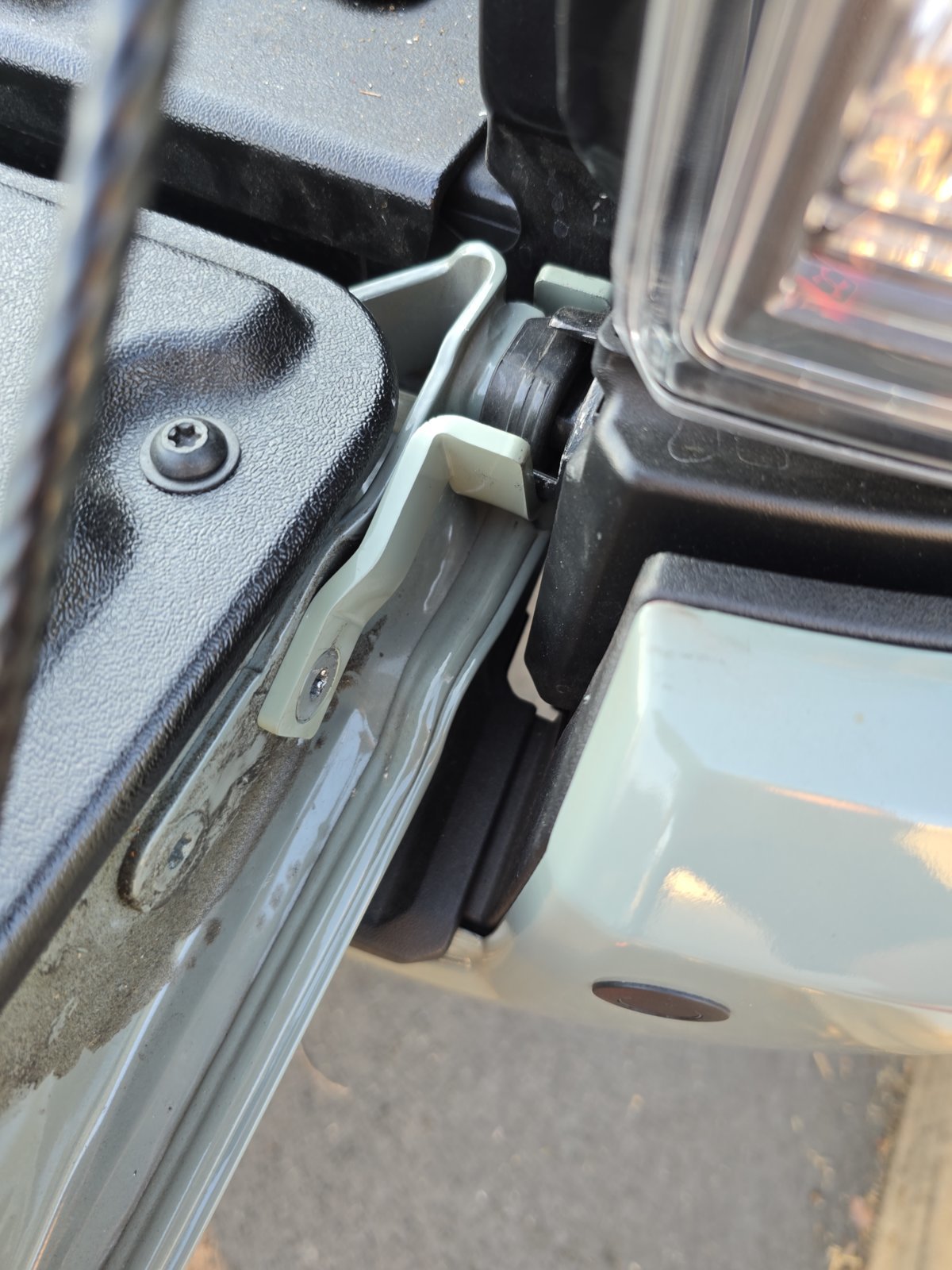

    Here’s the two buddies… 2nd and 3rd Gens! Many thanks Christian.

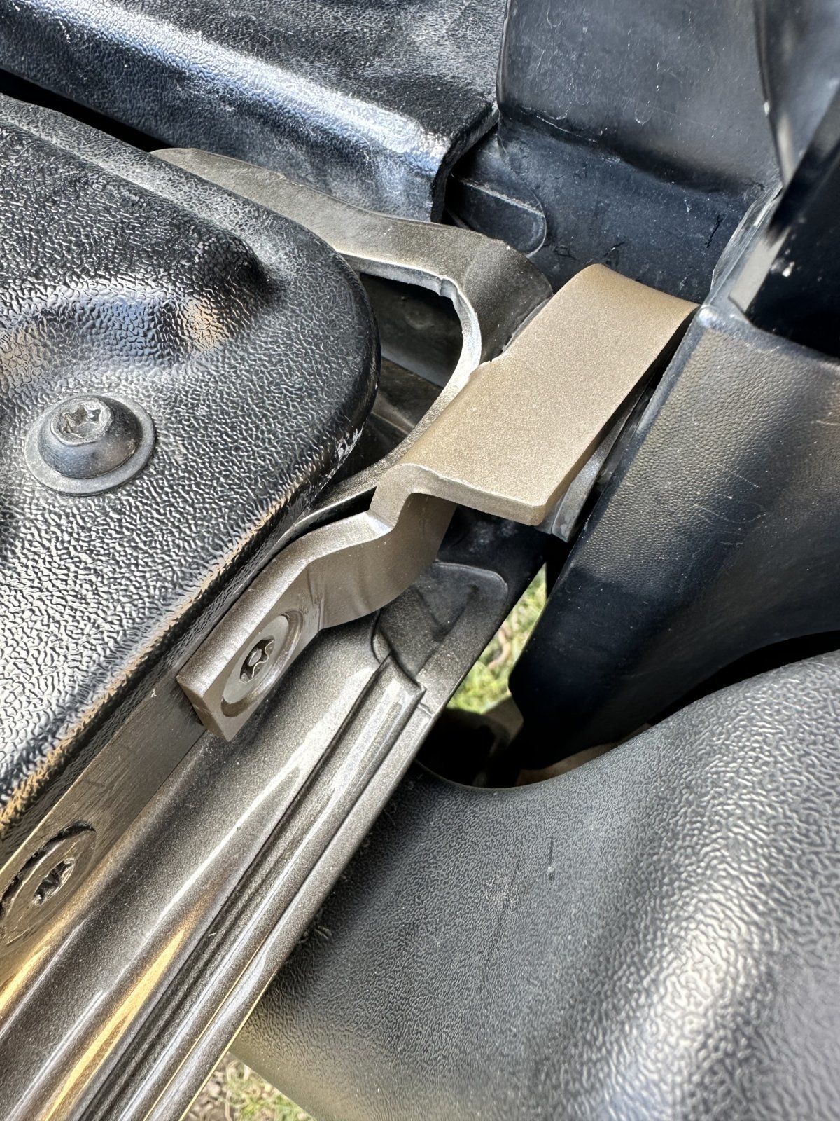

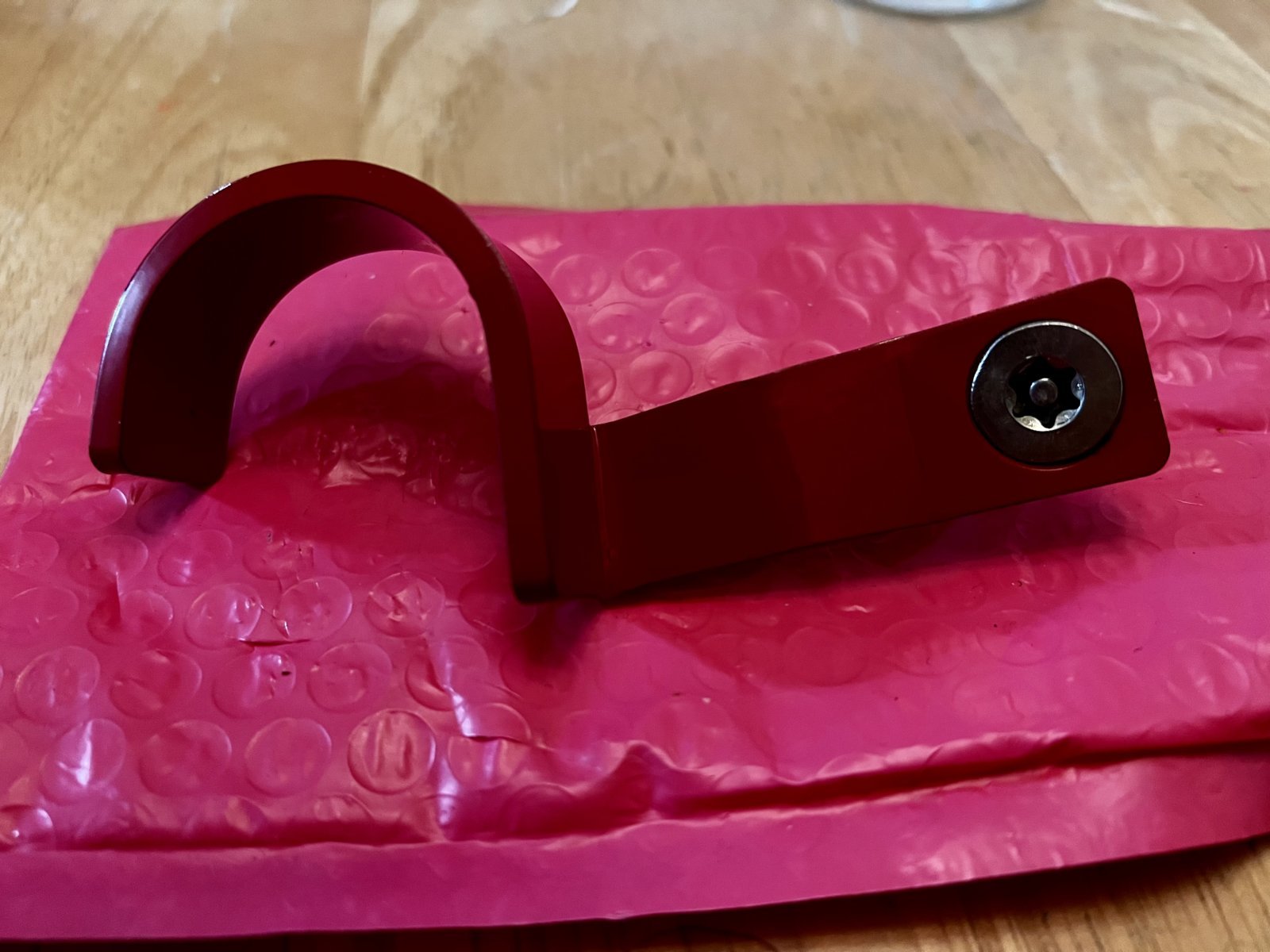

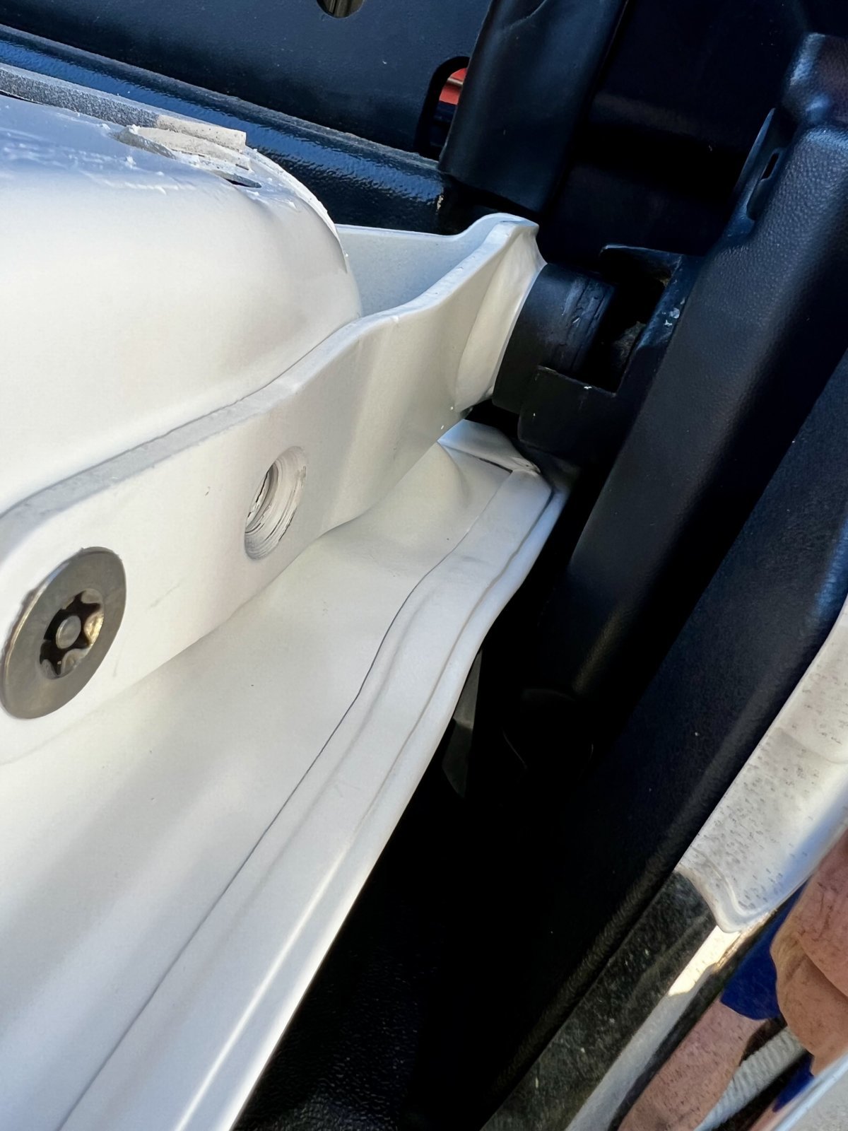

    Thanks Christian, received mine and installed! A sturdy and elegant solution that should thwart most tailgate thieves. The color-matched powder-coat is a bonus, even if not normally visible.
    Just enough room with the tailgate about 1/3 open to line up Torx bit on the bolt using ratchet extension. My truck is only about a year old, but still took a couple hammer hits to loosen original bolt before removal. The weld bead under my tailgate hinge was a little thick, so a couple light hammer taps (with rag to protect powder coat) were needed to get the curved portion of lock fully under the hinge.

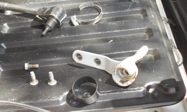

    After my grandson demonstrated how easy it is to defeat the hose clamp - suspicious he had experience at this........ I bought an exhaust pipe adapter from auto parts store ($2.35?), hack sawed a close fitting steel ring, painted it black and fitted to the hinge. Done.
    There are some marks on the ring now - probably from some dummy with a scewdriver. Survived for 8 years now. Wish it was this easy to protect the cats.
