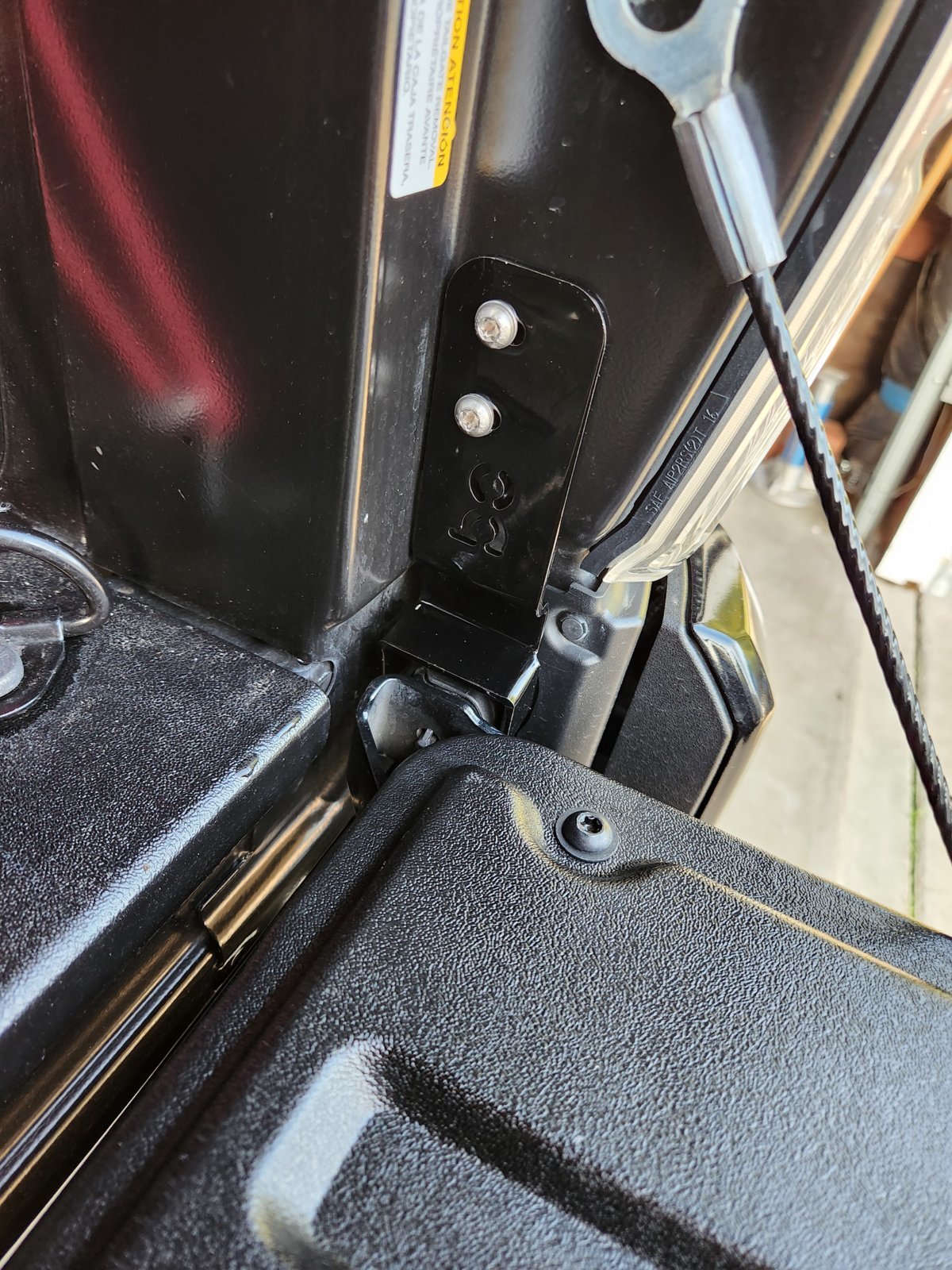

  20. Jul 23, 2024 at 2:54 PM
    #360
    Josephray70
    Josephray70 Well-Known Member
    Jun 1, 2024
    #450775
    615
    Joseph
    Grand Rapids, MI
    2017 Toyota Tacoma limited
    Bilstein 6112/5100 at 2” (6/8 circlip, 3/8” top spacer, sway bar drop bracket, YotaWerx Black Hawk 2.0 tune, Borla Pro XS exhaust, Freedom Off-Road UCA’s, Alphrex Luxx Series smoked taillights, Westin bull bar, 265/65r18 Cooper Rugged Trek tires, 18x9 Anthem Off-Road wheels -12 offset, 4.5 backspace. Rock Sliders that I fabricated.
    so I got my antitheft bracket and just installed it. I did purchase the impact screwdriver from Harbor freight. But it didn’t really work that well to turn the bolt, but it probably helped that I banged the crap out of it. So I heated it up with a torch and used my impact to break it loose. I just took the tailgate off and laid it in the bed on some blankets without removing the electrical harness just unclipping the clip. I did have to use a prybar to bend The corner of my tailgate to get the bracket to go in. Looks like someone might have dropped the tailgate and bent it a little, but after that, it went right in. I just have to wait for my Amazon order for the Security T-45 bit To put the security screw in. I don’t ever plan on removing my tailgate so I’m gonna use red Lock tight on it! Thanks, Christian!
