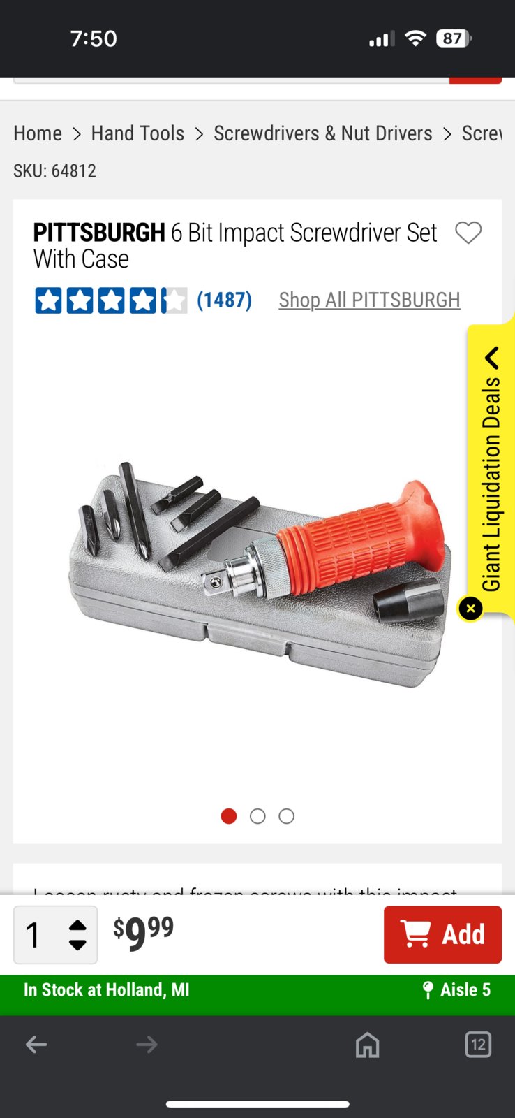

    PB blasted it many times. after torx bit started slipping and rounding the hole, I used an impact screwdriver, no go. Then dremel'd a slot in the head so I could use the biggest/beefiest slotted impact screwdriver tip. Bolt will not budge.

    Been a few new posts about this problem since I attempted install last fall and read hundreds of pages on this topic, so I do see there is no weld, its not reverse thread, and I had hammer tapped the T40 bit in first attempt, but that didnt work (hence the slipping after many tries and having to cut a flathead groove).
    Getting my A/T-D past the thick sheetmetal bulge/weld/painted foam may not be as difficult as it is to get this damn bolt out. Looks like I may have to drill the head off and use my bolt-out tools if soaking with PB a few more days and another try with an impact-screwdriver still won't work :/
