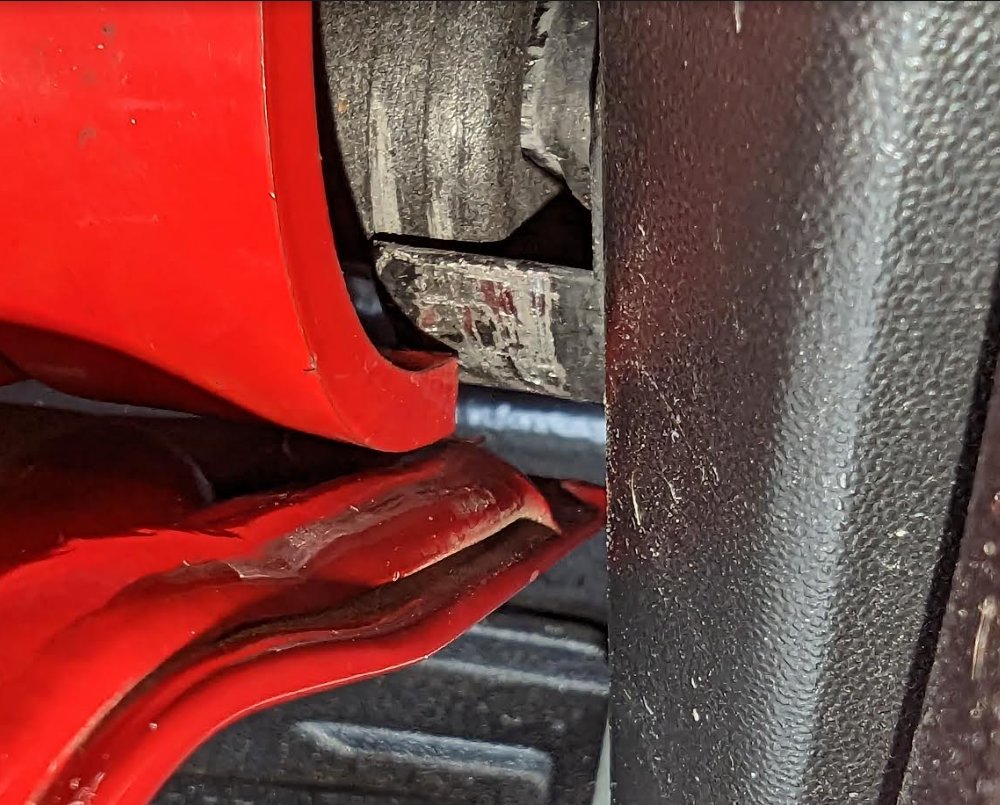

    Ah. Well only issue so far is that Toyota is sometimes overzealous with the foamy panel weld seams and left a thick foamy seam.
    Which I just went back down to and used a hammer to push the A/T-D onto the hinge, and ripped the foam a bit but now it fits.

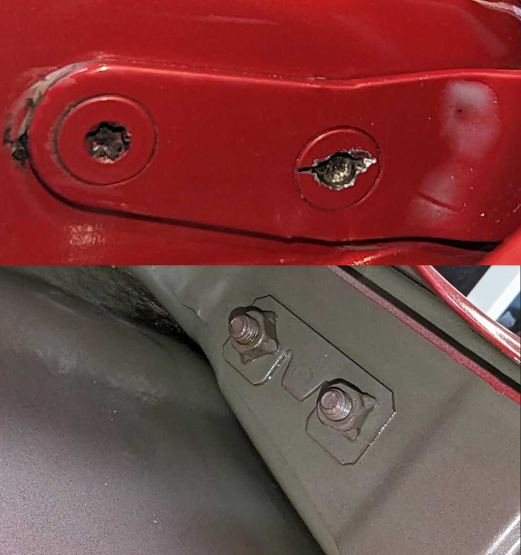

    Used the hammer to tap on a T40 bit to test the other bolt using only hand strength (no breaker bar) and that bolt also rounded out (not that it matters, just wanted to loosen one of the two and maybe I can spin the INNER double-nut-metal bar thingy) but that thing is stripped (meh who cares).
    So back to figuring out how in gods name to remove the main stripped bolt. Is drilling the head off, and then extracting the shaft out a reasonable thing to do? I was hoping that would be a last resort since I still do have a viable head to slot and impact screwdriver out. (or have a shop weld a shaft onto possibly?)

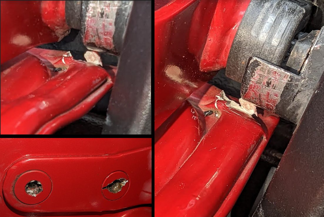

    Ok just spent all this time drilling, what a cluster that was.
    Had to drill way farther into the head than felt comfortable, but I finally saw a gap in the bolt/shaft connection.
    Problem is is that the nut on the backside is ONLY attached to a thin metal wing connecting to the 2nd nut, so the entire thing BENT the nut away from the mating surface, making drilling out the bolt very difficult. In the end I had to use a smaller drill and cut way deep into the shaft of the bolt, and then also use vice grips to twist the exposed end of the bolt out through the inside of the tailgate.
    I kept having to pound the double-washer-metal-thingy back into somewhat flat shape while drilling and extracting.
    Once the bolt was completely out, I had to bend it again, to try and get the new security bolt to catch and not crossthread. I got it pretty tight with blue loctite, but also decided to put a 2nd nut on the inside as a double measure to keep it in.
    And I also can confirm: there is no "security bolt with ridges/teeth on backside of bolt" from toyota. Its simply a flat surface on a conical head like all normal bolts. It is just on there VERY tight.
    But shes on there nice and tight, thanks everyone! Hopefully others who run into these issues can use my various struggles to their advantage :p

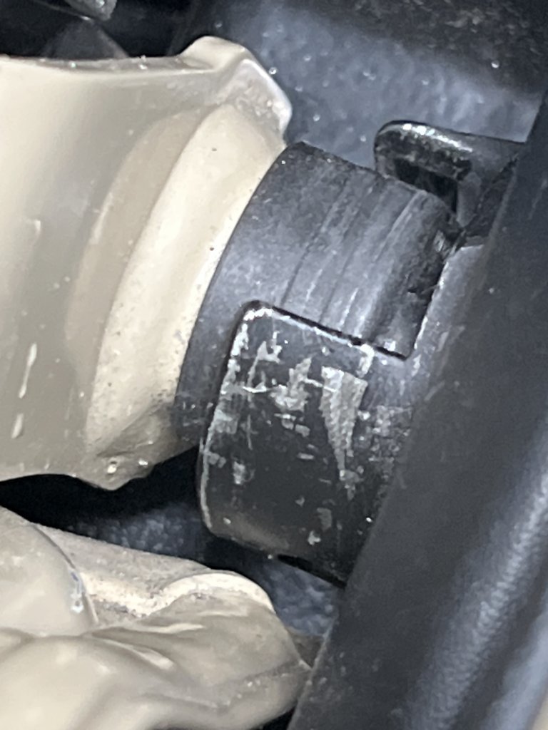

    Anyone else have trouble actually getting the metal piece to fit ? I got the bolt out but cannot slip the metal bracket under or behind it at all

    Yeah I had the same issue, the last page or two was suggestions on how to smash / melt the caulking down to let the metal slip in.
    I simply kept jabbing until the caulk gave way and chunked off and made room for the metal. It was tight, but i made it.

    I wouldn't really call it "damage", its just foamy caulk they globbed on too thick. I was paranoid of scratching the paint on the side of the tailgate (where no one can see it) but forcing the caulking foam out of the way wasn't even a 2nd thought to me. You'll NEVER see that bit, especially if you keep the metal plate on there. Maybe try the hot knife trick to melt it down a bit? or compress it more and more every day to squeeze the stuff out of the way over time?
