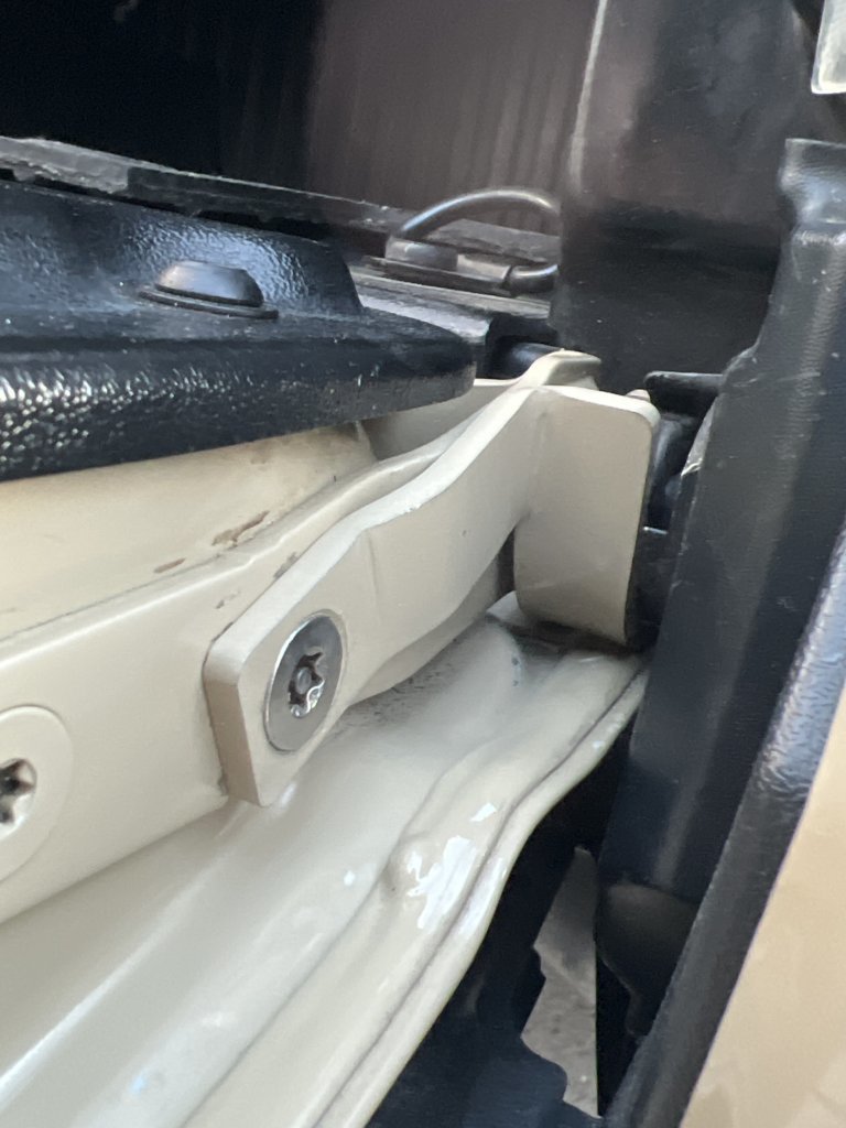

    image.jpgPerfect fit ! Thanks for the advice @Nords and @christian06
    It takes a little wiggling but amazing snug fit product paired with Loctite !

    Yessir nothing a little rotary tool can’t fix. I thought it was the pinch weld until I felt it. Thanks sir ! Great product added blue threadlocker
