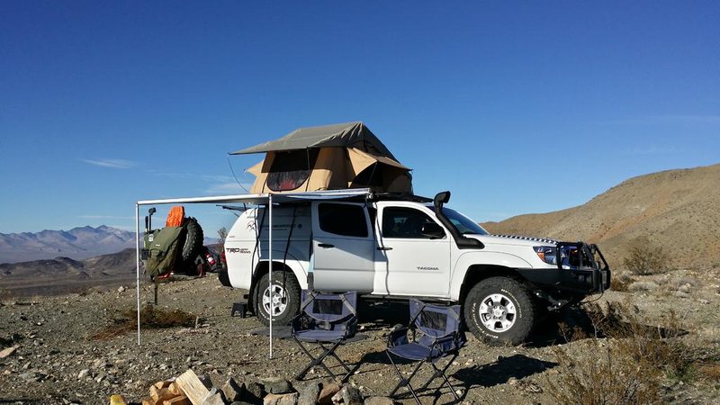

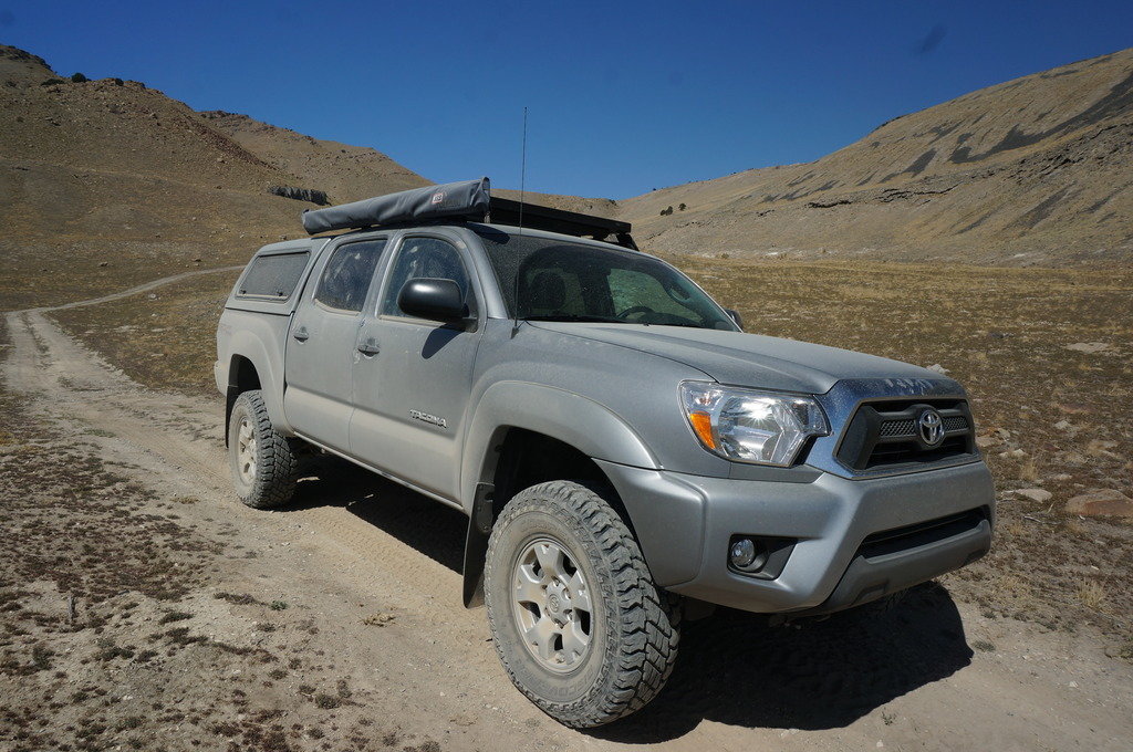

    Just a few
    Anyone mount one to the factory roof rack?

    CURRENT VEHICLE & EXPEDITION EQUIPMENT -ARB Old Man Emu Heavy Duty Suspension + AAL/Dakars - BFG Tires Mud Terrain KM2's, 255/85R16's -Wheels Toyota TRD Alloys -ARB Deluxe Bull Bar w/ARB fogs (Gen II) wired to OEM fog switch -Warn 9.5 XP winch -Rigid Industries E2 10” LED Combo Light Bar =Specter+Hyper-Spot+Driving -BAMF 80” 1.75’ .120 wall DOM bent, fully welded 2”x2” sq.tube rock sliders -CBIOffRoad Trail Ryder 2.0 Rear Bumper +Jerry Can Holder, fold up camp table, telescopic light. - Quick Fist Shovel and Fire Extinguisher mounts for rear bumper -BudBuilt 4 pc, Skid plates: Front, Mid, T-case, Cross member -Rear Diff breather extension -SnugPro Bed Cap, lined inside + Kargo Master 500lb rack -Cascadia Vehicle Tent Mt. Shasta + annex and floor -Outback Solutions 53” RD1355 drawers stacked w/ RDRF1355 roller floor driver side -Outback Solutions 41” RDRF1045 roller drawer w/ roller floor passenger side -ARB 50qt Fridge Freezer w/ tie down kit
    I have a Fiamma 35 Pro mounted to a Kargo Master roof rack that came with the snugpro cap. I had to mod it for the cvt. I mounted the awning with a couple of Fourtreks modular clamps. Works great.:cool:

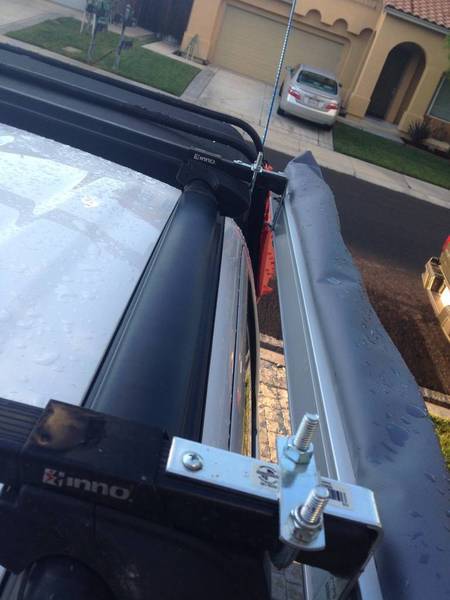

    I have the short 4' arb on my roof rack to go next to my tepui RTT on my bedrack. I mounted it with some L-brackets and tiny ubolts from the hardware store.

    Can you post some pictures of how you mounted it to the roof rack?

    Yeah. when I get home after work

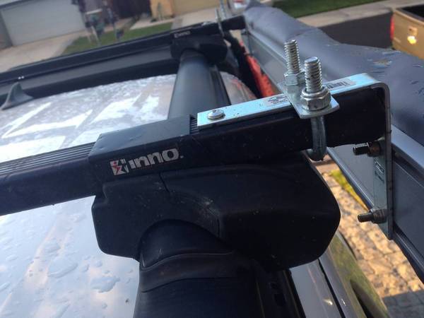

    Pictures of how I attached my awning for less than $3. Its on there solid too. Moves the whole truck if I try to shake it.

    Very nice and simple.

    Yep did some research and found arb brackets that were plastic for over 30 bucks plus shipping and I was like I can do better for less. Two half inch sheet metal screws. Two big L brakets for a $1 each and two small ubolts for a few cents
