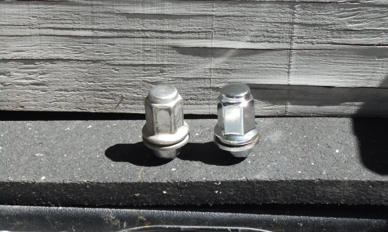

    Used Toyota # 90942-02082
    Then on eBay found:
    Under Head Length: 40 mm
    Thread Size: M12-1.50
    Also based on wheels if mags or steel found black lug nuts but you have to repaint them before using or they will start rusting in several months.
    I used the box they came in and stood them up and shot a few coats of Rustoleum satin black and let dry overnight before putting on. Good then.

    90942-02082! Awesome. I picked up some on my way home before seeing this. Thanks for the reassurance.
    Lug nuts? I went this direction; Amazon.com: MIKKUPPA M12x1.5 Lug Nuts Set of 24pcs Hex 13/16'' (21mm) Black OEM Factory Style Mag Seat Lug Nuts Replacement for Toyota Lexus Factory Wheels : Industrial & Scientific They should get the job done.

    I have used that brand several times.
    Every time i got really soft mushy nuts.
    I use TCP brand now.

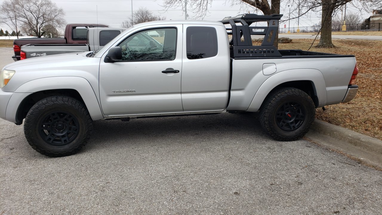

    The hub was fine. I was able to press in a new stud using the bosses press. Pulled out a set of wheels and tires I had sitting around.
    Wheels are 17" from a TRD 4runner and tires are 275/70. Yes. They rub a bit midway through a turn.
    Not to worry. I have a 3" lift coming.
