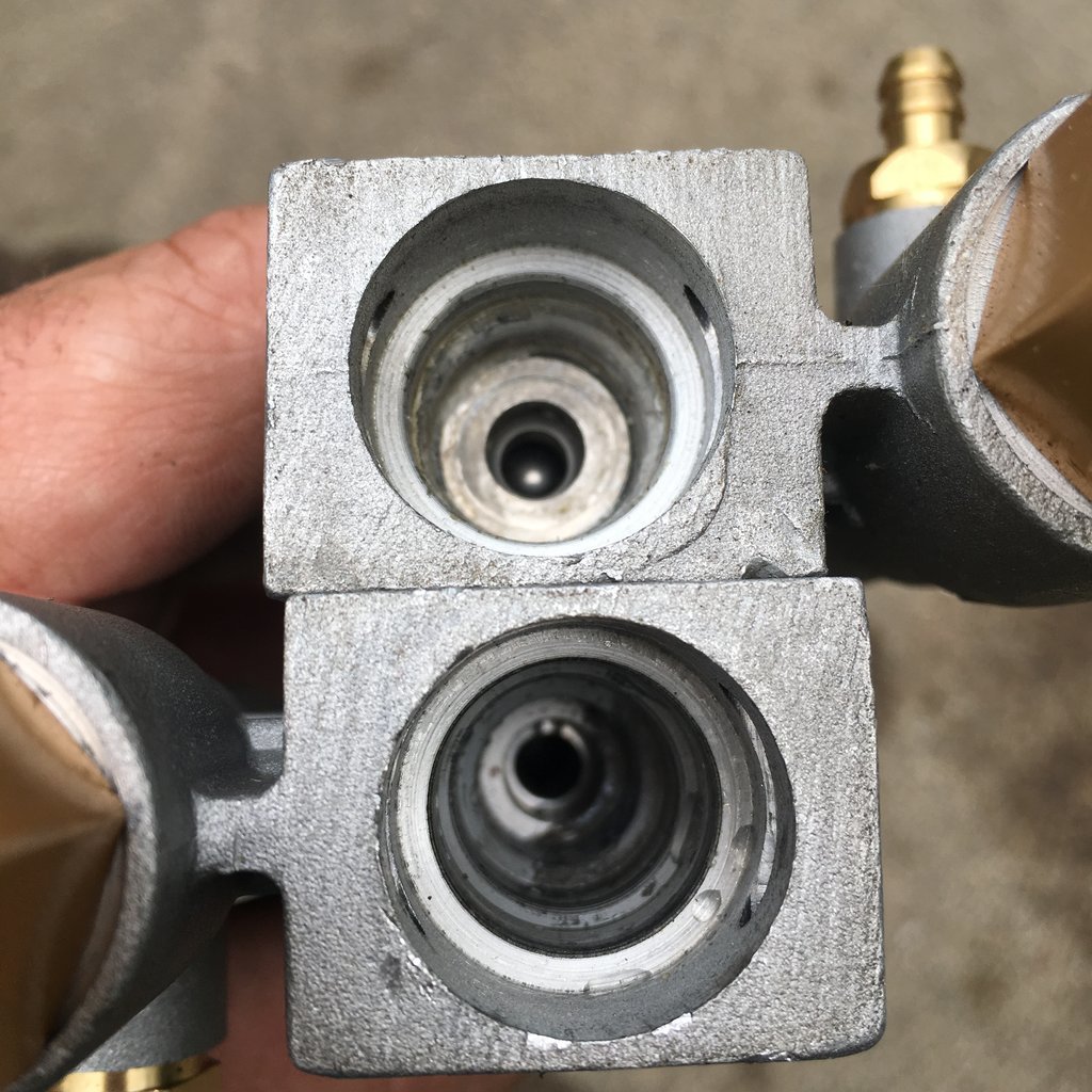

    Have a Homelite 2700 psi pressure washer with no pressure...
    Kind of stumped:
    Had a crack in the unloader valve housing, replaced entire unloader with new
    Thought I had bad check valves in the head, replaced the head, no check valve kit for this thing
    Pistons are pumping just fine
    Wand valve is good, no clogs
    Hose is good
    input water pressure good
    all seals are good
    one thing I have noticed, with garden hose attached and on, without motor running, water sputters out? Seems like I still have bad valves somewhere??

    Just posted this and immediately found out the problem when comparing my old unloader housing with the replacement.
    New one is missing a ball valve!!

    I will NOT be stumped! Stupid crazy mentality I have.
    Runs great now though
