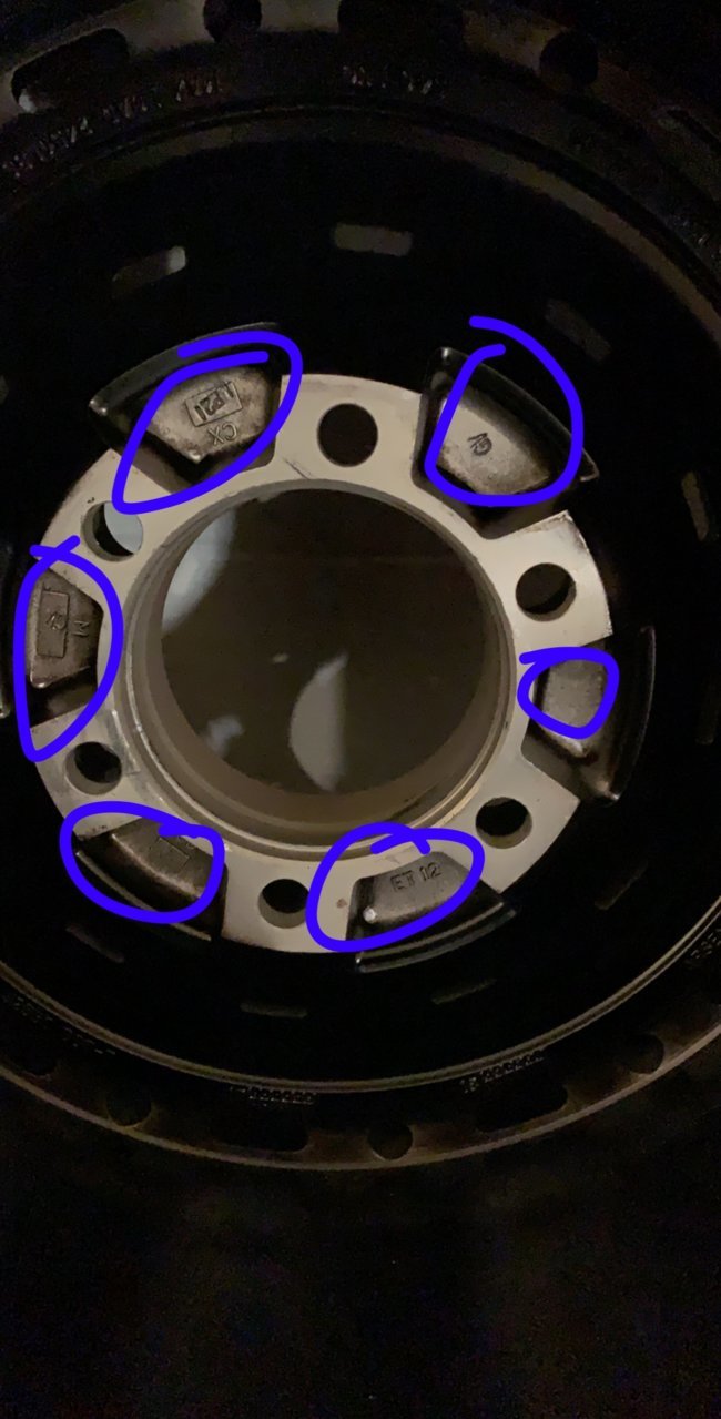

    18 DCLB SPORT CEMENT
    Just an FYI, with 3/4" spacers the factory studs stick out past spacers a bit. Check your wheels to see if they have pockets between stud holes (Factory wheels due) If your after market wheels don't, you will need to trim factory studs. Bora does make 1' spacers also.
  14. Mar 3, 2019 at 10:25 AM
    Sandytaco_2
    Sandytaco_2 [OP] Member
    Mar 2, 2019
    #285096
    7
    Brandon
    2019 Toyota Tacoma TRD Sport 6MT
    Not at the moment.
    Are you talking about these pockets?
    na8rboy likes this.
  15. Mar 3, 2019 at 10:28 AM
    JimmySport
    JimmySport Well-Known Member
    Mar 8, 2018
    #246730
    783
    yes

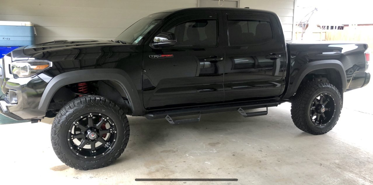

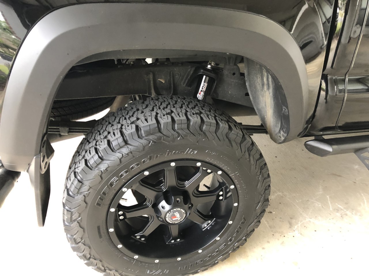

  16. Mar 9, 2019 at 1:44 PM
    #16
    Sandytaco_2
    Mar 2, 2019
    #285096
    7
    Brandon
    Not at the moment.

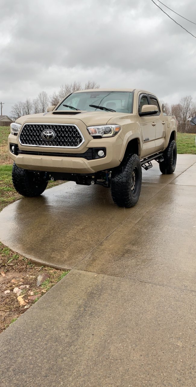

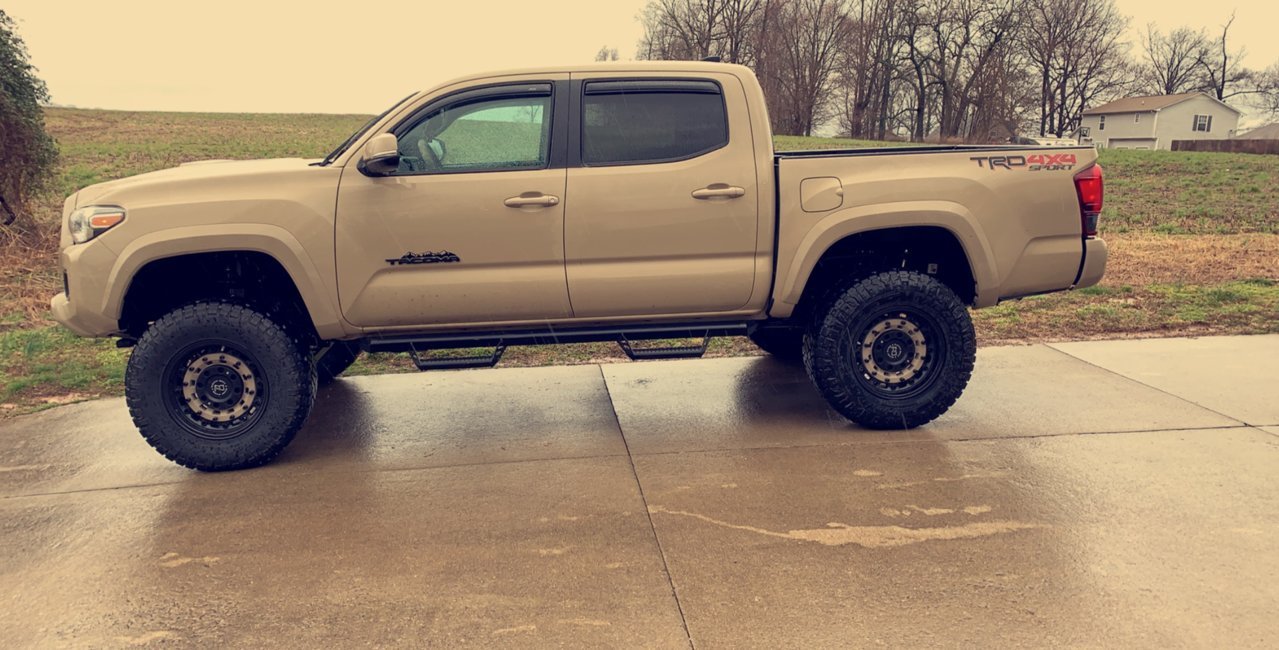

    73C5E1AB-D292-41E0-8356-09357DDB487E.jpg EBDDF601-3BA6-46EC-9CCB-40CC08EDAF1F.jpg
    Well I finally finished it up. 4” lift and decided to put 1.5” spacers on.

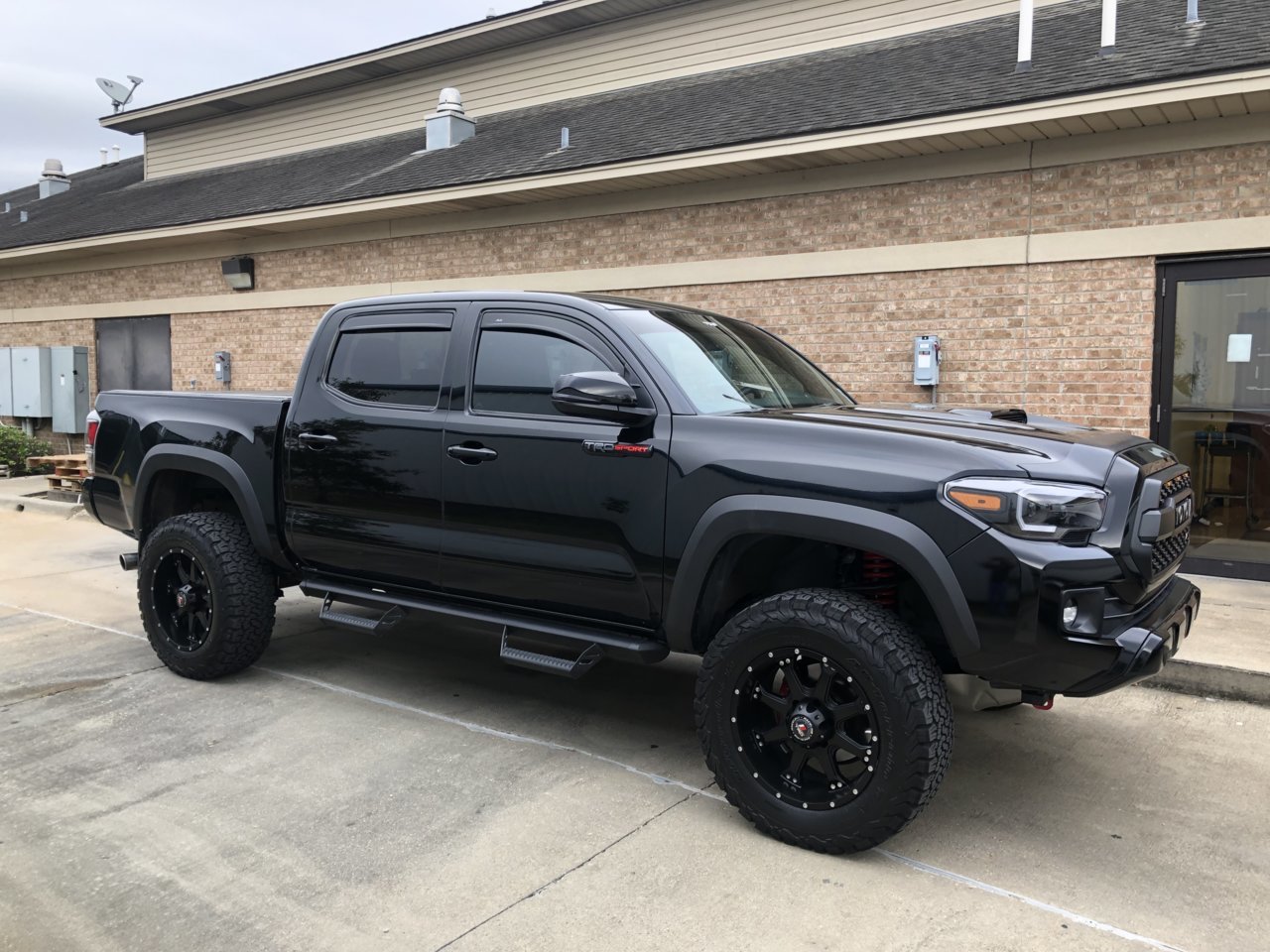

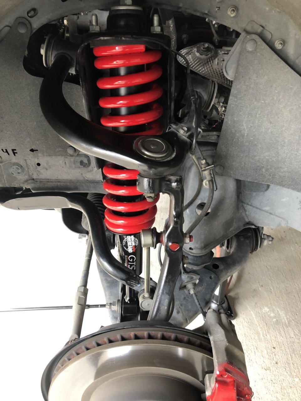

  17. Mar 9, 2019 at 4:51 PM
    #17
    PapaRee
    PapaRee Pro Tuner
    Oct 31, 2015
    #168275
    3,249
    Kreg
    Prairieville, Louisiana
    2016 Black TRD Sport, Tuned, BHLM OEM LEDs
    GTS Dobinson's lift, 33"-Wildpeak Atw3-18x9 -6 Offset ,265/70/18 tires, Raceline Assault wheels, Backflip G2 bed cover, Magnaflow exhaust, Pro tail lights, Pro fog lights, Pro grille, Raptor grille lights, Predator side steps, RedLine Hood Struts, Toyota bedmat, tinted windows, Retrofitted-BHLM-Amber Halo-Amber DRL-HID headlights, LED Highbeams, LED Hood Scoop lightbar, LED hidden bumper lightbar, LED under hood light, LED Bed lights, LED license plate lights, Tacoma tailgate 3d letters, Tacoma glovebox 3D letters, removed air dam, Custom TRD Sport emblems, Pro Shift Knob with Meso ECT Stealth button, Meso LED dome and map lights, Meso V3 smoked mirror turn signals, Meso Stage 2 Tail lights, Meso Mirror Puddle lights, Meso KC-5 Brake/Cargo light, Meso center console bucket with OG lid, Tailgate PNP kit, Garage door opener button in overhead console, Meso Minimalist keyfobs, Matte black Pro hood decal, KTJO4x4 Led door handle LED lights, Pioneer 6x9 3 way front speakers, Rockford Fosgate 6.75' rear speakers, TacoTunes tweeters, AJT black vent rings, JDM Gas cap cover.
    Congrats! Looks great!:thumbsup:
    I installed a new suspension on mine Thursday. It’s 2.5” in front and 2” in rear.
    1.25” spacers.
