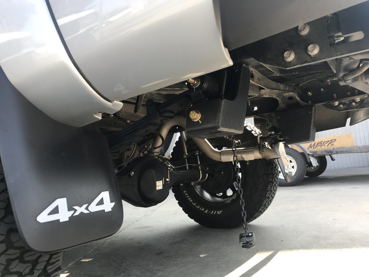

    You know when you have to drive over a boulder, a log or come down off a steep bank? This allows you to keep the right rear wheel on top of it without fear of hitting the pipe behind the rear tire when you roll down behind it. Gives you more offroad clearance and since you cant see it from behind, it makes you look more like a Chevy Volt. :bananadance:

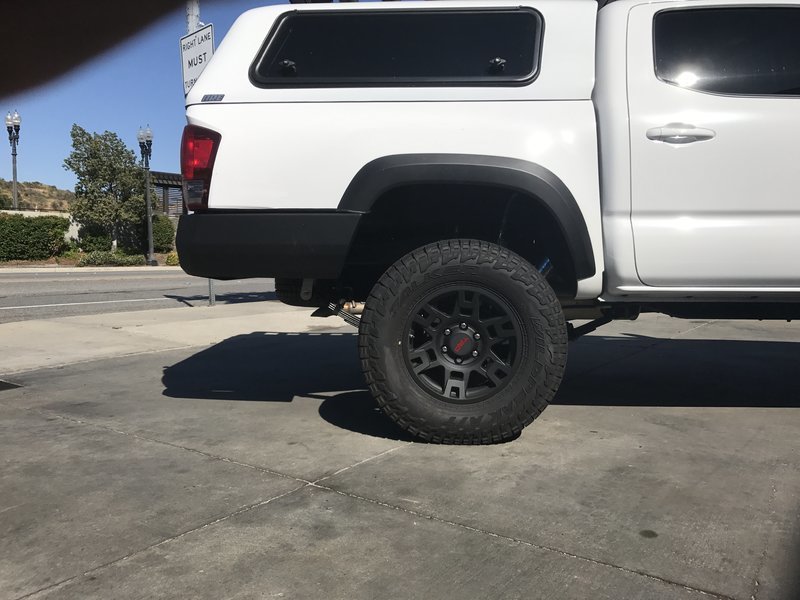

    Mine looks exactly like this and the others.
    I’m not as cool as this guy. It’s cold and already dark outside but I assure you they are identical.

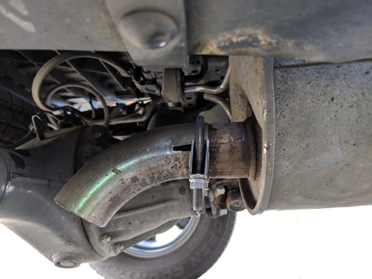

    Yep. That's where I was.
    Here is the shit version:
    5.5in long. Need better!

    Yikes! Did that come with a turbo sound whistle? :rofl:JK.
    Try the 2-3/8” diameter size, it fits really well. :thumbsup:

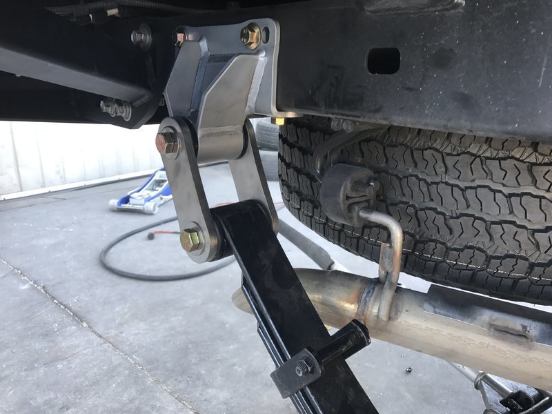

    Every time I do a rear suspension that causes the leaf spring shackles to hit the exhaust I cut the tailpipe and use it as a turndown

    Nice recycling of the pipe - I can’t weld so I used a off the shelf one to do the same thing. Yours looks great!

    Whistle Tips! Goals, baby, GOALS!
    Agreed. They only had 2.5in in a turn down. I'm going to stop by a shop tomorrow afternoon.
    Being a glorified welder and all. :D
    Nice work though!

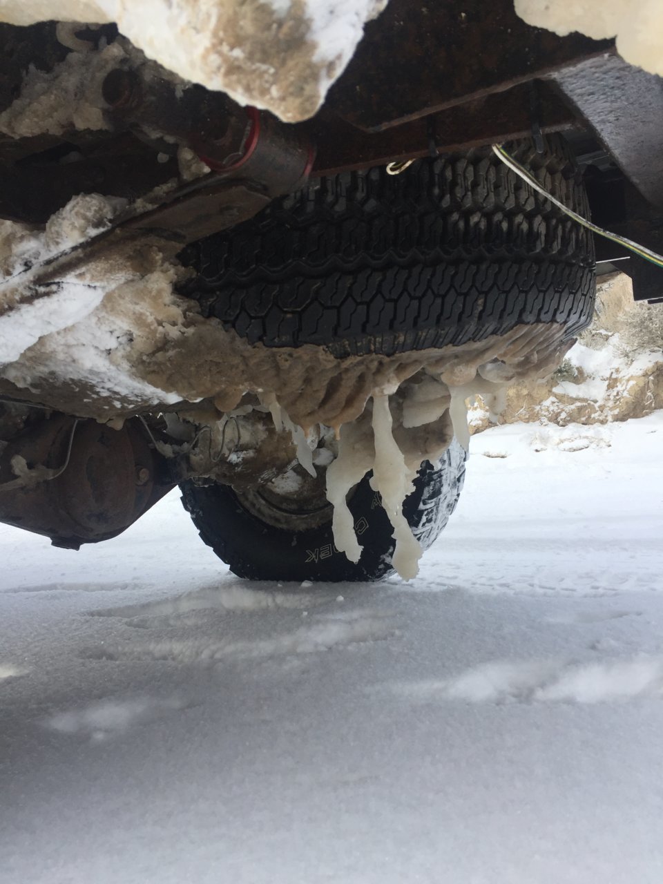

    What am I seeing other than fucked brake lines? :eek:
