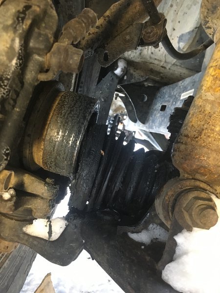

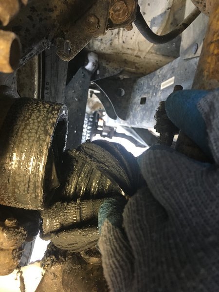

    So the front wheel drive went out, and I went underneath to take a look at what could possibly be wrong and this is what greeted me…
    I replaced this axle in the summer of 2013, and I have put approximately 100,000 miles on the truck since then. Is there anyone out there that sees this often enough to know if this is the "normal" place for an axle to break, or is this unusual?
    Dothe photographs that I have (hopefully) posted shed any light on it's cause? Are there complications I cannot see from here?
    All help is ABSOLUTELY appreciated…

    You lost the bearing cage and the bearings. It happens.

    It happens. When you replaced it last time did you get Toyota OEM CV's or something generic? And is the truck lifted? Don't cheap out on parts for lifted trucks

    Had a blown boot on that axle for a while?

    Where you using it when it grenaded?

    Yeah, I live in Alaska and I drive outside every summer so I put a lot of miles on my vehicle. Mostly highway miles.
    Hard to say when it "grenaded", it wasn't momentous or anything.
    The truck has had its suspension replaced with OME all-round, but nothing that in my mind qualifies as a "lift kit."
    And no, I think I just went down to Napa auto parts and bought one down there. I did not go through the stealership
    Does it look to you guys like just a simple straightforward axle swap? Because it wasn't especially complicated a few years ago, now it's just considerably colder. And I really don't want to have to do it outside…
