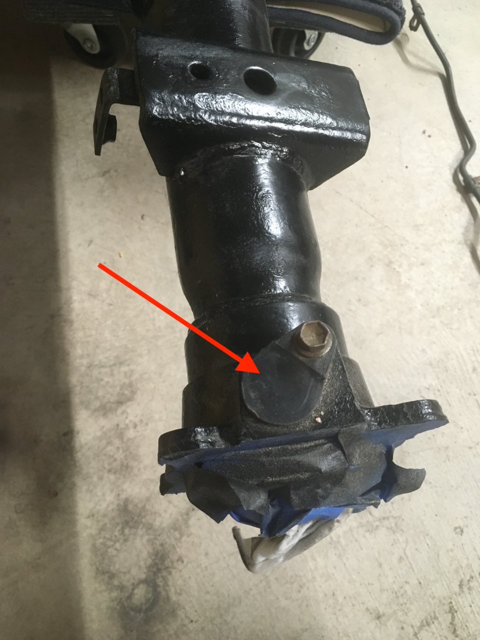

    8.4" axles come in ABS and non-ABS versions. All 8.0" axles are ABS-compatible, but some have the ABS sensors capped off (because the truck wasn't equipped with ABS). This is a capped ABS port:
    This is a capped ABS port: upload_2022-5-14_19-44-50.jpg
    Depending on the year, some trucks have the parking brake routed above the leaf springs and others have it routed below the leaf springs. I'm not sure why it changed or if one is better than the other, but if you can, grab the parking brake linkages up to the adjustment bracket (which is under the truck, approximately under the driver's seat) to be sure you have anything you might need.
