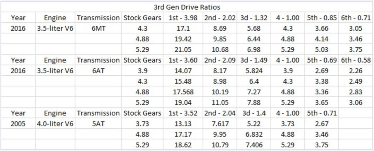

    Why do you suppose they use 4.3 gears in the manual as opposed to 3.9 in the auto?
    Do they think us poor saps driving need help with the lower gear to get rolling?

    Nov 21, 2015
    #170338
    23,440
    Iowa
    Because the ratios in the trans are different
    I’ll take the MT gearing every day of the week.

    Ahhh.......so they're aiming for the same final drive ratio on both the manual and auto?
    Am I thinking about this right?

    23,440
    Iowa
    Good theory but no. The final drives are vastly different. That’s why the MT is fun to drive and the auto is a dysfunctional mess

    2021 Tacoma TRD OR DCSB 3.5
    They aren't though. MT's run substantially higher RPM at speed. I want to say closer to 2300 rpm at 70mph 6th gear. Auto is right around 2000 rpm at 70mph 6th gear.

    Manual Mall Crawler
    It isn't uncommon for the gear ratio of a manual equipped vehicle to have a lower ratio than it's auto equipped counterpart. The torque converter in the automatic acts as a 2:1 gear multiplier when unlocked and maximum stall. This helps with off the line acceleration.

    2016 TRD OR DCSB
    C4Fab LoPro, BAMF Sliders, Ext ADS 2.5’s, 4.88's, OVTune (OG to KDMax)

    Baltimore, MD
    '14 MGM DCSB Postrunner 4wd Conversion, Debadged
