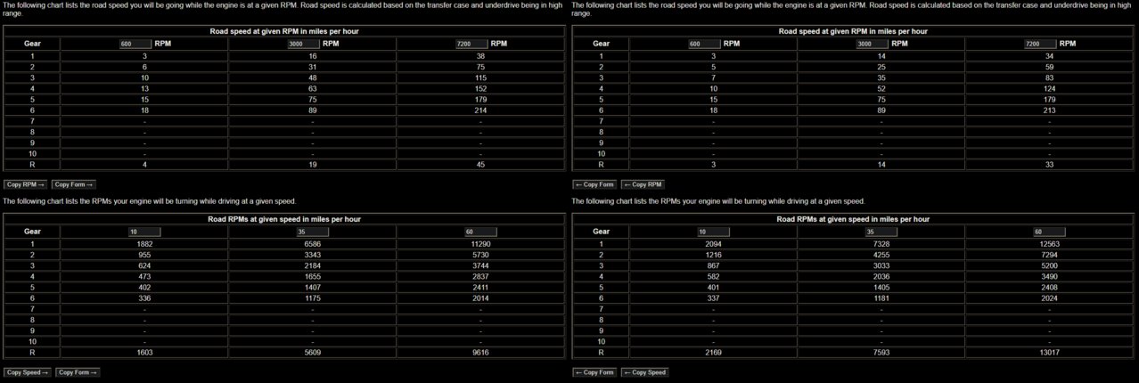

    Sorry about that.
    5.29 is the most reasonable regear ratio for the 3rd Gen ATs. Typical regear ratios are 4.30, 4.56, 4.88, and 5.29. Just with the crazy AT ratios mismatched with the 3.909 stock gearing, 5.29 is about the only choice, esp now that the vendors have proven the strength on thousands of heavy rigs.
    Yes, though. At 60mph, a Stock MT and an AT with 5.29s are turning nearly identical revs in 6th gear, along with great improvements in all of the other gears. This is from http://www.grimmjeeper.com/gears.html :
    The only difference is that both the MT (left) and AT (right) are sized for 265/70R17 / 32in tires, not the Stock 265/65R17 / 30.5in tires. 2k at 60mph feels just right to me.
    The gearing is from the link in my signature.

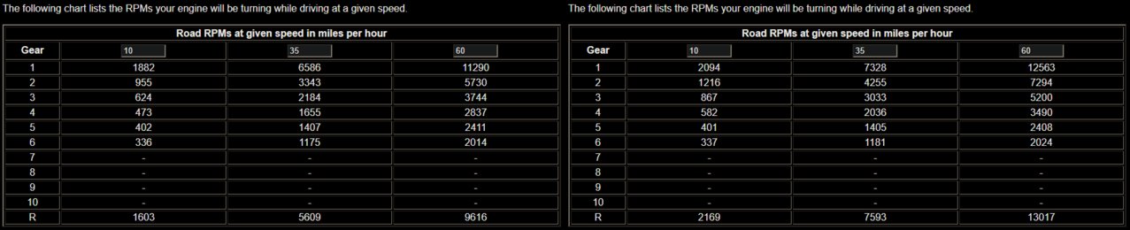

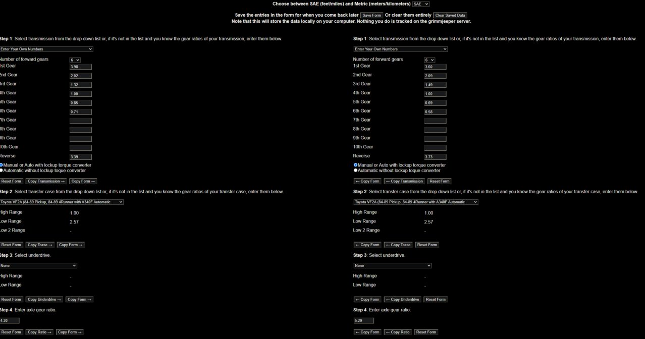

    I don’t see how this could be correct, given that per the tables I posted above show a 6th gear ratio of 0.71 for the manual and 0.58 for the V6 auto, with both having 5.29 differentials. Seems that 6th gear in the manual (0.71) and the 5th gear in the V6 auto (0.69) would be closer to the same rpm/speed if both have a 5.29 diff. (Note that the stock OEM differentials for auto V6 and Manual are different in the tables so doesn’t apply to stock diffs).[/QUOTE]
    Those same ratios are linked in my signature.
    From my grimjeeper form:
    From all of that, I'm not sure what the issue is:

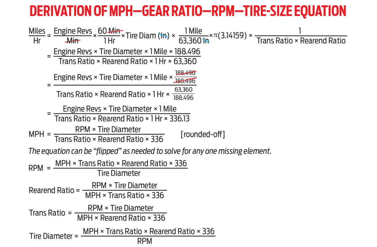

    Ah, so you were comparing 6th gear in a stock MT with a stock 4.30 differential to a V6 auto with a 5.29 differential? It was the way you worded it, sounded like you were saying both with 5.29 differentials that threw me. It’s an interesting comparison!
    I like seeing the math behind spreadsheet formulas, this one shows how it’s derived (so if you want to be more accurate use 336.13 in the equation since it’s rounded below):
