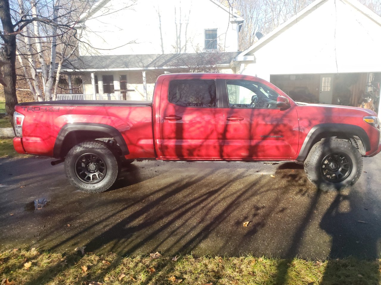

    I do think that the long bed has a higher gear ratio because my truck, which is a 2021 long bed does not gear hunt and will hold 6th gear unless I come to a decent size hill. At 75, I am running about 1900 rpm. I wanted to also share a photo of my new wheels and tires. The wheel are RRW 's and the tires are the Hankook Dynapro at2 Xtreme. They are 17"20221102_160054.jpg
