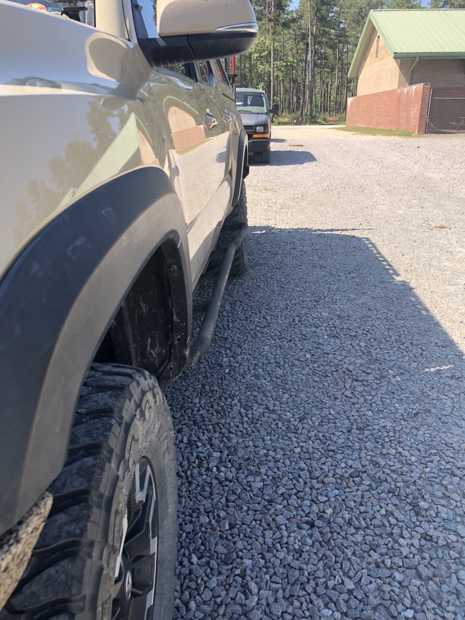

    something doesn’t look right any help would be much appreciated.

    Maybe the bed is crooked?

    Talking about your rear end right? Sometimes the bed is misaligned. Can you take a pic from the rear?

    Measure the bed to frame on both sides. Like others above mentioned, it may be off.

    I think I saw your post on the insta. It doesn’t look like the passenger side looks like it has negative camber. It could be the angle the picture was taken from though
    If you have a level handy I’d hold it against the face of the wheel to see if it’s actually “camber” (in quotes because the camber wouldn’t be by choice) or not. If the wheel isn’t vertical according to the level then something is probably damaged/loose.

    Post pictures of both sides.

    Would like to see pics of both sides please. Thanks.
