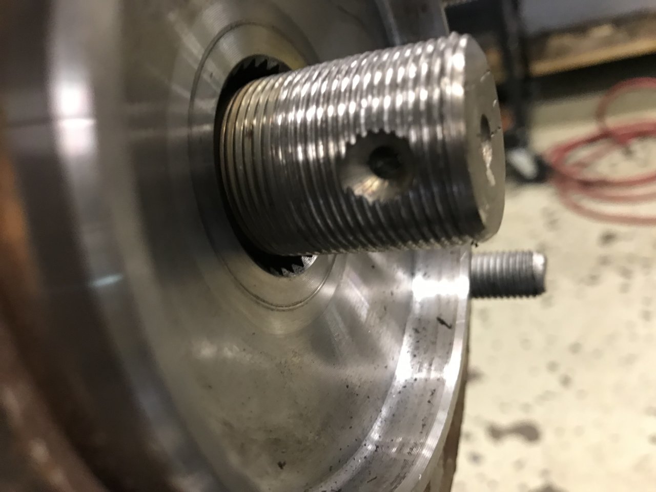

    Good news, the axle seems to be fine. The nut not so much. I’m chasing the axle with a thread file in the correct 1.5 pitch and it seems ok. I’m putting a new nut on.

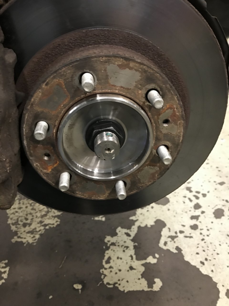

    Thanks for everyone’s help and advice, the job has been done correctly. I was able to tighten the new nut with just a hand powered wrench, no pneumatics this time.

    Just visually those axle threads look too small and rounded for my taste.

    I’ll check on it in a few days when I’m changing out the inner tie rod. It actually snugged up more this time than last time. The pictures don’t show a good detail but the threads were sharp to the touch.
