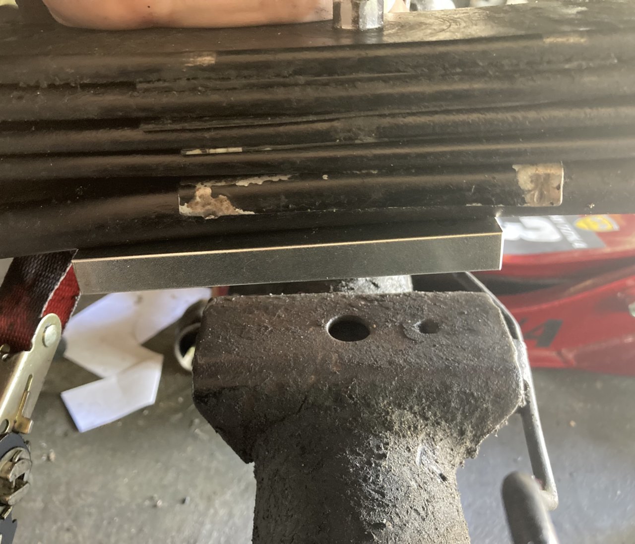

    Has anyone installed axle relocation plates with the stock overload leaf?
    Or even if not, does where the plates will end up setting at the curve of the leaf look ok?
    Seems to me that when I go to tighten everything down, that’ll tweak the leaf up in the front.
    It has been suggested to remove that leaf & add one or two more. Not necessarily for this purpose. Just in general. Have I listened? Well, yes. Just a little stubborn at times, I guess….

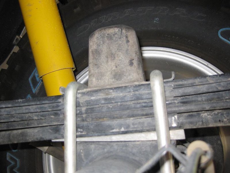

    Why do you have a "block", and how is it a "stock overleaf". That implies you are just messing with a completely stock leaf pack.
    It's only if you lift the rear that you'll want to address angling a tad and that's where shims come into play.
    That block, or relocation bracket, is just a bad idea and useless. Seems like a way to put a band aid to make up for something else that's causing issue. But you said stock leaf pack so idk?

    The axle can move back and forth, but settles in place where it needs to when using the appropriate length leaf pack.
    The leaf pack will sit on the axle with the use of the locating pin and it all gets bolted up with u-bolts.
    Again the OP said stock (but stock overload, unsure what that means) so unless the wrong rear shackle was used or the incorrect leaf pack, everything should be kosher.
    However, if a lift was installed in the rear that's where a shim can be used.

    Right. But shims won’t get the axle back where it was. My dif is angled up right now. I thought maybe shimming it to angle it down would get the wheels centered (slip yoke back in place). I called Tom Woods & was told no. Shims would only adjust the axle angle.
